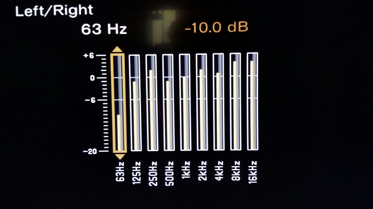

I spent some real quality time the last few days going through all of my settings and experimenting with different crossovers and DSP modes. When I'm at 120 hz you can definitely feel a little but more bass, but things get a little muddy in the mid to high range. To me it almost sounds like putting a blanket over my speakers. I've determined that at 80 hz I'm still getting plenty of bass and a little bit more clarity.
*Edit: I also found out that for whatever reason Audyssey is trimming the 63 hz band by 10 dB! No wonder my towers sound anemic when I shut the subs down! What would be causing that?

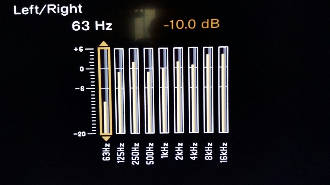

When I turn Audyssey off and go to Graphic EQ I can "Curve Copy" what Audyssey did, pic below...
That's not me. Audyssey keeps cutting that 63 hz band by 10 dB and it does not sound right. I can manually turn it up with GEQ but that's defeating Audyssey and I do like what DEQ does for my bass...
*Edit: I should mention that this is only a problem when I want to play my towers full range with Audyssey ON. Having the mini for my subs let's me bypass that.
PENG
Does your REW plot show a dip at 63 Hz if you sweep with the 2 mains and subs all running? If not, then Audyssey is doing its job, but it does not mean you will like the effect.

I see a huge dip at 60 hz. I'll keep digging and see if I can find one after Audyssey and before dsp...

There it is...
That's after Audyssey and possibly even after I did some more tweaking with the Mini because you can see that dip get smaller as I raise the crossover.
