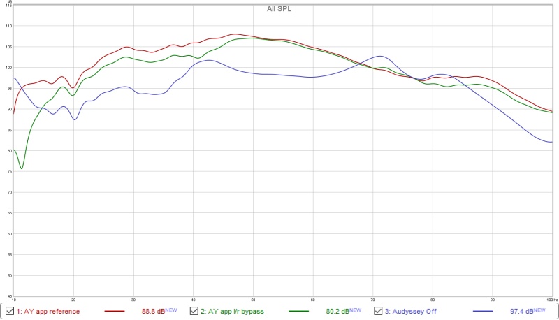

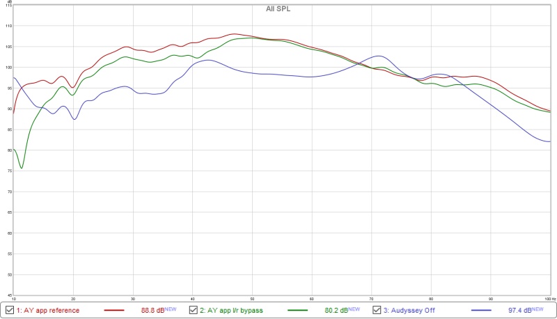

Here ya go. Audyssey seems to be drastically rolling off under 20hz and I can't figure out how to turn it off. In fact, the curve below never changes no matter what I do to the curve in the app. Kinda pointless if it doesn't do anything.
My mains are rated at 35hz-20khz, but I have no idea what they're actually capable of outputting.
I did Aydyssey app reference, L/R Bypass, and Audyssey off.

So those are mains (L+R)+Suboofer(s),but what did you set the XO to? Did you try plotting it using higher XO, such as 90 Hz?
It looks to me your mains and subs have usage output bu may not be capable to output much more than 95 dB from you main mic position. That's why I suggested you try running REW at lower level, say 75 to 85 dB to see if the response would become flatter.
You can see that Audyssey did improve things though, even in bypass.
The dip that you are seeing at near and below 20 Hz may not be due to the App roll off, unless you are still missing the latest update. It could simply be, as I mentioned earlier, the speakers and sub(s) have reached their limit. Audyssey can give it a boost (not much if due to room mode) but is limited to 9 dB maximum and if you compare the red and the blue, it does look Audyssey has given it the best it could do already.

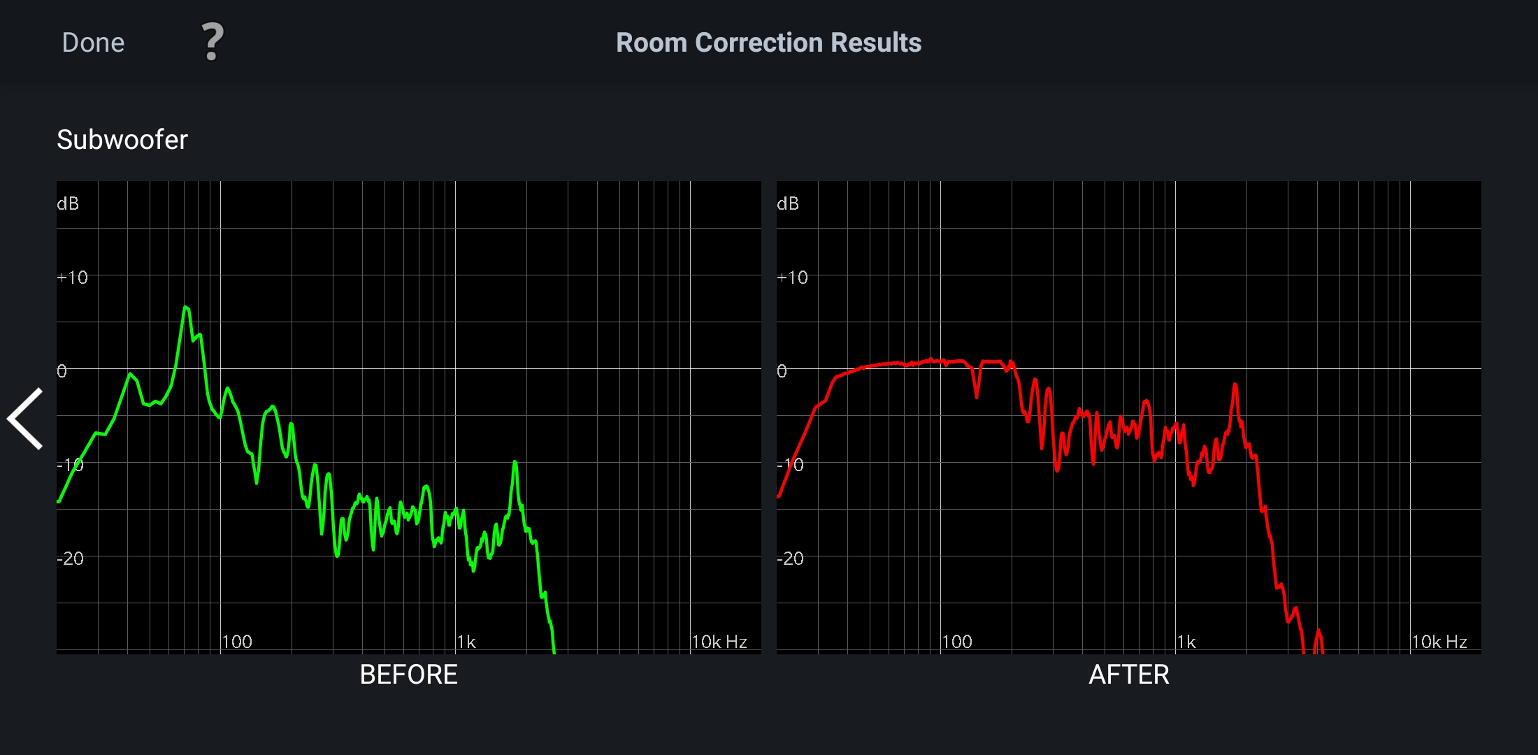

Below are screenshots of my App's subwoofer EQ before and after the update that removed the 20 Hz roll off.

Below are screenshots of my App's subwoofer EQ before and after the update that removed the 20 Hz roll off.View attachment 29303View attachment 29304

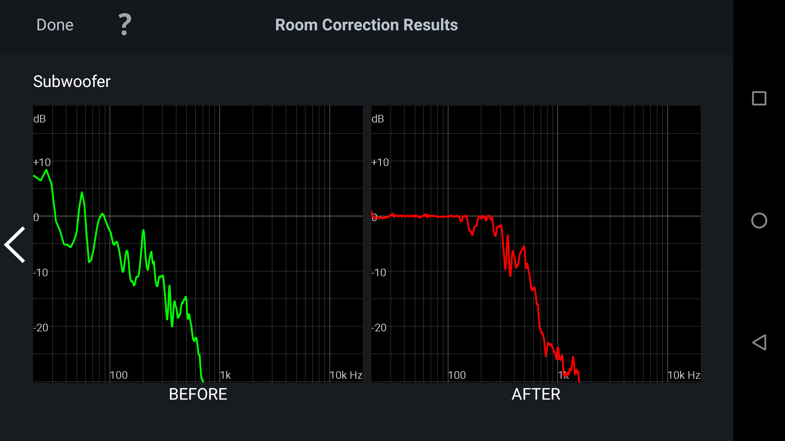

I have the latest version, but I'm wondering if yours is iOS with mine being Android. 1.4.0

That explains most (if not all) of what we are seeing, sealed sub tend to have less output in the lowest octaves. It is not a problem for people like me who watch movies at 70-75 dB or 80 dB average max.
Nope, mine is Android as well, mult EQ Version 1.4.0 So you do have the latest version, the roll off you are getting is clearly not because of Audyssey, but the limitation of your sealed sub. Again, that should have little or negligible effects if you stay 10 dB or more below reference, and assuming the up to 9 dB boost by Audyssey would not increase THD in the approx.13-65 Hz range, to the level it becomes noticeable.
I figured as much. Thanks for taking a look. I'll tweak it more when the other subs are installed, but I'm not surprised that under 20hz has low output considering the drivers I'm using.

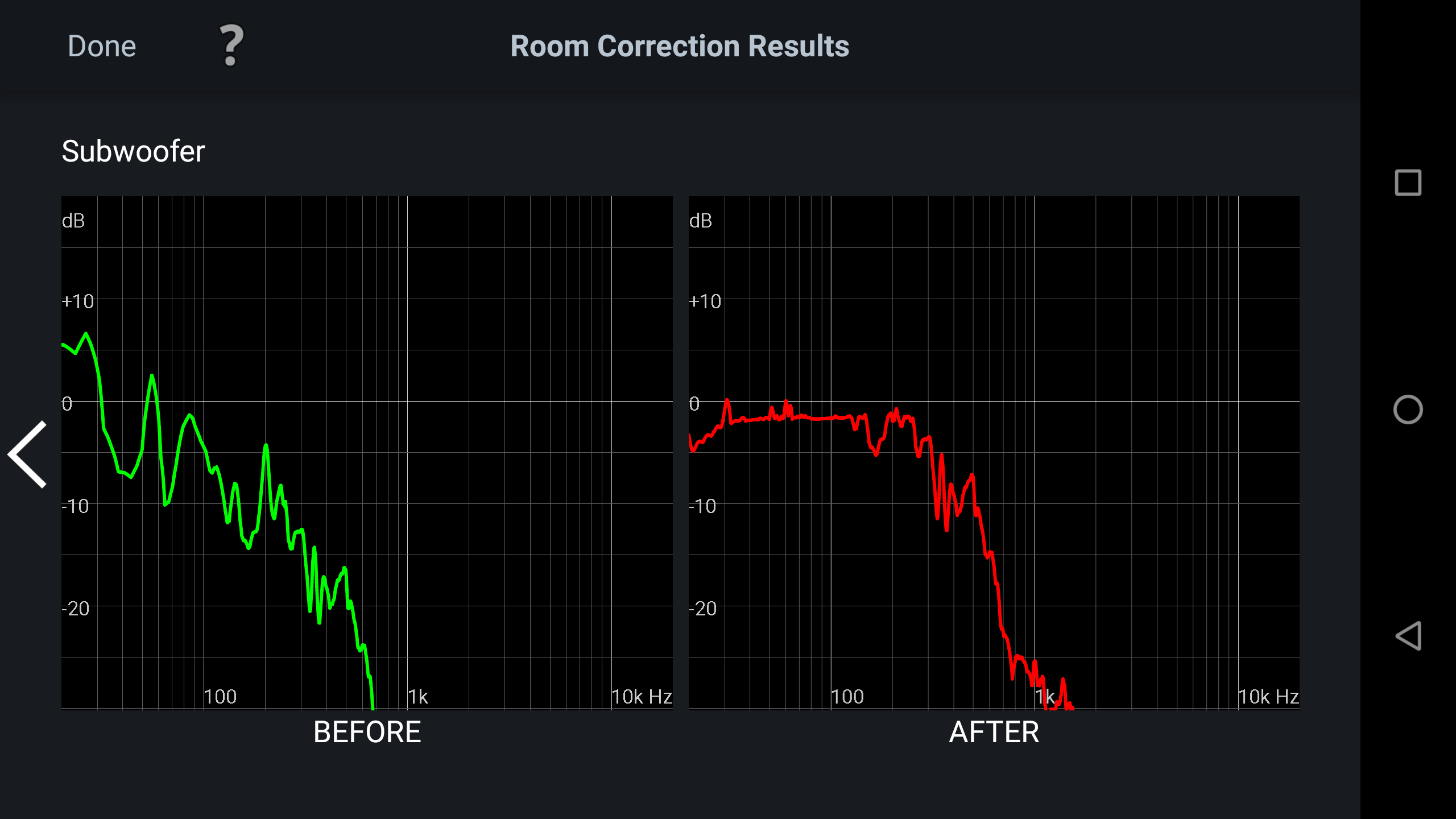

For the life of me I can't figure out how to modify the target curve to stop the roll off for my sub. What am I missing?

Well since that is a “target”, I am wondering if audyssey knows from pinging them, that they’re not capable below “X”hz. Therefore it wound target that low. I did ask a while back if they were sealed. I guess that’s true. It to mention being car drivers, the FS is probably around 30hz. How did you model the box?

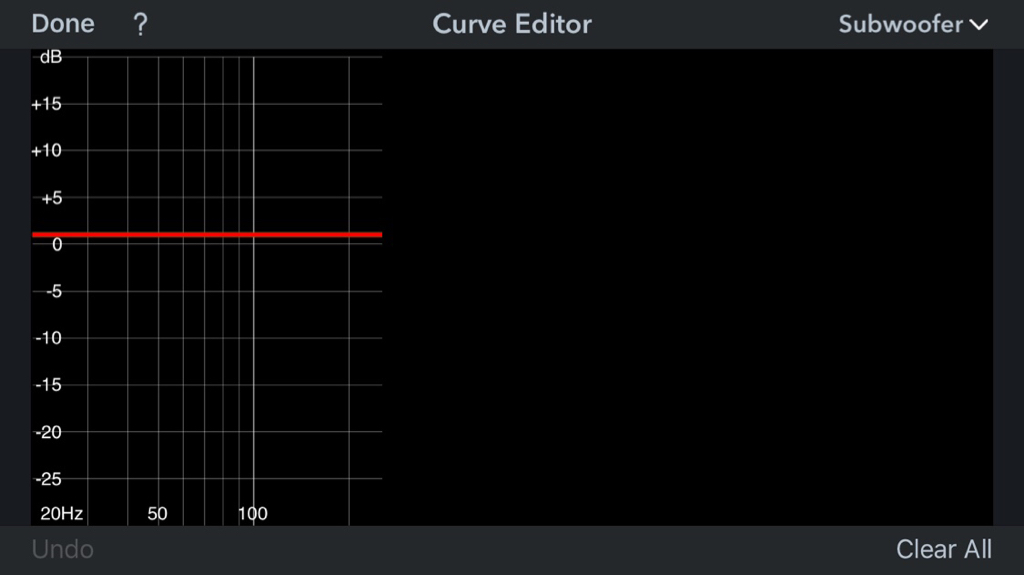

If the Audyssey App is intending the target curve to be flat, which is what it shows on mine when I enter the curve editor for the subs, I would expect the same for everybody else, too. Afterall is is their ideal... not what actually IS.
@panteragstk , seems silly, but have you tried, deleting and re-installing the app? Perhaps somehow its still operating under the old pre-update code which includes that rolloff. ??? Just a thought.

(Native curve in my app)
