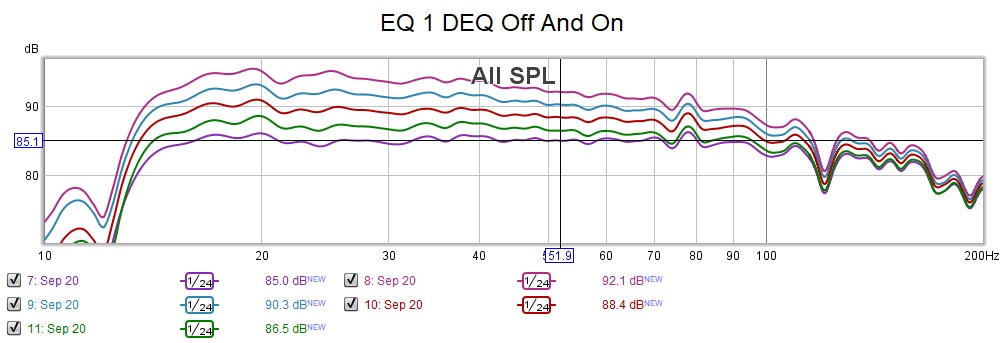

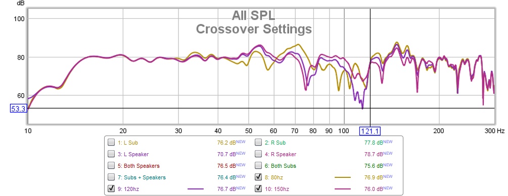

Look pretty neutral to me!
Those are both with the mini. I thought the top one was just Audyssey but I'm mistaken. I think it's time for me to bust out the gear again and experiment a little. I haven't really played with the app again since I repurchased it. My Mini might be facing obsolescence like yours...
