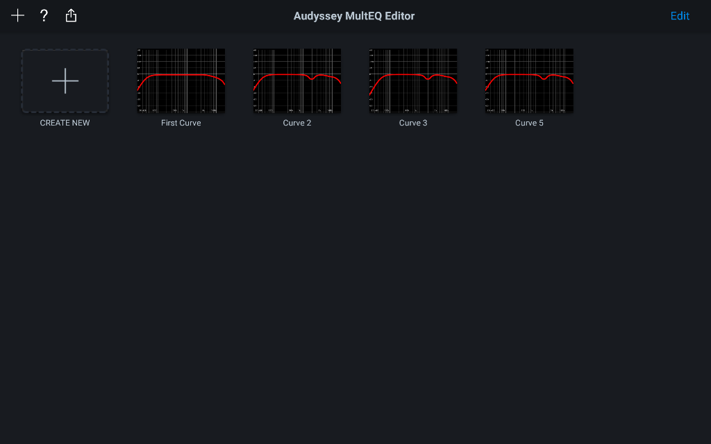

I just ran Audyssey through the app editor (after already having run it on setup o_O) and there were some hiccups, both by me and the app itself. However, after some minor frustration and rebooting once or twice I got it done and got some pretty good screenies of my measurements.
Since I am a total newb when it comes to eq and room correction I'm hoping you guys can take a look at what I have so I can get some insight and maybe even suggestions. I don't have a mic and haven't downloaded REW so I'm assuming tweaking it now might not work out so well.
I might have to put all these in a couple of posts. Here goes...

The hiccups. Of course it had trouble finding the receiver. One time "try again" worked and the second time I rebooted my tablet and the receiver. After I did that it found the SR6011 pretty quick and I connected it up. One time the stupid bird clock we have tweeted 8 o'clock at me in the middle of a measurement. I hit cancel like I would with the remote and instead of taking me back a step it made me start from the beginning. It was the 7th measurement too. :mad:
So it was a little buggy at first and me making stupid mistakes forcing me to start over didn't help much either.
I haven't messed with anything as far as editing goes, but it looks like it's fun!
*Edit: It looks like my room is a complete mess before eq'ing if I'm reading the before and after correctly. My bass is unquestionably better than before. This is nice!

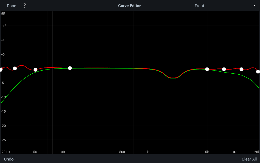

**Edit: What's up with the dip at ~2500hz? Is that intentional?

I'd not put much into the graphic pictures provided....get your own mic and REW if you want to really take and record measurements. Audyssey graphic representations simply aren't accurate measurements to go by....IMO.

You can't do much about the dips other than changing placement to minimize them. It is the peaks that you need to be more concerned about. Even placing a few inches to say the left or the right can make a significant change in having less peaks and dips. I agree it is best to get a CSL UMik 1 and a miniDSP HD if you really want to measure your frequency response. It is the response below 200 hz that is usually the most problematic. :):):)

As HD and Phil said, you need to get that Umik Mic and REW quick if you want to have more fun and satisfaction, and focus more on 200 Hz and below. If REW shows a dip in the mid range (around 2K), I believe the App allows you to disable the mid range compensation. After that run REW again to see if the dip gets better. You may prefer to keep the dip (Audyssey thinks a lot of people need that dip), or you may think it makes no difference, or you may prefer no such dip.
I am quite sure REW will confirm Audyssey in fact work well in the 20-200 Hz range, but it is likely that, guided by REW, you will want to take advantage of the App to do some editing for even smoothing response.
It seems to me a lot of people don't like to see Audyssey setting their subs a few dB below the mains, but Audyssey aims for flat response in the bass region so it is just doing the job it's design to do. I like it flat, but for movies even me, I had to manually increase the sub levels by 2 to 3 dB.

I'm just goofing around and haven't uploaded this yet. Why wouldn't a guy tweak the curve to make it flatter?
Green is the original curve. Red is my adjustment (probably blindingly obvious :p). I'm sure there's a good reason for it. Protecting speakers, amp or a perception thing? Like I said, I'm just goofing with it.

Midrange compensation. You can turn it off by speaker curve in the app. I did. It appears to be a preset 4dB, low Q dip centered at 2k. Not really sure what its purpose is, but I want it flat.
Edit: Article from the man himself is here: https://audyssey.zendesk.com/hc/en-us/articles/212347863-Midrange-Compensation
I may have to try it with and without this dip.
I did turn the compensation off and I had trouble telling the difference. It's hard to tell because it's not a quick switch back and forth between the 2.
