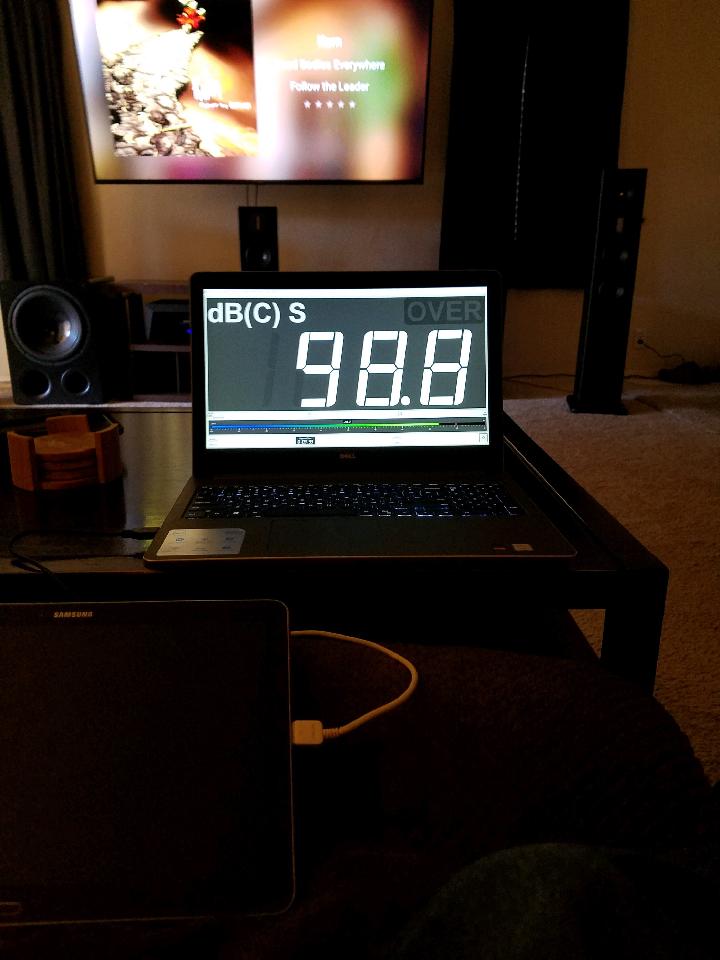

How long were they playing at volume before the mid fried? This measurement was taken using a calibrated mic at my seat, 15 feet from the front stage.
That was really, really loud. Unsafe loud, but not for more than a song or 2. Even at that I was a little nervous because the drivers were getting ready to hop out of the cabinet. This is the video I made to show Dave. My built in mic and recording skills aren't too great so you might wanna turn it down because it sounds like crap, but you can see how much my drivers (80 hz crossover) were moving at that volume.

When I took the measurements the other day I had the volume at -8, was fully sober... and didn't find it to be particularly loud though. IDK, maybe my hearing is damaged already lol. I'll try to get an SPL meter and take some measurements as well.

I was turned up to 0 when I measured that spl, which is quite a bit higher than -8. However that was only for a song or 2 and there are other factors to consider that makes the position of the volume dial kind of irrelevant such as how it's calibrated, distance from your speakers, source, etc. etc... Some sources are just mixed hot and depending on what you were listening to, -8 on your dial could be equal to +5 on mine. Some sources can even cause clipping at lower volumes than that.
A couple of hours at high volume can definitely punish a speaker, but I think it'd take quite a lot to smoke a driver like that. I don't think -8 on my dial is too excessive for most of my music or other sources, but it is pretty loud and I wouldn't see me playing at that volume for a couple of hours at a time. I've never pushed my speakers that hard for more than a song or 2 at a time.
