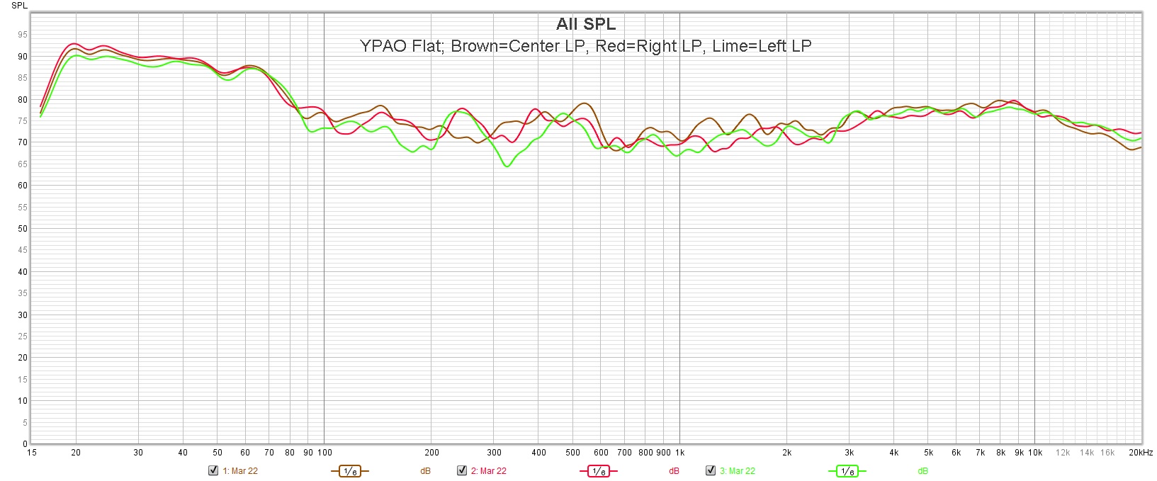

3db Audioholic Slumlord Sep 7, 2002 16,486 0 113 65 Ottawa Canada Mar 23, 2021 #24 lovinthehd said: Have you tried putting the mic above the seatback and further away from the wall? Click to expand... I lied to you yesterday, March 22 at 10:am. I decided to raise the mic up by a couple of inches just passed the chair back which made it slightly higher than my ears by an inch. Here are the revised measurements Reactions: panteragstk and Eppie
lovinthehd Audioholic Jedi Sep 11, 2012 44,872 0 113 Oakridge, OR Mar 23, 2021 #25 3db said: I lied to you yesterday, March 22 at 10:am. I decided to raise the mic up by a couple of inches just passed the chair back which made it slightly higher than my ears by an inch. Here are the revised measurements View attachment 45891 Click to expand... Looks pretty good! Reactions: panteragstk

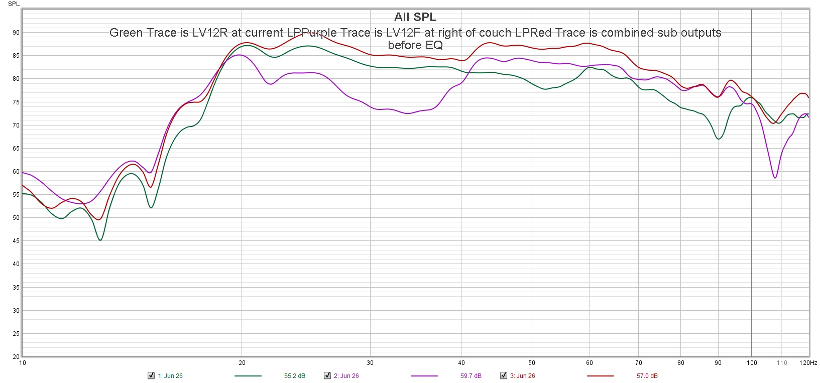

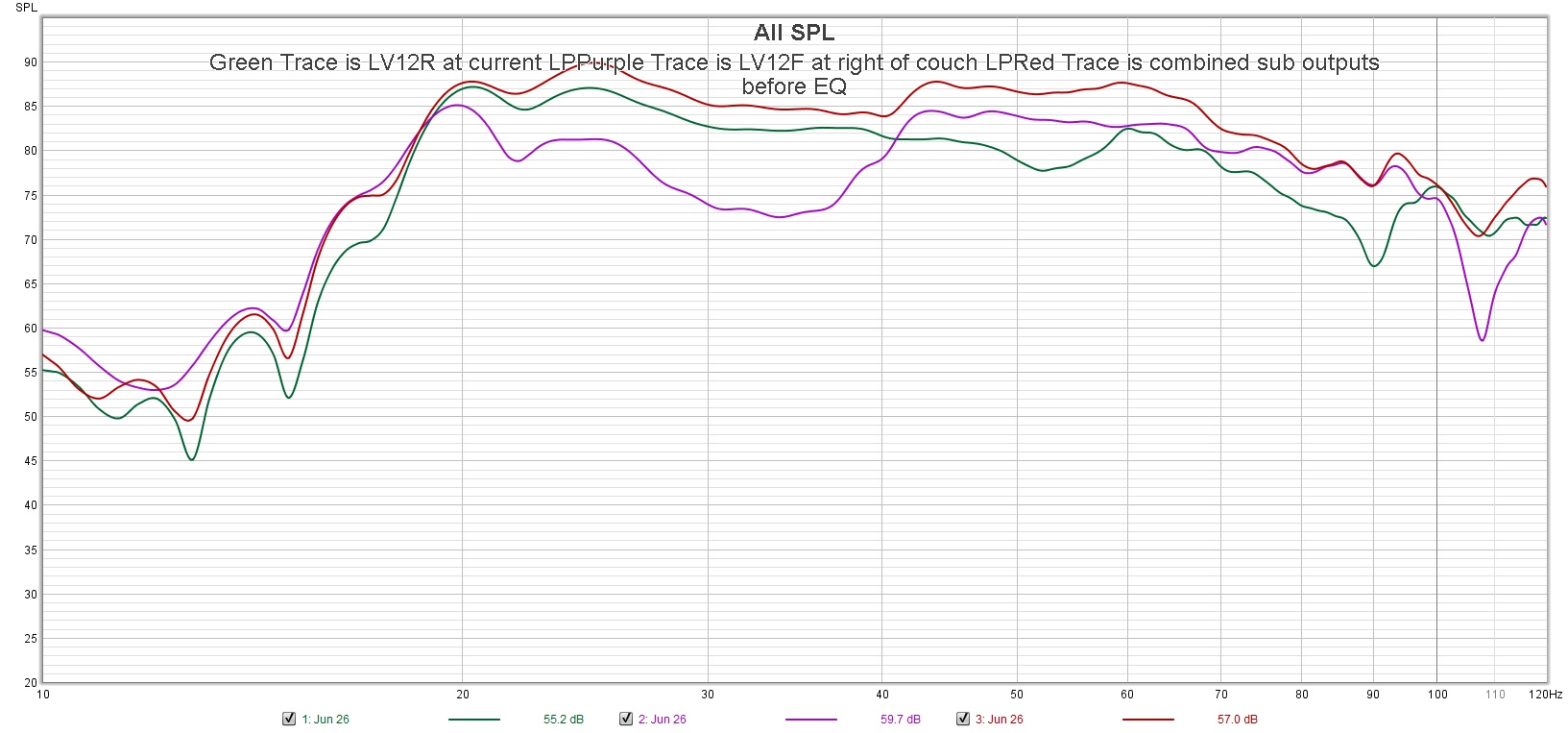

3db Audioholic Slumlord Sep 7, 2002 16,486 0 113 65 Ottawa Canada Jun 21, 2021 #26 While the weather is nice and the daylight hours are long, I will not spend much time on getting the new sub integrated into the system. Thankfully, I did keep my old measurements when I went through this exercise looking for the best location for the current sub. The new sub location frequency response is this Out of the next three locations, I will locate the 2nd sub to the right of the sofa almost opposite corner of the new location. The other two locations were left of sofa and by the exercise bike. Last edited: Jun 21, 2021
3db Audioholic Slumlord Sep 7, 2002 16,486 0 113 65 Ottawa Canada Jul 8, 2021 #27 I got the 2nd sub dialed in I think. Here is the raw response before adding a house curve via the miniDSP. The 2nd sub was first gain matched my ensuring the SPL at 50 Hz was the same for the 2nd sub at the 1st subs location.
Eppie Audioholic Ninja Jan 22, 2021 4,082 0 36 The Great White North Jul 9, 2021 #28 3db said: I got the 2nd sub dialed in I think. Here is the raw response before adding a house curve via the miniDSP. The 2nd sub was first gain matched my ensuring the SPL at 50 Hz was the same for the 2nd sub at the 1st subs location. View attachment 48990 Click to expand... Still learning about REW and miniDSP. Are most of you using the miniDSP just on the subwoofer? Basically, using Audyssey / YPAO / DIRAC for the mains and surrounds and miniDSP between the sub/LFE out and the subwoofer input? Last edited: Jul 9, 2021
3db Audioholic Slumlord Sep 7, 2002 16,486 0 113 65 Ottawa Canada Jul 9, 2021 #29 Eppie said: Still learning about REW and miniDSP. Are most of you using the miniDSP just on the subwoofer? Basically, using Audessey / YPAO / DIRAC for the mains and surrounds and miniDSP between the sub/LFE out and the subwoofer input? Click to expand... Correct in my case and for a few others here. Reactions: Eppie

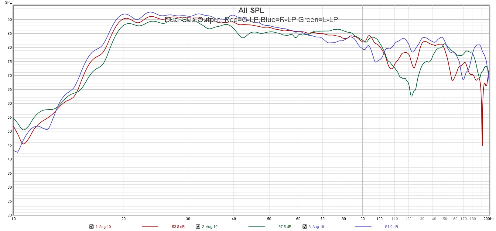

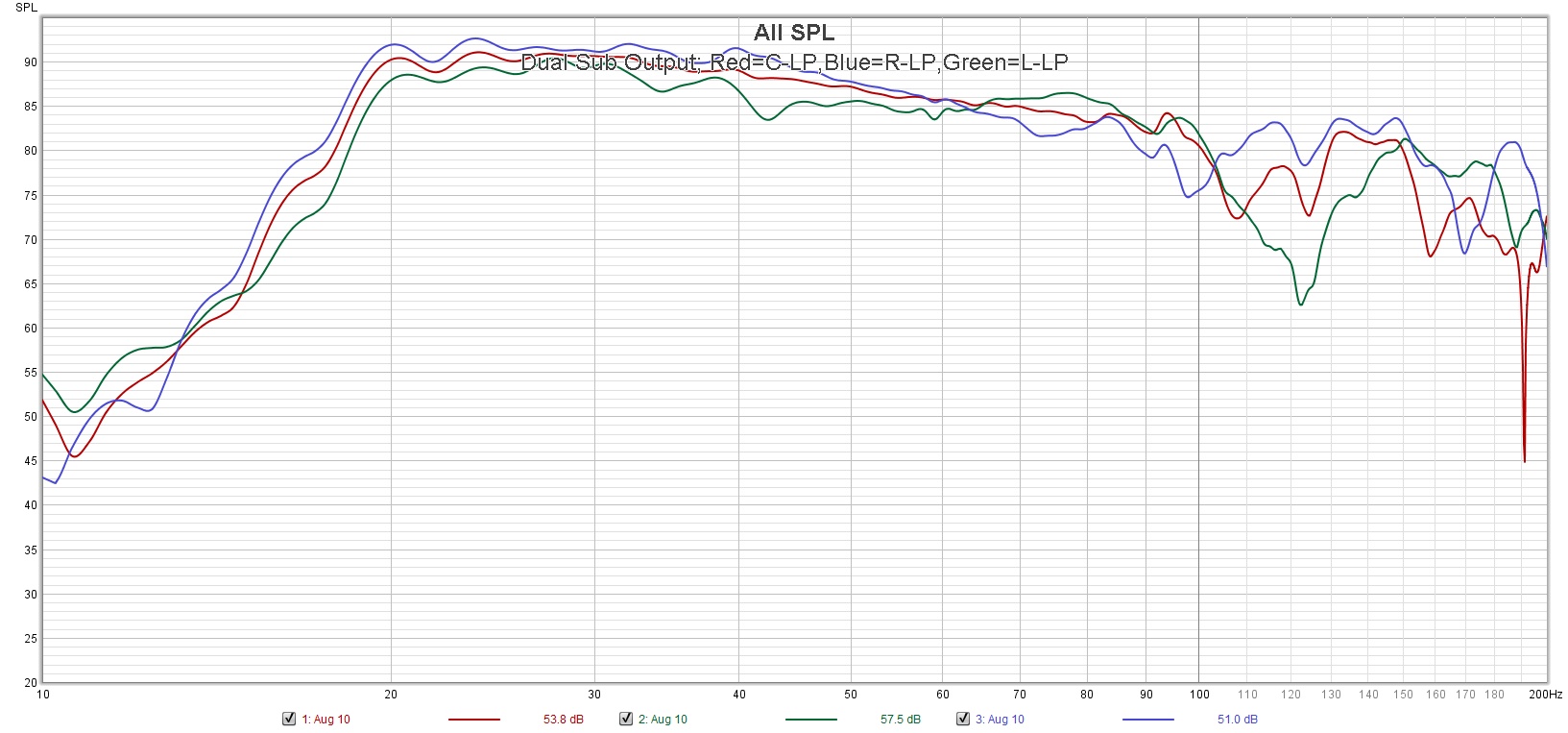

3db Audioholic Slumlord Sep 7, 2002 16,486 0 113 65 Ottawa Canada Jul 13, 2021 #33 The first graph are plots along the width of the couch before EQ via miniDSP. The second graph are plots along the width of the couch post EQ via miniDSP I'm going to have play with the EQ a bit more with the miniDSP as I'm not satisfied with the drop in output from PreEQ to PostEQ and the difference between the 3 LPs

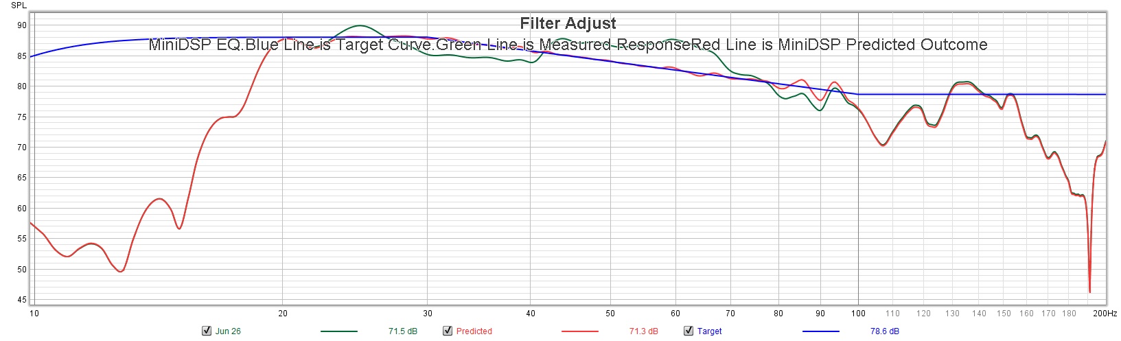

3db Audioholic Slumlord Sep 7, 2002 16,486 0 113 65 Ottawa Canada Aug 3, 2021 #34 So I've done more playing but to lazy to measure today. Instead, I'm posting a graph of what MiniDSP thinks it can do for me. I've also attached a screen shot of the settings in REW Attachments REW Config3 Settings.JPG 263.1 KB · Views: 554 Last edited: Aug 3, 2021

3db Audioholic Slumlord Sep 7, 2002 16,486 0 113 65 Ottawa Canada Aug 10, 2021 #36 The MiniDSP predicted output... The measured response. Reactions: panteragstk
panteragstk Audioholic Warlord Aug 14, 2012 8,258 0 113 New Braunfels, TX Aug 10, 2021 #37 3db said: The MiniDSP predicted output... View attachment 49655 The measured response. View attachment 49656 Click to expand... Very nice
