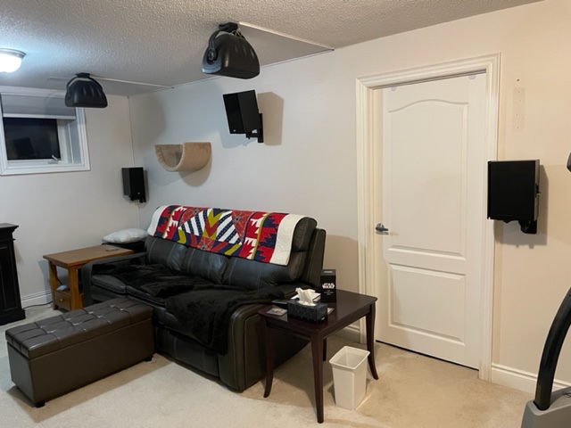

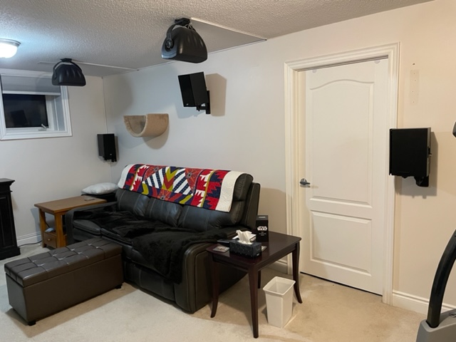

I'm thinking of removing the middle speaker and dropping the left and right surrounds more to ear level. I do not have any stands that are 40" tall (height needed just to clear the back of the couch). Should I buy stands or do I just lower the wall brackets. The right speaker is a little close to the entry way so I may move it away from that by a few inches. The reason for having them up that high in the first place was for safety reasons and not to bump into them. I live alone now so safety is no longer a concern within reason *LOL* What are your thoughts?

I like stands myself, but lowering wall mounts would also work, but might not look as "pretty".

Looks like you have room for stands. Do you have a set of stands you could borrow from another system just to experiment with? Height would not need to be critical but you could easily extend the wires down and see how it looks and whether it would interfere with the doorway. If you don't like the temp stand setup, then move the wall mounts down.

Either would be effective. I’m glad to finally see you lowering them. You will have a much better Atmos presentation. And losing the middle rear will be a good choice too imo.

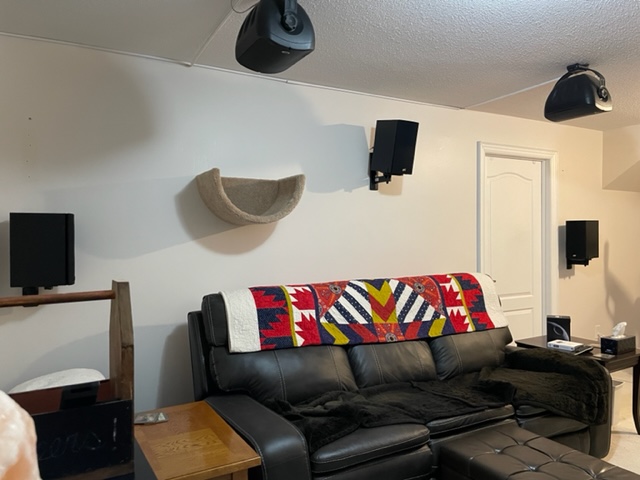

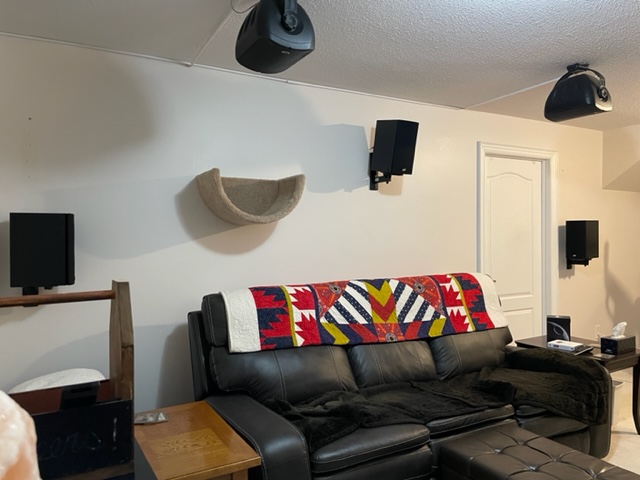

I lowered the surround left & right speakers today but left the surround back up for now. I will run YPAO tomorrow and rewatch Top Gun Maverick to see how it sounds. Pictures to follow as well. If I like the setup, I will have some wall maintenance and painting to do.

Looks great now take off the bras off the side speakers. Let's see those tweets. o_O :cool: Enjoy!

Also. Have you ever tried to aim the tops at the MLP? Speakers normally sound better on axis. Just thinking of tweaks.

I don't need to aim the atmos speakers because they have a pretty wide dispersion pattern already and I sit well within their dispersion envelope. My thought on the idea behind atmos was to create a difuse sound field. Angling them towards the listener woud reduce that.

I can see your point. But Atmos isn’t about diffused sound, but more pinpoint accuracy. If it’s working for you though, that’s great.
