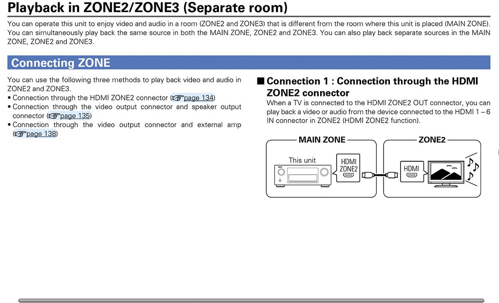

Hi... new here, hopefully not a newbie question. I'm considering this AVR for my entertainment room and wonder if it can handle my whole home audio needs as well. I have 2 other zones, and as I understand it the X4000 requires an external amp to handle zone 3. My question is about how this works specifically. If I get a Denon POA-3012ci, would I take the zone 3 pre-out from the X4000 into the bus-in of the 3012ci? Would this allow me to use all 12 speakers off of the 3012ci with the same source coming from the X4000?
Thanks in advance
-Steve

Yes that will work. Just remember you will need analog connections for the exta zones as you cannot use hdmi sources.

The X4000 can send HDMI audio to Zones. If playing the same source in multiple zones, one is restricted by the number of channels in the other zones. So if Zone 2 HDMI is going to a TV, Main Zone will be restricted to 2.0 as well. That said, with different sources playing in different zones, there is no restriction.
If the other zone has an AVR, the main zone can play a 7.1 DB while the other zone watches a cable show in 5.1.
shoek
I primarily want to use Airplay and Spotify in the 2/3 zone, just stereo. As I understand it, this will limit me to 5.1 in the main zone when Zone 2 or 3 is active at the same time, correct?
That limitation pertains to the use of the AVR amplifiers and not to signal distribution/ pre-pro capabilities.

Here is the page in the manual that says HDMI In 1-6 can be routed to Zone 2 for video or audio.
