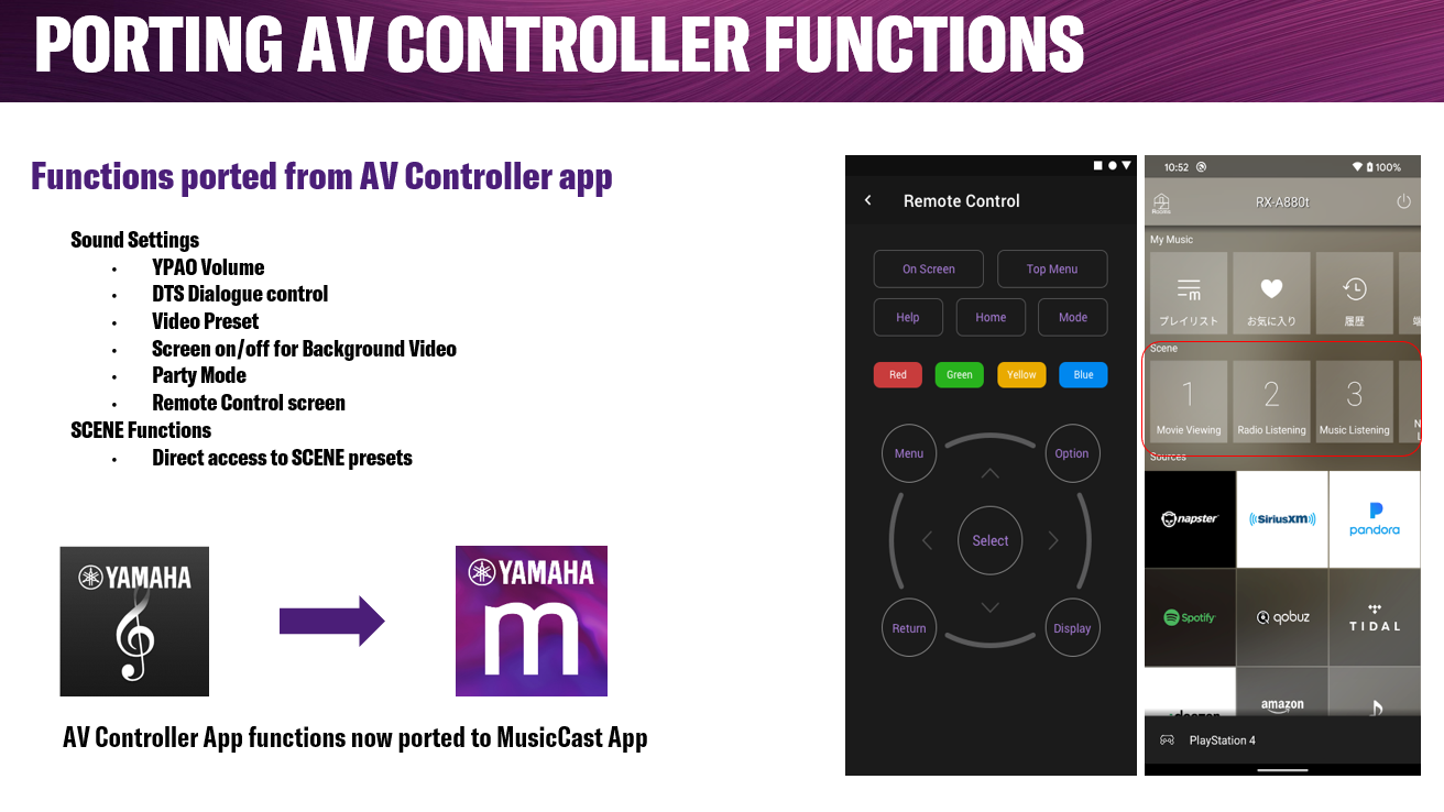

Has anyone with a RX-V6A/TSR-700 (or recent similar) used the Musiccast to get into Options... to set speaker/subwoofer levels?
Yes, but I'm betting there is more to that question...how can I help?
Might you be asking HOW to get into the Sound Settings via MusicCast via phone app *or* whether it is worth it?
Aside...for such capabilities, I prefer using the Speaker tab via Web Setup (accessed via your receiver IPaddr, as in: w.x.y.z/Setup).

Nice! Thanks for replying!
Finding a way to use the remote or iPad to get to adjusting my subwoofer via setup/options would be great.
I specifically planned my music setup to purposely exclude a TV.
So needing to plug in a TV anytime I want/need to adjust setup/options on the receiver is not great.
The last Yamaha receiver I purchased 17-18 years ago allows me to make these adjustments via remote which is why I didn't see this issue coming. An easy option could be to swap my receivers.

Were you able to get it configured & running?
There are many options...I like (and everybody in our home has different needs)
  • Web Setup for deep configurations
  • MusicCast for quick real-time control (remote replacement, needed for easy Pandora Station switching and multi-room linking)
  • Remote is good...especially if you have setup SCENES properly.
  • Front Panel -- almost never (just to Initial CONNECTION *and* TURN OFF after updates)
However, I think I did use Remote Setup + on Screen TV for these (and don't remember trying to do it another way).
  • Internet Setups (I have multiple units, wired & wireless)
  • YPAO
  • adding MusicCast
