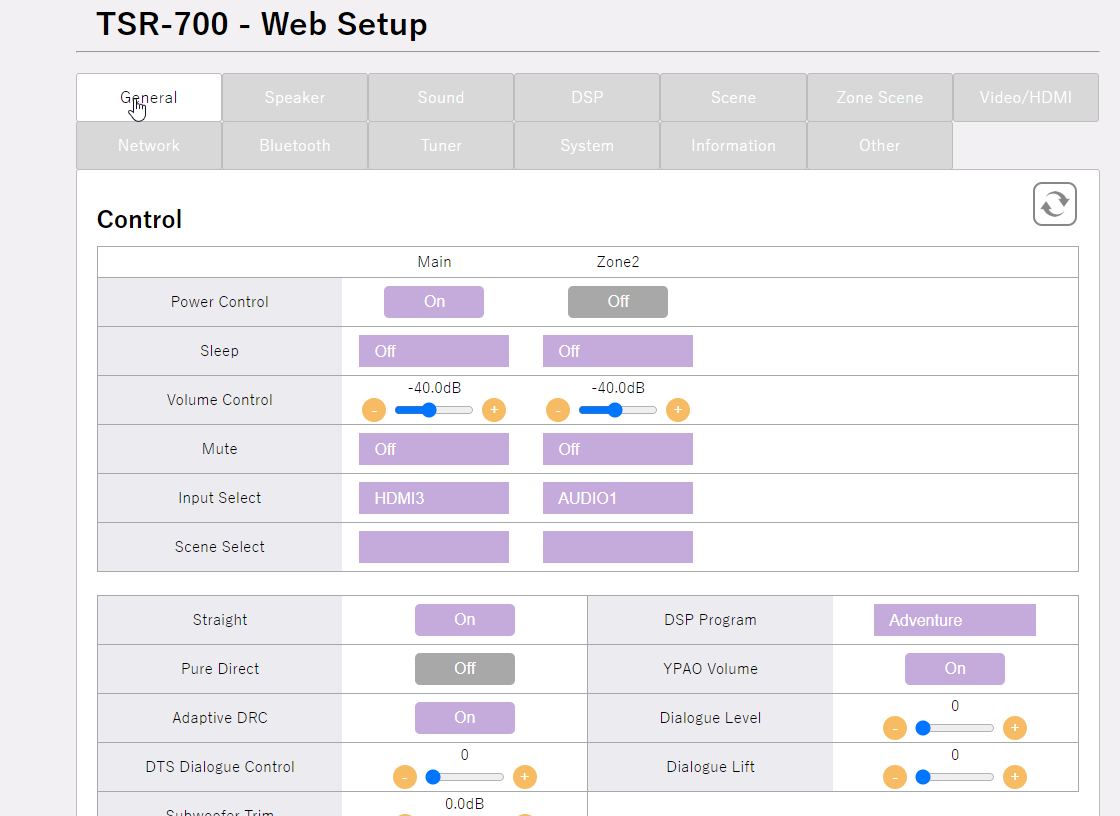

I found a feature in the AVR that I really like. All settings can be controlled by a webpage. No need for the remote. Just point a browser to http://X.X.X.X/Setup/ where x.x.x.x is the ip of the unit
Agreed.
The browser version is best for setup & configuration. You can get to many more details and faster especially for SCENES...use the! Still lacks any type of help (in context).
Next, I'd use MusicCast, especially to switch among choices in user-time (e.g., Tidal to Pandora; Pandora station1 to station2).
However, if you've setup you SCENES properly, life is easy. You can use 8 pre-defined SCENES (1-4 plus the 4 colored buttons) from phone or remote or browser AND loop through PRESETS within a SCENE (via bottom 2 buttons on remote).

If you want to use the SCENES 5-8 you need to enable them.
While you can do that on-screen, again easier in the browser:
