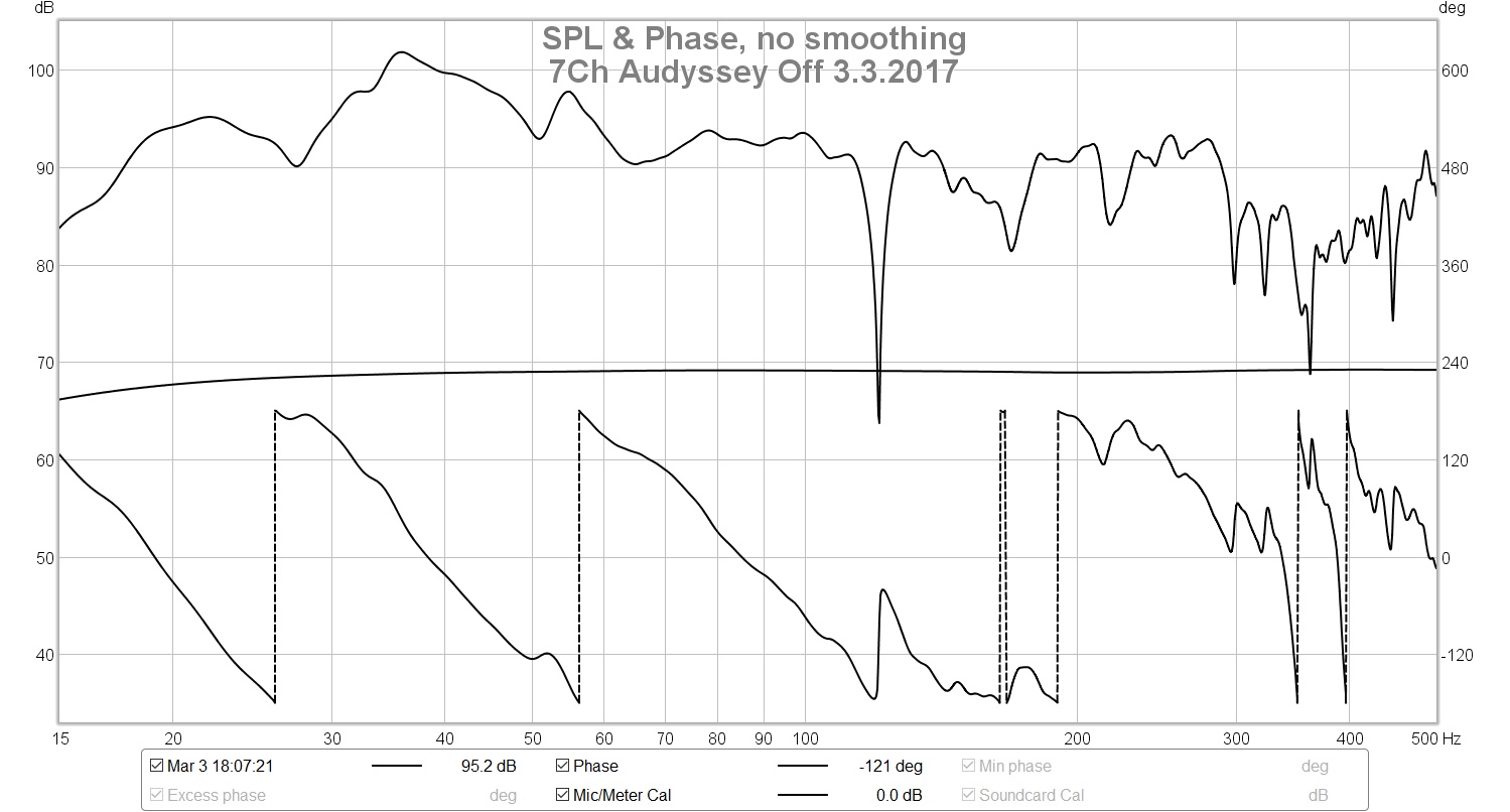

@TheWarrior, thanks for posting yours. If I can find some time today I will use the same scale and 1/24 smoothing so we can compare our graphs more easily. In my last post, there is no smoothing at all, but as I said, they look almost the same as 1/48. I did it just to humor William, obviously he's aware of that..
I would normally use 1/12 and 1/24 when I want to make some manual adjustments to improve further when I feel Audyssey has done its best. Since the results seem very good already, I have not tried hard to find the time to do any manual tweaking so far. Just fyi, I was too crazy and lazy to get rid of my 3 lesser subs, and I ignored SVS's recommendation to use identical subs. The graphs you see are for 7 channel stereo mode plus 5 subs in total, 2 Energy Veritas and 1 Polk audio for the surrounds, and a PCU12 and PB13U for the L/R.
