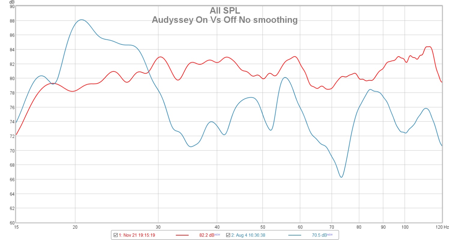

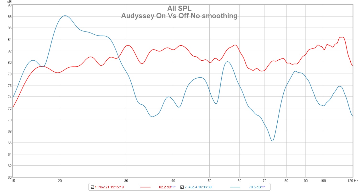

You mentioned REW defaults to 1/6 but that is not true, though I have seen more graphs posted using 1/6 smoothing. I think SVS might have suggested 1/6 smoothing for telling the big picture. Unless your room is perfect, it could be extremely hard to get anything that resembles a flat line in the lowest octaves, so 1/6 may in fact be best to get you dialed in quickly in the 10-80 Hz range. After that you can play around and see if you can do better by tweaking something else including some sub crawling.
I don't have a before vs after graph done on the same day so the graphs below will show different levels. Not sure if that's the best one I saved either. That 50 Hz dip looks odd to me right now, it was there but I thought I had a better one.

Iirc, I've read that 1/6 is closest to the resolution at which we hear. Also, I think that graph should be scaled from 45-105db. As is it looks a lot smoother than reality, and appropriately scaled would give a better idea.
I agree, was in a hurry so just go with default, but it is not hiding anything because smoothing is 1/48, they actually look the same even with smoothing removed.
PENG
Okay, change scale to 60-90 dB on the vertical axis.

Wow, went the other direction, lol. Just so you know, I wasn't going after you. Just making an observation.

Since we're talking about bass, phase data is paramount. Need to see smooth swings in the phase without small breaks in the slope. 1/48 is actually too high, I did that too, Floyd told me to dial it back. There's too low a resolution that masks large peaks/nulls, and then there's too high where you blur the phase data. The following is 1/24.
