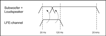

Just wanted to share this visual to help illustrate the relationship between the LFE channel which is only present in films, and only changed by the LPF of LFE setting, (mislabeled as 20hz-120hz, should read 0-120) and the XO relationship between the speakers and subwoofers and how redirected bass is handled.
Thought it might help to “see” how they are mutually exclusive. If this doesn’t help, or you already understand I will piss off! Lol
Edit: this is a representation of bass management handled in the AVR.
I don’t find any information about what could be the YPAO detected low pass filter value but when using extra bass in stereo music, I have deep bass and the low medium aren’t boosted while my sub crossover potentiometer is set on the max (120Hz) so Yamaha is definitely doing something right here. I am listening to tunes that I have listen with manual sub settings and I think I was blasting bass. Now I still have some bass when needed, but it’s not “in your face” (which when receiving your first sub is pleasant but actually not right).

Well if you mean the in the image I attached, the ypao detected LPF would be in reference to the LFE channel. The bottom graph. Basically you can lpf, the top of the LFE signal. This is irrelevant to music since there is not a .1 channel in music, but only movies.
