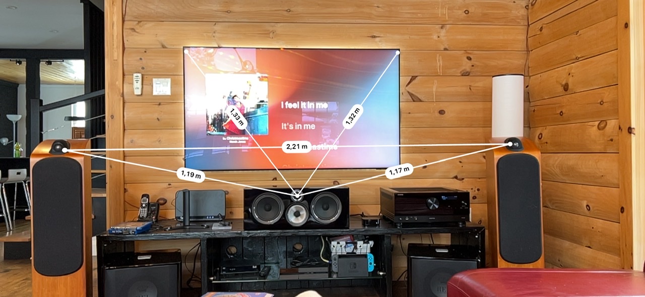

I discovered a new tool to help with psychopath symmetric placement : iPhone LiDAR
Also a tool to check YPAO distances
As far as checking the distances goes, they're not always gonna line up with what you measure with a ruler (or a lidar phone app- very cool btw!). YPAO uses the distances as a type of delay for proper timing so it's not so much to do with feet and inches (or meters and centimeters for you canucks) as it is about milliseconds. It's most often more off with subwoofers ime, but it's pretty normal. I wouldn't mess with changing the distances myself.
Agreed. The mic “sees” the room in an auditory way. That’s complete with reflections and diffractions and stuff. Good thing I guess is I believe he mentioned that they were close. A little surprising since the right front is right against the wall, and the left front has nothing.
I will run YPAO now I understand that that sound distance isn’t straight line distance. I have a question about the crossover on subs, should I let the subs to play full range (27-300) while doing the calibration and let the amp manage the crossover? Or manually setting the proper front speakers/ subs crossover is the way to do it ?
