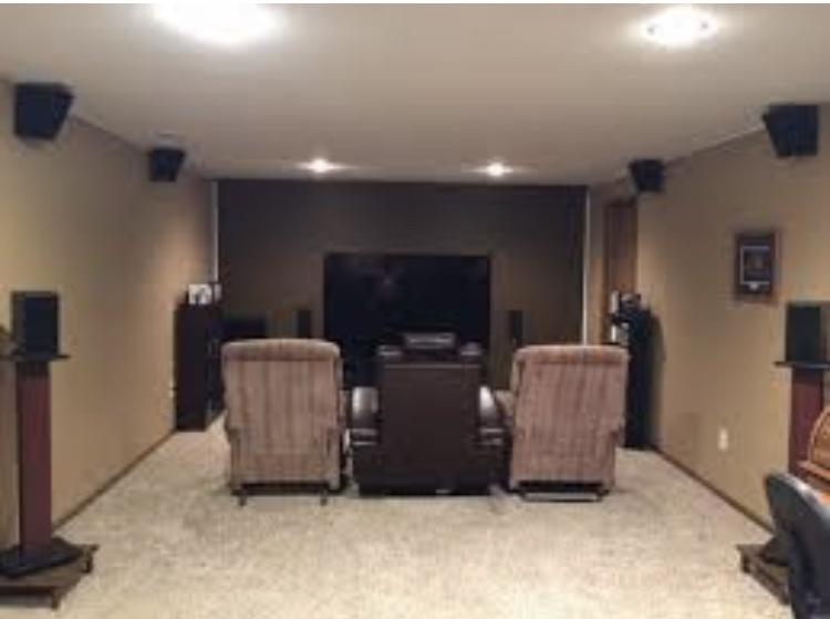

Yeah, right now my front and rear heights would be on the front and rear wall (not the side wall). Its a small room and a little offset (my seats are dead center, they would be closer to the right wall in your setup)
What is the shape and size of your room. Do you have elevated ceilings or normal 8-9ft high ceilings?
Its basically a rectangle, with 9 foot ceilings. I could move the rear and front height speakers to the side wall.

I honestly think it would be worth moving the front heights to side height positions. But that’s just me. I also think you could benefit some by lowering your surrounds a little bit. But whether that’s worth it or not could be up for debate as it’s hard to tell angles and scale from pics.

If your room is less or equal to 12 x 15 you can probably do either to good effect. But Dolby design specs for Atmos speaker placements prefer they are in the ceilings but if not, then, the high up on up sides but if not, then high up front and rear.
