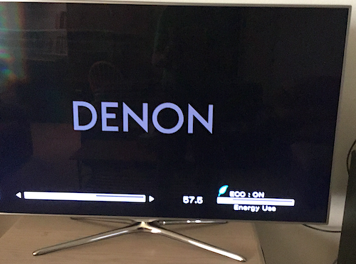

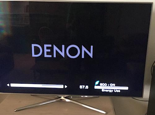

I am not using ECO off or auto mode. I leave ECO "ON" and it does not click when the volume rises above 47-57. ECO stays on and the power meter stays low. Here is an image of the volume at 57.5 and ECO mode is ON. Energy usage stays low on the power bar - Denon stays cool. I don't notice a difference in SQ with the main speakers on an external amp.
Okay so we are talking about different setting. I was always referring to "auto" that apparently some people including some of ASR thought auto is the best and would keep their units cool while in fact unless people have their volume below around -29/-30 auto has no effect in cooling because Eco works on the volume position only.
If you have Eco "On", then of course it will stay "On" all the time. You won't notice difference in SQ from the main speakers because Eco has no effects on the pre-out. If you other speakers, such as the center channel, will be power limited by Eco if they are powered by the internal power amps.
