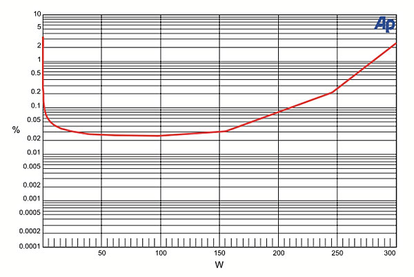

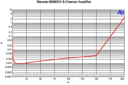

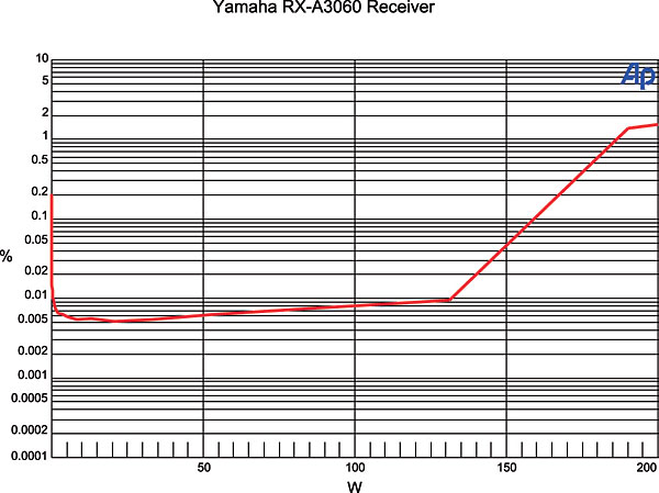

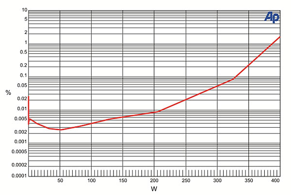

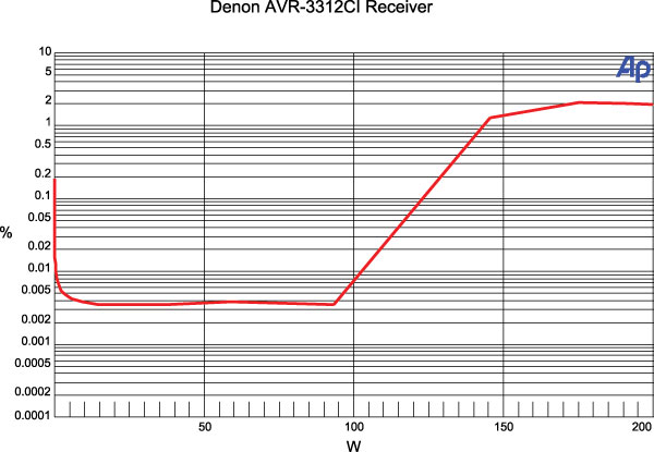

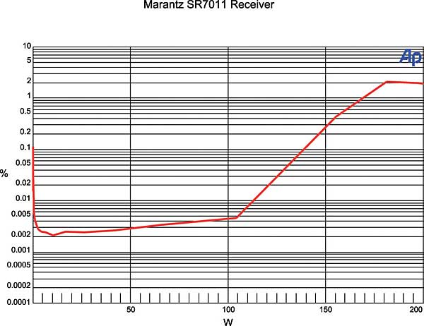

Seriously, aside from the A52+'s 50 hours break-in requirement @Pogre highlighted, let's stack them up below, using S&V's bench that also use the Audio Precision like Gene and Amir do, and we call all see it for ourselves.
It looks like one has to get to the $6,400 AT6005 to match the likes of the much cheaper RX-A3060 and AVR-3312CI in THD+N, measured with the 1 kHz signal.
I have to wonder if those THD Vs Power output graphs are just waste of time. If not, why are the AVR internal amps that pissed people off so much, just ask TLSGuy for example, yet offer measure better than separate amps? Keep in mind the AVR's THD+N includes the contribution of the preamp's as well.
And before someone say something about the first watt being most critical, it doesn't look like the A52+ did better in the first watt either.
I did not use the AVR-4308CI this time, as that would put even the AT6005 to shame (there must be something wrong with S&V I guess..:D.
I seem to remember ADTG had used his 3311, or 12? with the big 802 D2 for a while and said it was doing the job fine, so may be they are actually that good, not just a pretty face/graph.;)
One thing we can see though, both separate power amps have a gentle rise in THD pass the clipping point, but they have much bigger power supplies so softer clipping is expected, no surprise there.
Halo A52+
Yamaha RX-A3060
Denon AVR-3312CI
Marantz SR7011
Marantz MM8003
ATI 6005
Halo A52+
Yamaha RX-A3060
Denon AVR-3312CI
Marantz SR7011
Marantz MM8003
ATI 6005
