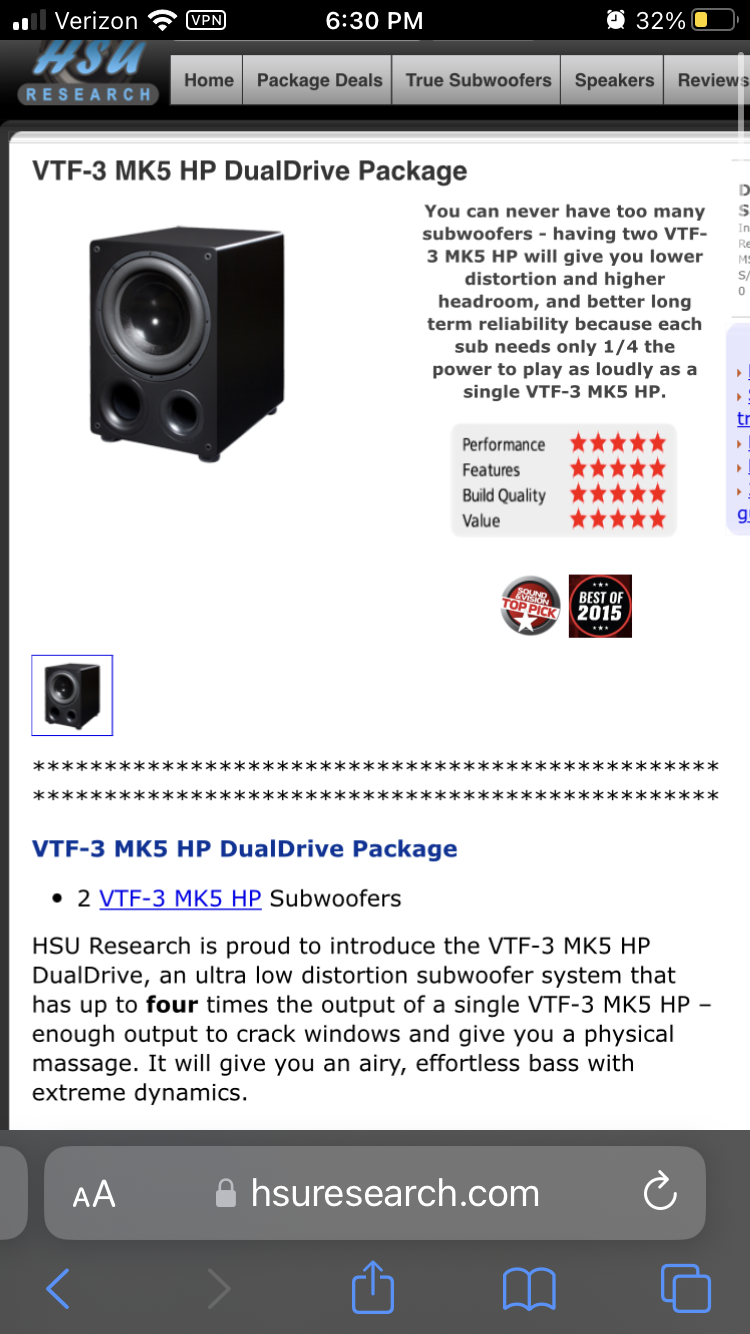

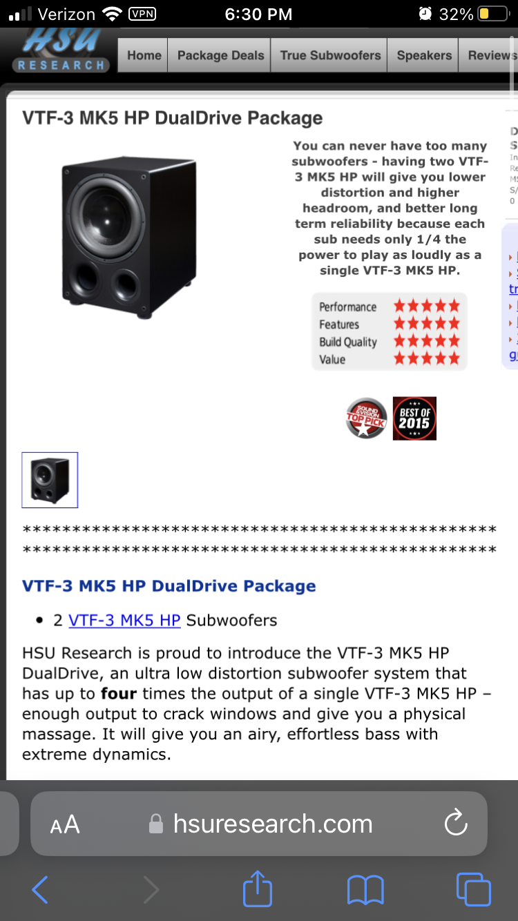

Yep :D , I’m also wondering why hsu says 2 of there subs is 4x the output of 1.
Can you show where they said that?
They’re probably comparing ported to sealed. In that case yes, below about 35hz ported will have more output and by the time you get to 20hz it will usually be about four times the output.

On duel drive it says up to 4x , but cmon makes no sense.
Well there’s no context but I’ll take a stab.
A second identical sub can add 6db total output. 3db output is considered a doubling of output, So, a dual(not duel) drive system that’s capable of 6db more is quadrupling.
Hows that?
Kingnoob
Kingnoob
Hows that?
Yeah it doesn’t add up I also thought second sub added 3-6db but I wasn’t sure how much been so long since I checked.
Why I asked you because to just didn’t add up, and I’m not certain how duels /multiples stack up but 4x seemed a bit high.
either a sales trick or someone was bad at math ? o_O
You might be conflating spl and output as William mentioned...you measure both in dB but doesn't represent the same thing.
Lol. I’m pretty sure the good dr shoe can do math.

Yeah I guess it’s not as powerful as 4 of the same subs how I thought it was worded just so confusing o_O . It’s up to max 4x power of 1, that’s if they are both in perfect spots also and calibrated .
