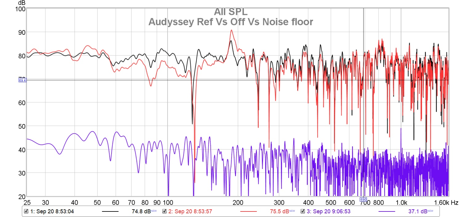

Agreed, in addition, as mentioned many times by others, noise floor is another important factor and that's why audiophiles or even ordinary audioholics are so keen on SNR/DR specs and measurements. I know as least one, namely @AcuDefTechGuy is very keen on SNR:D I hope he would chime in with some REW plots when I start another thread to compare such graphs, just for fun..
One of the common problem I see in terms of what I referred as "logic" is that not too many people have dedicated HIFI/HT rooms that are acceptable quiet to tell the difference between SNR/DR of any more than 60 to 70 dB. Please note that even red book CD spec has 16 bit resolution, that is a whopping 96 dB of DR!
Below is my best noise floor measured a couple days ago, when I caught the moment it was totally quiet outside, that is no road and air traffic, and the fridge and HVAC are both off. So I guess even if I have golden ears (I know I don't, no silvery or even coppery ears..),I could not possible, logically speaking, tell the difference between an avr-x3400h and a separate Cambridge Audio preamp+Parasound Halo A21. No wonder I couldn't and I tried really hard.

From the results provided by the above figures, I agree in that any gear with a SNR of 60 dB or more would be acceptable for all practical purposes in a typical home environment. Products from popular brands easily meet that criterion anyway.

I might add, as long as it is 60 at 1 W or lower output.

That would mean a noise level of 0.000001 of a watt or less for a 1 watt output. Nobody would ear that for sure. Isn't that somehow overkill?
