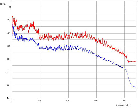

As program material, he wanted a music passage that was likely to heat the speaker’s voice coils. He quoted a good authority (Bob Stuart of Meridian) that Metallica tracks make for good power-testing material, as they have negligible dynamic range and quite a wide frequency spectrum. As he didn’t have any Metallica, instead he chose a passage from the song Heartbreaker from Led Zeppelin II. He claimed, the instrumental section in the latter half of that song was just what he was looking for, with a paucity of dynamic range, and quite a wide acoustic spectrum (fig.2). Because this passage lasts about 47 seconds, he stitched seven repeats (329 seconds) end to end in a WAV file to create a single track of over five minutes long.
This graph (figure 2) shows two traces of dB full scale (dBFS) vs frequency of peak (red) and average (blue) audio spectra of the 47 second passage. The author claims the wide frequency range and close spacing of the red and blue traces confirm the low dynamic range of the passage. I’m glad he at least tried to document the dynamic range. Without anything to compare to this, we have to take his word. If anyone cares enough, they can do a similar measurement with another musical passage.

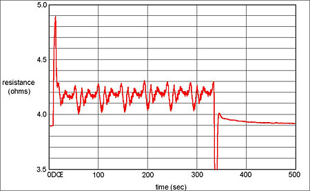

Figure 3 – mid-woofer
The trace began at 3.9 ohms before the music passage began, rising to about 4.2 ohms while playing the test program, and rapidly returned to 3.9 ohms afterward.

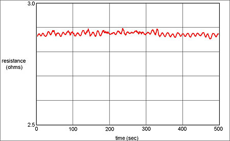

Figure 4 – tweeter
Same test as in figure 3, but with the tweeter. Note that the vertical scale is different than in figure 3. It shows the range of 2.5 to 3 ohms, over the same vertical distance as the 3.5 to 5 ohms in figure 3. It is ‘zoomed in’ or magnified. Here the change in resistance during the test program was barely distinguishable, amounting to about 0.01 ohm.
Conclusion: Under these test conditions, thermal compression is barely detectable, and is not considered a problem.
