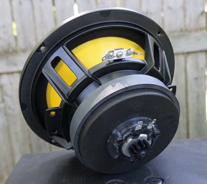

I’ve actually pulled apart one of my speakers to find a massive heat sink on one of the tweeters, not sure how effective it is by itself.

I know several other Klipsch tweeters have had mounted heat sinks on them also. For whatever reason, unlike the II series, the premier series doesn’t have them.

Not uncommon to see heatsinks on tweeters. For example, the back of the tweeter on the Hsu CCB-8 coaxial driver. Remember its not just about preventing thermal compression, these cooling methods are also there to stave off destruction from abuse.
