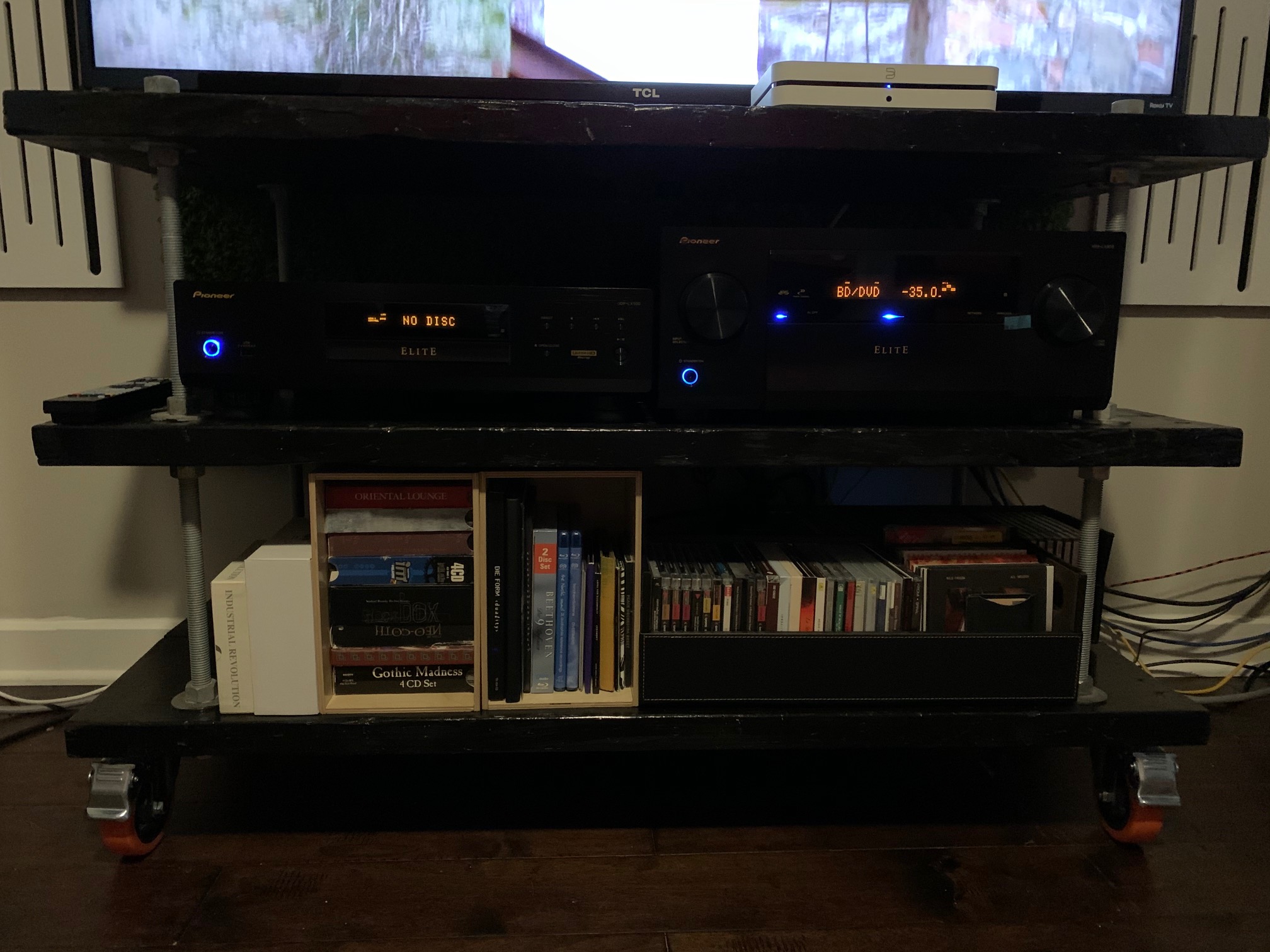

Hey AH peeps! I've been doing some thinking and researching and would like solicit your valuable collective input. As some of you may or may not know, my main interest when it comes to audio playback is strictly two channel - I have no real interest in setting up a surround system. Recently, I purchased a Pioneer Elite VSX-LX503, mostly to play with features not found in your typical 2CH setup (MCACC, etc). What has been bothering me is the Pioneer has all these "wasted" channels of amplification. So I got to thinking, "What if I were to add a center channel and have a proper 3.1 setup?". I really, really like my Elac Adante AS-61s and there is a matching center channel speaker, the AC-61, which is quite the monster:
It originally retailed for $2K and I can get a new one for around $800. This kind of makes sense to me because yes, my system is dual purpose and video is a part of it. I have no problems with dialog and my "phantom center" performs admirably, but adding cubic inches of speaker displacement is always fun! Also, I have a lot of 3 channel SACDs (most of the Living Stereo collection was originally recorded this way) and multi channel SACDs, DVD Audio and Blu-Ray Audio.
The only real issue is how my system exists today and where I would place the center speaker:
I would need to place it on the second shelf and shift my AVR and Blu-Ray player to the first shelf. The second shelf is 19" above the floor, placing the center line of the drivers at just about 24" (keep in mind my LR speakers sit on 24" stands and the midpoint between tweeter and woofer is at approximately 34"). Luckily, the AC-61's shape allows it to easily orient it in an upward angel and comes with handy dandy rubber "wedges" to do so. Also, it is kind of neat that the AC-61 is almost exactly (minus 1/2") the size of the opening between the supports!
My main questions are 1) do y'all have experience with strictly 3.1 systems and how do you like it 2) will my soundstage "drop" because of the lower center 3) is it even worth it or am I just throwing money around?

I'd personally want a center on the top shelf of that stand where the TV currently resides. Could you wall mount the TV and then put the center channel there?

If I added a center to the stand in your pic, it'd go on the top shelf and I'd either wall mount the tv or put it on a riser, but I'd want the center as close to the screen and ear height as I could get it.

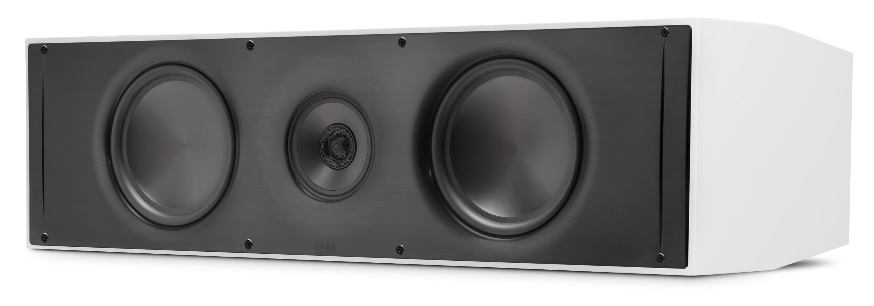

My equipment rack is right at 19" deep (two reclaimed 2x10s) and the Adante center channel is 15.61"D - not a lot of room. I also have to consider where and how far apart the TV's feet are. I like the idea of riser though...

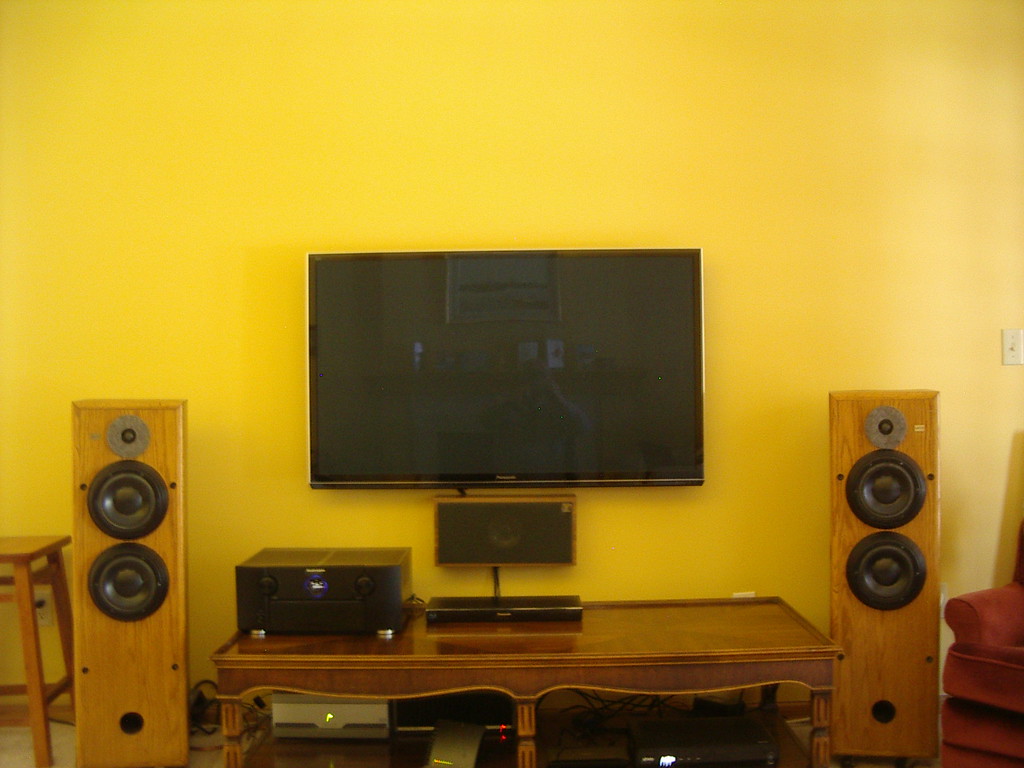

Hrm,
Raise your TV; get a 3rd copy of your L/R mains and use that as your center (vertical) to avoid any comb filtering and you're good to go.
My personal experience, I'm actually quite pleased with 2 channel audio even in movies even though I have 5.2 and 7.2 systems. I've done 3 channel systems and ultimately didn't care enough to warrant the difficulty placing that center speaker with several setups compared to what it added. If you're happy with 2 channel, stick with 2 channel probably.

A two way speaker has a tweeter and a mid woofer or more. A three way has woofer, or more, plus mid or mids and tweeter.
Your speakers are two way. The center you sighted is a three way with mid/tweeter coaxial driver. That is the speaker that I showed the FR for.
The problem comes that in three ways there is often a null at crossover and this can be dealt with by reversing the phase of the mid driver, like Dennis Murphy's Philharmonitor for instance.
The problem comes if the mains are two way and the center three way, then correcting the null puts the center mid out of phase with the main's bass mid. I can assure you that is not good. So it becomes better to accept the null and keep the mid in phase with the mains.
The problem is that a center 2 way MTM with horizontal lay out is compromised, especially when the crossover is in the speech discrimination band.
So the solutions are a vertically aligned center, a full range driver for the center, a coaxial driver for the center , or a three way with a mid good enough to cover the whole of the speech discrimination band. The problem is that really good full rangers are very rare, coaxial drivers are also not plentiful, nor are mids that can cover the whole of the speech discrimination band at power plentiful. All of this adds to making a center speaker a real design challenge. I agree with the BBC that center speakers in most cases are a problem and not a useful addition if the mains are capable and can project a stable central image over a wide area.
