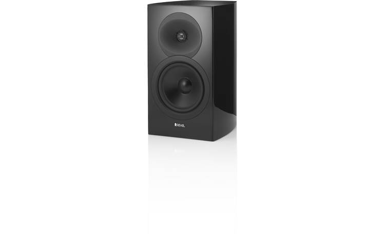

Bumping up your budget would be my advise as well. Revel has good sale on the M16 and has very good performance for the price.
Of what you have, the Polk would be my choice.

I'm definitely going to look at the Revel M16's tonight their on special right now for $346 a piece.
