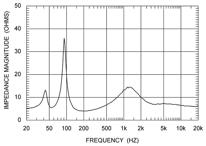

My only little concern is that it may not be great for speakers that have high impedance peaks well above 8 ohms especially if that happens in the lower bass frequencies. .:D
Peng, that would be well outside the norm wouldn't it ? with the exception of electrostatics most dynamic speakers imp falls in the lower octaves.
Sort of, but not totally true, take a look of the graphs below. They all have some relatively high impedance peaks below 100 Hz, but I forgot what I was thinking at the time as I really meant to say impedance peaks in the high frequencies. For low frequency, even 8 V/micro sec is plenty, obviously.
OK, that's what I thought you meant. Again though, keep in mind electrostatics behave in the opposite , their impedance dips in the upper octaves. So where that would be of greater concern with a dynamic driver (amplifier clipping distortion destroying the fragile tweeter driver) it is not the issue with an electrostatic.
Thank you for bring up electrosatic speakers. I have to agree, you can say the same about THD+N, SNR, frequency response etc. etc., and at the end of the day it is more about marketing and bragging right. To say 16 V/microsecond being too low is like saying 0.05% THD+N is too high, or damping factor 50 too low and yet people seems so forgiving on loudspeakers relatively much uglier measured performance.
