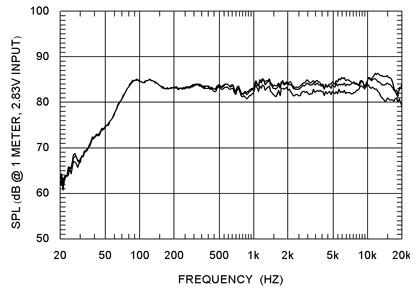

I have to agree. Another point to add, the KEF reference 201/2 and the Revel Ultima Salon 2 have the flattest FR I have ever seen, yet still quite ugly compared that to that of any good class AB amps. Below are the prettiest plots one can measure from any speakers, in an anechoic chamber. With any room mode factored in, all bets are off. Even then, if you simply move a couple inches, they should sound much more different than that between amps with 16 vs 32 vs 60 V/uS and/or 0.0001% vs 0.05% THD+N or whatever specs that turn people on.
Almost forgot, that's just FR, their distortions are also much higher, though the KEF's 201/2 is among the lowest I have seen, lower than that of the Salon2, but still much higher compared to amp's.
