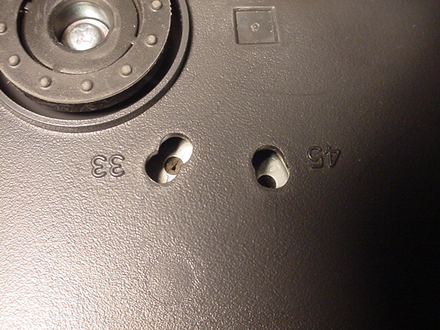

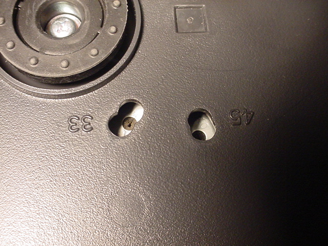

SO. heres a photo of the 33 rpm and 45 rpm holes in the bottom of my Sony turntable that I might return to an ebay seller. You can see the oval holes in the plastic bottom and then there are holes in the metal sheet and inside each hole is where I was trying to turn the screws (that drove me crazy) but this guy said they are not screws. What are they? Are they the foam that I need push in to remove? Or how will I use the tool on them and what kind? What size of the non-metallic trimmer screwdriver do I need and where can I find it on amazon or ebay?
AS YA can see, in the 33 rpm hole(s) it looks like a flat screw head with a way off-horizontal (kind of distorted) slot or indent (in between horizontal and vertical but it never moved out of place as I was trying to turn that with my 3 mm flat screwdriver) but this guy is saying thats not a screw, what is it and how do i remove it or adjust it since im a amateur, thanks!!!

Can you provide better pics of what's in the holes? That doesn't appear to match the description of the interface for what the last gentleman described nor for the tool mentioned https://duckduckgo.com/?q=potentiometer+trim+tool&t=ffab&atb=v136-1&iax=images&ia=images
Yeah, if only "somebody" (like me!) had told you IN POST #12 that what you are calling screws are most likely "pots".......
What we see in this picture is the FOAM that he was telling you about! Which has already been punched through! You can't see the pots due to that foam, and you don't need to see them either.
Let me make it 100% clear-- There is NO PROBLEM WITH THIS TURNTABLE! The problem is that you do not have a clue what you are doing, and you do not understand the clear cut advice and instructions that you have been given.
You should feel the screwdriver seat into the slot on the top of the "trimpots", and you should feel it when it turns. Anyone that has done such work a few times will know this immediately by FEEL, and you clearly have never done this so you clearly don't know the proper feel for seating the screwdriver blade and turning a pot.
You CANNOT see the "screws" (i.e. trimpots) due to that piece of foam, so when you said you "can see that the screw did not turn", that isn't accurate b/c you can't see the screw (trimpot) at all!
SO was the foam removed or are they still there? Do I need to remove them in order to insert the tool to reach the trimpots below that??

"I can only really see the 33 hole in your pic but that doesn't look like a pot to me, more like a the foam or other cover. The "slot" being what you've created with your screwdriver. I'd try a pair of tweezers & see if that is indeed something soft that can be removed.
Would expect to see a clearly defined slot like one of these. Click "images" for more examples. "
Any chance that is foam in that hole that can be removed and under that would be the trimpot? I grabbed it with a tweezer and it seems like its made out of rubber that can be broken apart but not sure if it can be removed. Or is that a trimpot that can be adjusted with one of those trimmer tools? I believe the previous owner made that indent with his mini flat screwdriver because before I even used my flat screwdriver on it I checked with a light to confirm which screwdriver I needed and noticed that slot.
Close up photos of 33/ 45 rpm holes-

I have already told you EXACTLY what you need to do, and EXACTLY what you are showing in your pics! PLEASE REVIEW AND FOLLOW THE INSTRUCTIONS BELOW. If you cannot or will not understand and follow my advice, then you have no business with a screwdriver in your hands! In that case, you are beyond help here, give it up and move along.
1 more time-- What your pic shows is the FOAM inside those holes. YES, the FOAM has already been poked through. YES, the trimpots are further inside the unit, PAST the FOAM.
YES, shove your screwdriver (trimpot adjuster tool) THROUGH the FOAM, likely needs to go in ~1/2 inch or so. Push it in GENTLY until it stops! GENTLY begin to rotate the screwdriver until you FEEL THE SCREWDRIVER SEAT INTO THE TRIMPOT.
NOW you can adjust the trimpot to your liking!
If it makes you feel better, or if you think it will give you a better look at the trimpots, then get a set of tweezers and PULL OUT THAT FOAM THAT WE CLEARLY SEE IN YOUR PICS. All that foam is doing is trying to block dust from getting in there, it is not needed in there and is causing you confusion.

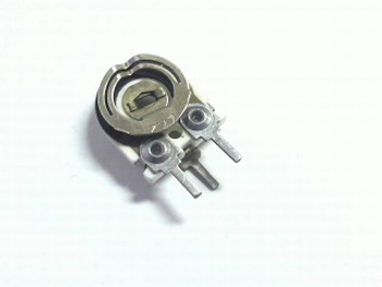

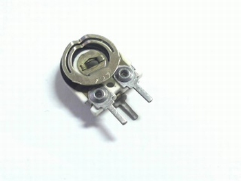

Most likely the trimpot will look more like this:
or this
