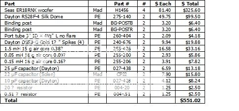

Was that $800 for everything or just the drivers n crossovers? What did you gain by going w/ the ribbon tweets?
I believe that $800 includes everything he spent so far, including lumber, paint, varnish, sand paper, etc.
There are two versions of the ER18 MTM towers, one with a Fountek ribbon tweeter, and the other with a high quality 1" dome tweeter. There are crossovers custom designed for each design.
The details are in this post. The parts & prices for drivers, crossovers, vent tubes, binding posts, and cabinet feet are shown below. The bottom line in each table shows the total cost.
Parts List for Ribbon Tweeter version (Fountek Neo Cd3.0 M)
Parts List for Dome Tweeter version (Dayton RS28F)
