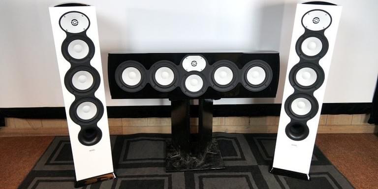

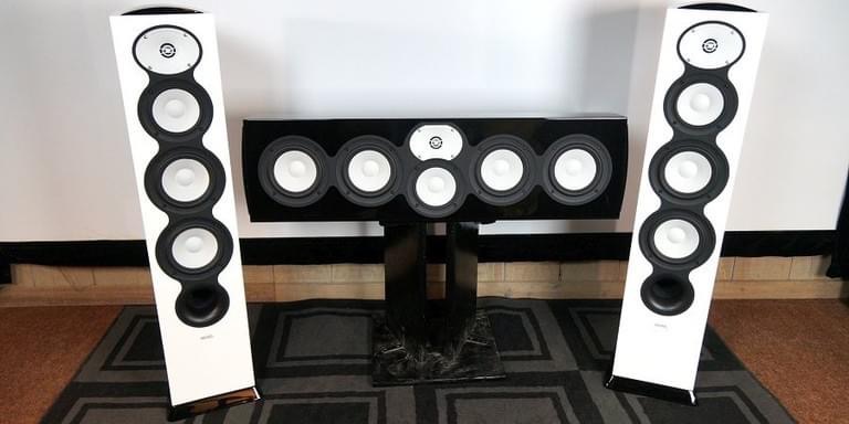

I was just looking at the Paradigm Premiere 600C, a nice big center, 3 way design, but I suspect with so many drivers it probably will have some issues potentially, so was looking for some measurements to see what the 0 to 30 degree SPL response across the range would be like.
Some 2.5 ways seem to measure ok, like some of the coaxial based ones such as KEF. But not a lot do this, so they're limited. And even less comprehensive measurements.
Very best,
Only 2 of those horizontal 6.5" ones are actual drivers. The outer ones are just passive bass radiators. Consider it a fancy-looking typical 3-way center.

Only 2 of those horizontal 6.5" ones are actual drivers. The outer ones are just passive bass raidators. Consider it a fancy-looking typical 3-way center.
Still, would really like to see some measurements for SPL at 0* and 30* degree ranges and linearity of response.
