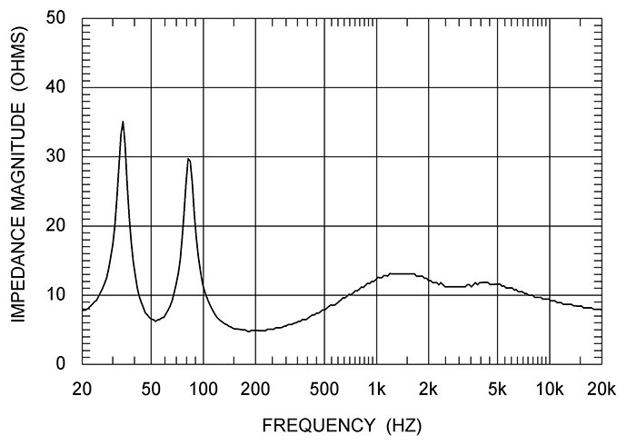

On SoundStageNetwork, Dynaudio Special Forty speakers come in with sensitivity at 83.6 dB averaged from 300 to 3,000 Hz. Their impedance low is roughly 5 or 6 ohms, similar to what Dynaudio claims. These Dynaudios are indeed power-hungry speakers.
Frequency response curve at 0°, 15 and 30° off-axis isn't bad. Unless that business between 500 and 800 Hz is audible noise.
That's consistent with Stereophile's, except the impedance dip to 4.9 ohm in JA's measurements, but the difference is still negligible, within the margin of error.

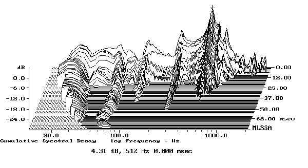

The Stereophile reviewer of these speakers also had this to say:
"… I listened to the enclosure's panels with a stethoscope. While the top panel was quiet, the sidewalls were afflicted with several resonant modes that affected the midrange. The amplitudes of these spurious vibrations were sufficiently high that I could hear them with the stethoscope placed on the center pillar of the Blu-Tack–coupled stand. The audibility of this behavior will depend on the size of the area of the cabinet panel affected, the relative phase of the radiation, and how well that area couples to the air. However, the touch of midrange congestion was something I'd first noticed from my listening chair."​
The Stereophile review's measurements also confirmed this in figures 3 and 4.
"However [in figure 3], the top panel had a low-level but sharply defined mode at 730Hz. More significant, I found a very strong mode at 512Hz on the sidewalls, with more, lower-level modes just below 300Hz and between 600 and 750Hz (fig.3). This behavior correlates with the problem I heard in my auditioning."​
Fig.3 Dynaudio Special Forty, cumulative spectral-decay plot calculated from output of accelerometer fastened to center of sidewall (MLS driving voltage to speaker, 7.55V; measurement bandwidth, 2kHz).

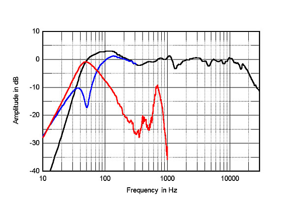

In Figure 4, another possible source of this noise was identified as the port tube and/or its opening.
"The port's output (red trace) peaks in textbook fashion between 30 and 100Hz, but its upper-frequency rolloff has a severe resonance spike at 700Hz. Fortunately, the port faces to the speaker's rear, which should reduce the audibility of this mode."​
Fig.4 Dynaudio Special Forty, anechoic response on tweeter axis at 50", averaged across 30° horizontal window and corrected for microphone response, with nearfield responses of: woofer (blue) and port (red),respectively plotted below 350Hz and 1kHz, and complex sum of nearfield responses plotted below 300Hz (black).

The anechoic room measurements were done SoundStageNetwork – only measurements, no review. Stereophile reviewed and measured these speakers. I quoted some of the reviewer's comments, but not this part:
"I tried placing a cloth bag of lead shot atop each speaker, and while this did reduce the cabinet talk a little, it destroyed the Special Fortys' beautiful appearance. I then tried AudioQuest Sorbothane pads instead of Blu-Tack between speakers and stands. If anything, the enclosures' vibrational behavior worsened, then further worsened when I returned the bags of lead shot to the speakers' tops. I then replaced each Sorbothane pad with a trio of upturned Black Diamond cones under each speaker. In theory this should have made things even worse, as it allows the resonances to be fully developed. However, I felt that the midrange congestion was reduced in level, perhaps because, with the speaker/stand interface now providing no damping, the Q (Quality factor) of the resonances was increased, meaning that each resonance covered a narrower range of frequencies. With the upturned cones there was also less energy coupled into the stand. All I can suggest is that if you buy Dynaudio Special Fortys, you experiment with different interface materials between the speakers and your stands."​
It seems logical to me that if something resonates, DAMPEN THE PANEL THAT'S RESONATING! It's the reason bracing is used.
The sentence that begins with "However, I felt..." is the reason I don't read reviews. I don't care how the reviewer feels, I want to know what they think, know and measured. The energy coupled to the stand would have been mitigated by pressing on the sides.
