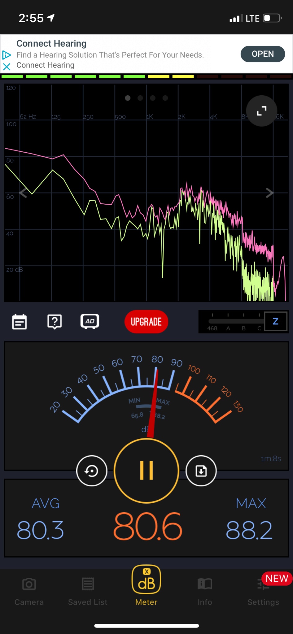

iPhone app, volume at 12 o’clock at sitting position, Metallica And Justice for All!!!

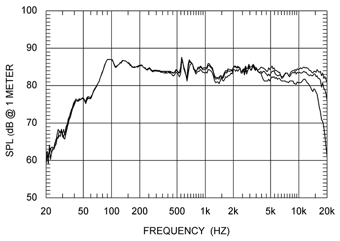

On SoundStageNetwork, Dynaudio Special Forty speakers come in with sensitivity at 83.6 dB averaged from 300 to 3,000 Hz. Their impedance low is roughly 5 or 6 ohms, similar to what Dynaudio claims. These Dynaudios are indeed power-hungry speakers.
Frequency response curve at 0°, 15 and 30° off-axis isn't bad. Unless that business between 500 and 800 Hz is audible noise.
Noise, from what?
I would guess that the stuff at ~550-750 is due to the placement in the room unless they were actually tested in a quasi-anechioc space.
