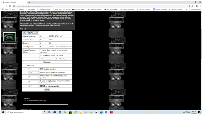

This SPL Calculator is a pretty neat tool. You enter your amp power, speaker sensitivity and distance and it will calculate the power you need to reach whatever spl you're trying to achieve.
Your 40 watt amp is a little lean on power, but depending on sensitivity it could be enough, tho I can see an argument for more power in your situation.
*Edit: I just punched your info in and it calculated 93+ dB at your listening position. That's at the end of your power, but it's also pretty loud.

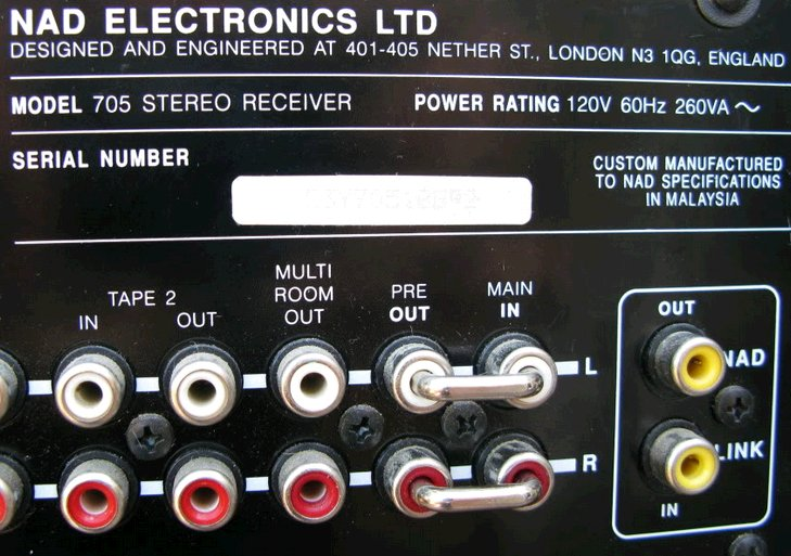

With your NAD 705, you are in luck. You can easily add an external 2-channel amp. See the Pre Out and Main In jacks below. If you pull out those links, you can use the NAD 705 as a pre-amp and an external amp to drive the speakers.

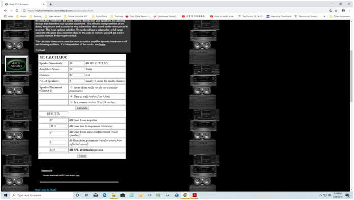

Screen shot below shows at 12 feet, 50 W should produce about 95 dB spl, so for media contents that have 20 dB of peaks, the "clean", unclipped average spl would be 75 dB. So the answer to his question should be "yes".

Also, you only entered one as the number of speakers and the result for two is 97.7dB. If he uses a good sub, 95dB is pretty loud. Without a sub, it won't have the impact, but should still sound very good.

The calculator I used, linked, does allow for room gain, if you read the fine print.
I used to enter 2 speakers too for stereo and 7 for 7.1 etc, until I was corrected, by @yepimonfire if I remember right, or someone else if not him, that by THX standard, the 85 dB average, 105 dB peak thing was based on "each speaker", i.e. one at a time. We don't have to agree on the merit obviously as it is just a standard. In fact, personally I would agree with you on this.
