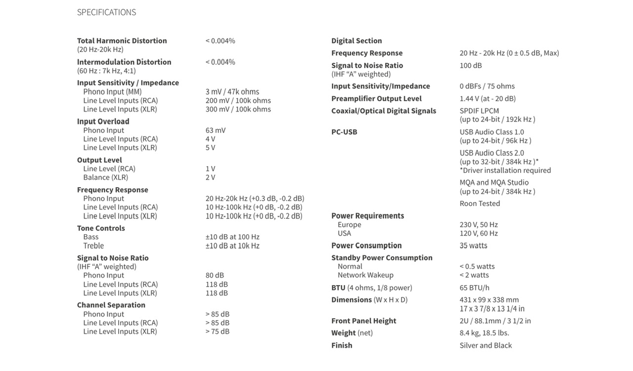

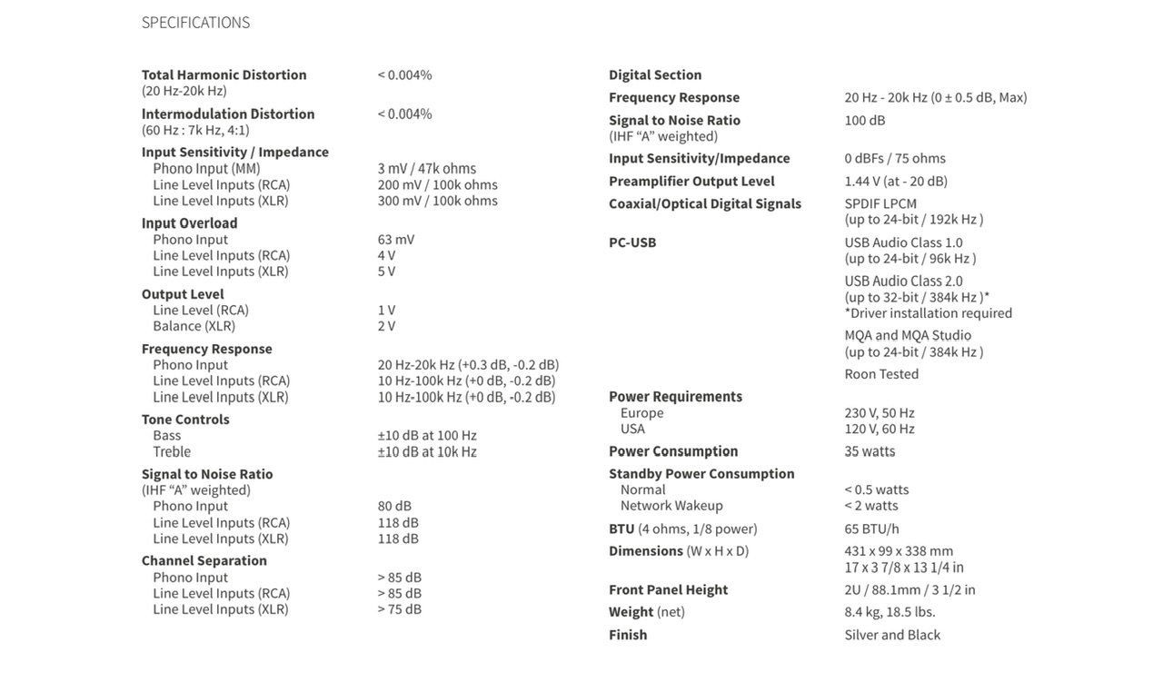

Bobby Bass.. What is the voltage output sensitivity on your sound processor or avr to the Rotel? I was looking into that amp for awhile. The only thing that has me question it is the lack of a gain knob and the high Voltage input sensitivity. But maybe those are small things. The Parasound A23+ input sensitivity was a closer match to my AVR as well as its warmth and gain of 29db as well as a gain knob. They are both priced about the same with toroidal transformers. That Rotel looks so badass though :)
Rotel RC-1572 MKII is the preamp into the Rotel amp. Here are the preamp specs.
Keep in mind the nominal pre-out voltage level isn't particularly what the avr is capable of. Marantz regularly measures 2V from what I remember. Back to the editor app, a slight downward tilt of a house curve for the higher frequencies could be implemented for perception of "warmth". It's worth trying....
