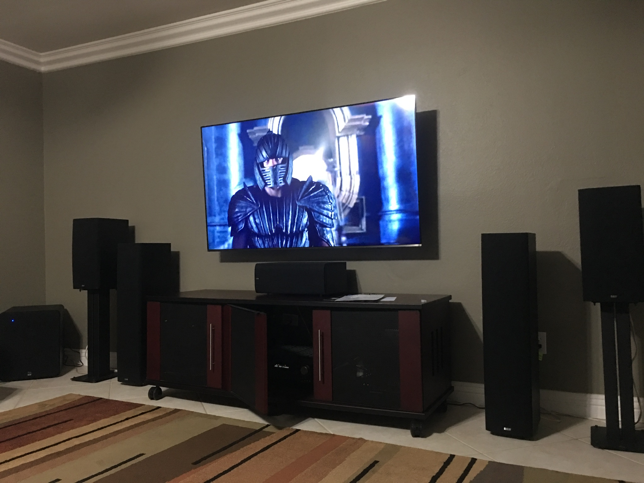

This is my setup. All of my speakers are on the front wall, I sit ~ 10 feet away. Recently retired. I will add a new receiver or amp and another SVS p-1000 and I am done.
I can’t afford a mistake. Thanks.

Why do you have surrounds on the front wall?
I went from 90/10 HT/ music to 30/70.
Wife says I purchased the speakers in 2005, if I were buying today I would buy l/c/r and 1 or 2 subs. Music had always been my first love.
Recently retired, since I started reading this forum I am getting great sound out of my system. Fifty percent of the time I listen in Pure Audio mode.
Probably doesn’t make sense but...

What mode do you run the surrounds in? As regular surrounds or front wides or heights? Pure audio mode would only get you 2.0 for most music, tho.

I just play with it all day. My favorite is Dolby PL IIx, of the Onkyo modes I like orchestra, or all channel stereo, then the Pure Audio mode.
I like to call it my “ solid wall of sound” Bennie and the Jets
So you just use the surrounds hooked up to the normal surround terminals? No way to put them in proper positions?
Yes and yes, I actually thought about hooking up my Klipsch to the rear surrounds to hear all seven channels playing music.
I wouldn't bother with the surrounds up front myself, would just go LCR/sub. You can't place them properly due WAF?

No, I had them in 5.1 configuration until late last year. Wife actually loves movies and never had a problem with that stup.
You had them in a normal 5.1 setup before? I'm just trying to understand why you don't have them properly positioned.....

I am just enjoying this right now. I’ll probably get bored and change it back in a few months. Or I might go down the two channel rabbit hole.

True! I won’t be replacing the B&W’s but if I can upgrade the Onkyo Integra AVR or add an amplifier that will noticeably improve the sound I will.
I also have an Onkyo 610 / Klipsch playing two channels in another room.

Consider that your current AVR isn't performing to your needs, so it has some performance limitations. Some of these could be design related and may extend to the preamp, which means that an additional amp may not give you exactly what you're looking for. It also adds another layer of complexity and balancing issues.
It's often best to have a clear goal in mind then choose the simplest and most direct means to achieve that goal.

You have a full set of pre-outs on the 6.5 so you have the option of external amp, but I doubt it will noticeably improve the sound except perhaps at higher listening levels...depending on the external amp you choose of course.

Me too...
To each his own?
I think if OO is gonna use them, IMO the configuration should be pliiz not pliix.
