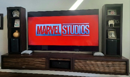

Attached is a picture of the current set up just to show the ideal space I'd like to fit in.
Although most would describe my room as challenging, I find that in general I'm pretty satisfied with the sound quality as is. I'm hoping that upgrading the center and fronts is going to significantly include the listening experience. If not why drop a few grand :).

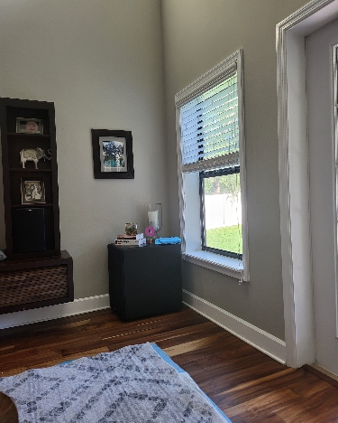

Photo of terrible sub placement
Sent from my SM-F926U1 using Tapatalk

Actually placing subs in a corner is very common, all good. I think you can get stands that are attractive, maybe in maple or oak to match the wood motif. Out into the room would only be 12 inches or so way from your back wall +/-. Ideally the tweeters of your left, right AND center channel are all level with your head/ear as you are seated in the MLP. With 2 HSU subs I don't know why you would need towers. Here is an example:
and for your CC
That is not necessarily bad subwoofer placement. It's probably OK.
Given the space constrictions for the center speaker, you might be stuck there. There might not be any upgrades that are major since you can't accommodate a larger center.

For the center I may float it above the TV.
Verdinut
Verdinut
Using a bookshelf speaker on each side of the TV with the tweeters at same level as that of the towers would be a much better solution.

Regardless of the speakers you use they will still need to be placed in the proper locations. I don't think sitting inside that cabinet will get you the best sound. You should get stands first.
