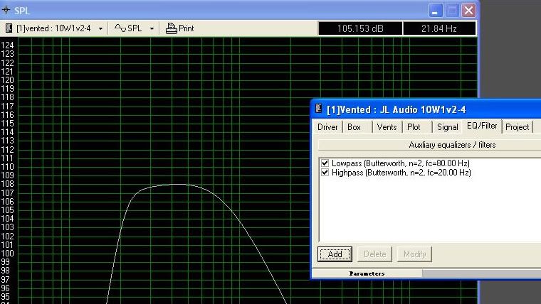

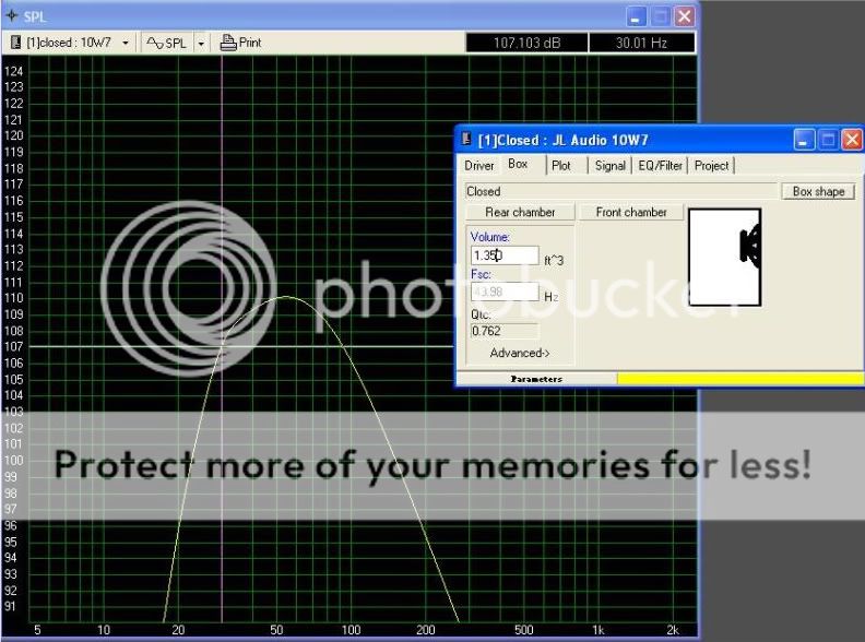

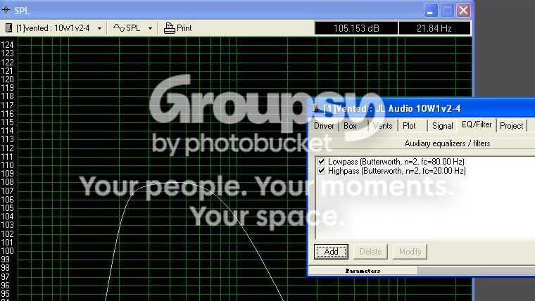

A 10W7 in a sealed enclosure of 1.35ft^3 net volume could be done with a 13 x 13 x 22 enclosure that would allow for .2ft^3 for displacement. Using a small bit of parametric eq would net an anechoic f3 of 30hz.
This response uses a lowpass x-over of 80hz 2nd order and an infrasonic filter 4th order at 20hz and +3.0db eq at 30hz with a 'Q' of 2.0. This keeps the max excursion withing the xmax +10% range (below any audible distortion level). This is all very easily achieved with a DCX2496.
Your in room response will be easily usable down to 20hz. My in room response is usable to 15hz with my 12W7.
As you can see below, it would be +/-3db from 30hz-90hz with minimum 107db output capability (anechoic). In-room would be at least +3db higher or more.

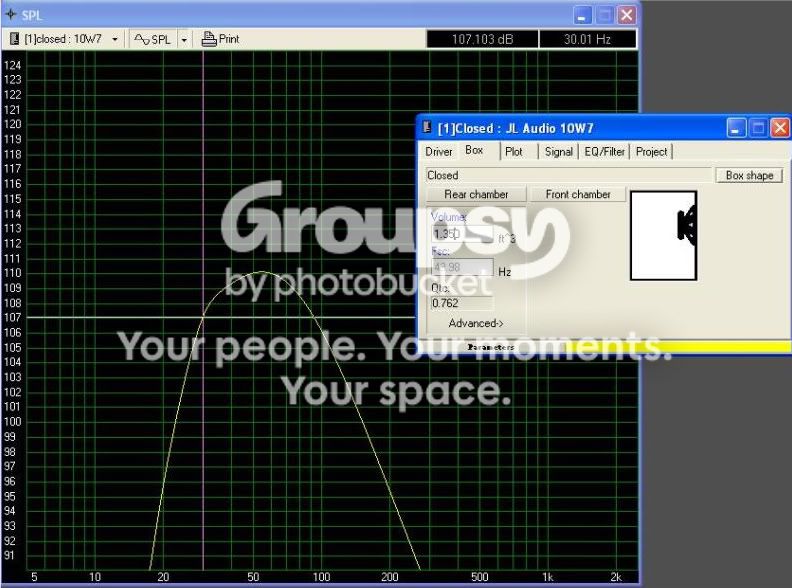

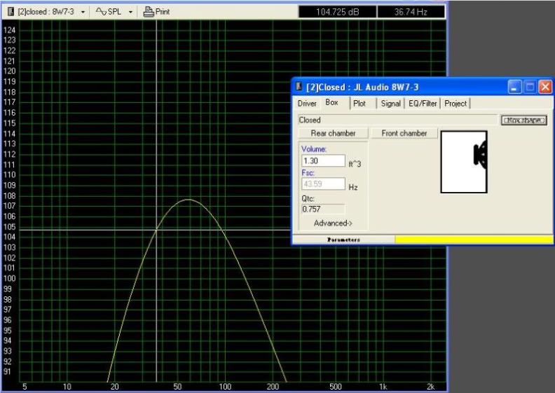

Let me talk to my guy at the local JL dealer. I will see what I can get a 10W7 for and you could pay the shipping with the exact cost of the driver. He usually hooks me up pretty well.
Here is the response in a 1.3ft^3 sealed enclosure (you could keep the same suggested dimensions of the 10W7 enclosure. Native +/-3db response is from 36.74hz - 95hz at 104.7db or more anechoic. This includes using a 20hz high-pass filter 2nd order or higher with 500 watts rms.

I installed WinISD Pro 0.50a7, to see if I could understand how to use it, but it's not working for me. I keep getting error messages like "floating point division by zero" and "invalid floating point operation". Is there a bug in this program, or might it not have installed properly?
36.74 Hz for the 8W7 in that sealed enclosure seems a bit high - what could I expect in-room to be? Can you get prices for both the 8W7 and the 10W7? If I were to go with either, I can forget the DCX, as the budget would be busted.
