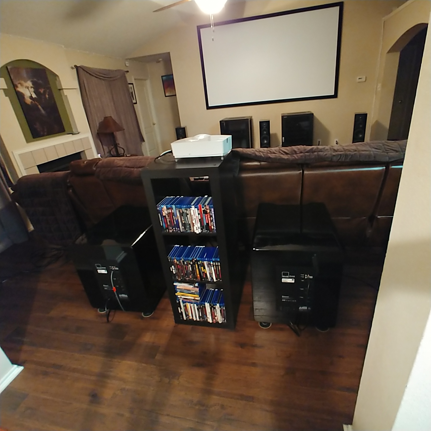

Also to the OP, some say this doesn't matter but after owning both front and down firing subs, I would pick front firing any day in a small room. I think you feel the bass more. It's hard to explain but there something about near field bass that is awesome. There another member here @Danzilla31, has a PB-4000 right behind his seat o_O.
I have a similar shaped room and I can tell you if you place both subs next to the TV a lot of the bass will get throw over to the kitchen area, which creates a whole other problem. Even, if you get two subs, I think you'll find that the bass is heavier on the left side of the room than the right side. Beware, if the bass does not sound good out of the box your gonna have to spend some time and really fiddle with sub placement. I actually had to re-arrange my entire room based around my new subs.

Ooooooo, that 4000 is a thing of dreams, but for now I have to fit the budget:rolleyes:. I'll def be doing a base crawl when I get them, look forward to playing w the miniDSP in the future. It's funny, the sub I have next to the TV def throws bass into the kitchen, I keep having to space my bar/wine glasses out so that they don't vibrate and make noise:p.

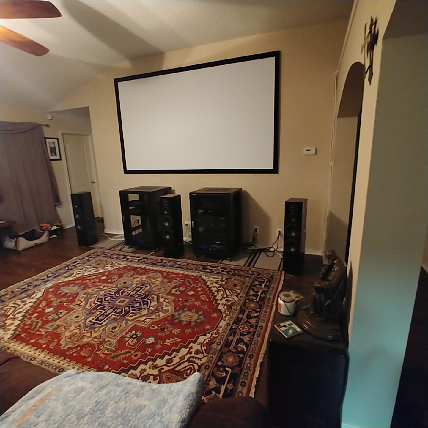

Ha! Man, these klipsch 8000's are freakin' 5ft tall. Have to hike my TV waaay up :oops:

Hey rumy are those atmos modules on top of the 8000’s? Are they active? Looks like they might give better performance if the backs were propped up a little, aiming them more toward the couch. Seems like the sound would land on your feet when stretched out chillin. Just an observation...

You are 100% correct. Just got them, that's the only reason they're on top of the floors. My plan is to mount them on the wall

Of course! My livingroom is 28x12 and then it "L's" into the kitchen, which also extends into a game room, probably 45x15 (kitchen and gameroom combined, it's like a bowling alley). Also, as you can see in the pics, the other side opens up towards my front door.

Ok, thanks for that. You don't need to try to pressurize all of that, but those LF Soundwaves are going to do everything they can to squiggle through every opening possible. If that open area is correct, you've got yourself an enormous space around 8000'3. Given the size, I would shoot for the ported option. I understand the ULS 15 has good output for a sealed sub, but you are going to need bring it hard to put the bass where you want it. VTF3 or VTF15 all the way is my vote. :)
