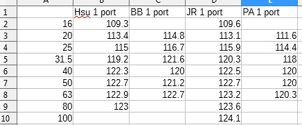

I'd like to see overlays of the various measurements to illustrate some of this...fwiw.
For an example of this, look at the original Hsu VTF15h reviews. There are four different CEA-2010 sets of the same sub: Paul Apollonio, Hsu Research, Josh Ricci, Brent Butterworth. Brent even wrote an article about the differences that are possible even when using this same protocol here.
If you want to really compare CEA-2010 data, you have to know more about how the measurements were captured than just what is specified in the protocol. You need to know what software is being used, sound interface, weather conditions, background noise, and other factors. I have been toying with the idea of writing a short article that explains some of this sometime this year, but I have a lot of other projects I want to do as well.

Yes, the overlay should be at least on as equal a basis as possible...but it may not be possible. Just a better way to visualize....
Here is a bit from a spreadsheet that compares various the VTF15h measurements by the way, if you wanted to input those values into some graphing software.

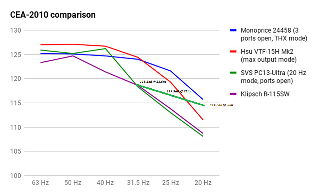

OT, but the way the $900 Klipsch R-115SW matches the low end of the $1700 SVS PC13-Ultra is shocking!!!
its confusing because in this review https://www.soundandvision.com/content/test-report-svs-pc-13-ultra-subwoofer-page-4
he measured the pc13 at
  • 20 Hz 114.6 dB L
  • 25 Hz 117.5 dB L
  • 31.5 Hz 118.3 dB L
and in this review https://hometheaterreview.com/klipsch-r-115sw-subwoofer-reviewed/?page=2
he measured the Klipsch R-115SW at
*20hz 108.7dB
*25hz 113.8dB
*31.5hz 118.6dB
Unless I'm confusing 2m/rms with 1m/peak or whatever?
It's just very unusual to see a ported SVS subwoofer drop off 10dB between 31.5hz and 20hz like is pictured in the graph - let alone the near 20dB drop from 40hz to 20hz, they tend to be flat to tune point normally

jamiebosco
I've edited the graph to show what I think Brents PC13 Ultra measurements should look like in graph form (if I'm reading it correctly)
Please let me know if I'm misreading or misinterpreting the data
That looks correct.
One thing about the PC13-Ultra is that it would be a tough subwoofer to measure and get a fine sense of its broader performance. The reason why is because anywhere you place the microphone with respect to a sub like that, you can't help but to skewer its measured performance, since the driver and ports are on opposite ends of a long subwoofer. If you place the mic facing the driver, that puts the deep bass generated by the ports at a disadvantage. If you place the mic facing the ports, that puts the upper range bass generated by the cone at a disadvantage. What Brent did for that review was to place the mic equidistant from the ports and cone, by which I am presuming he placed the mic to be facing the side of the sub. The problem with this is that the upper bass from the cone is a lot more directional than the deeper bass from the ports.
One solution to this is to place the mic way far away from the subwoofer so that the difference in distance between cone and port no longer matter, but you need a very quiet location to do that in because background noise will be a lot more significant in a testing condition like that.
