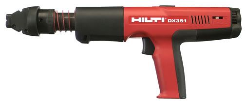

I'm not that kind of carpenter.
I'm pretty sure my deal is a result from shooting Hiltis into steel.
Edit: This is not a drill. :rolleyes:
It shoots nails like bullets. It takes a .27 caliber shot. :p

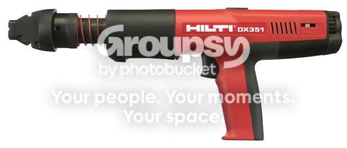

With no hearing protection? That's an OSHA violation.
