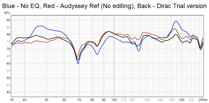

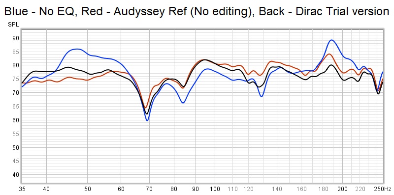

I just REW'ed my two channel system yesterday after playing around with DL:

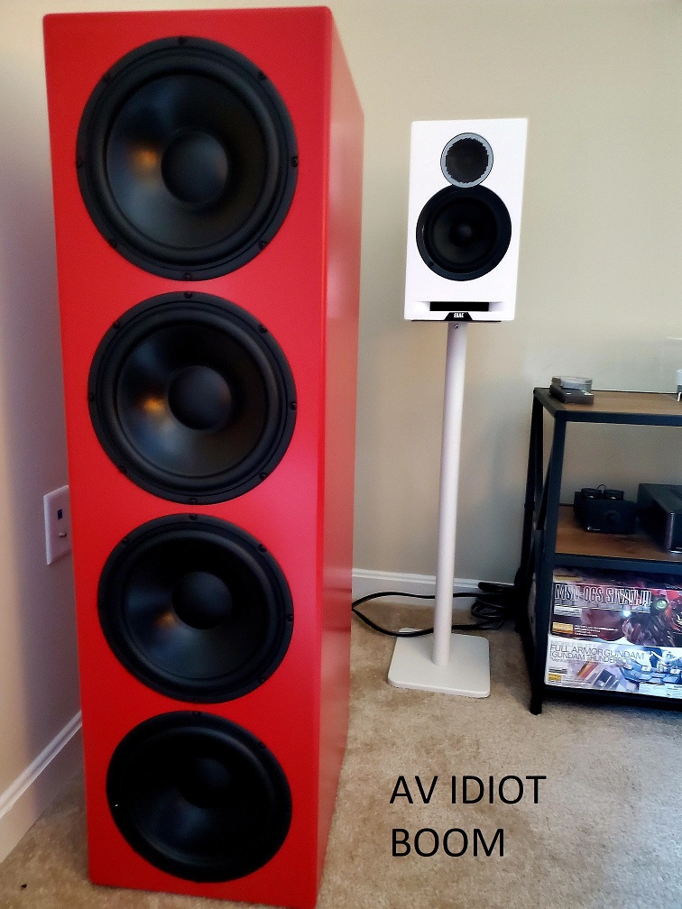

If ADTG's gigantic RBH and his room has a suck out like that, I bet he would be screaming ?!!!!#$^(*)!!.
Even if he has the top end Trinnov REQ (that he won't use), it wouldn't help him enough.:D:D But I guess he his room is excellent acoustically speaking, by design or by chance.
In my other system (LS50), you can see the opposite. REQ took most of the impressive bass due to room gain away, but no big suck outs so guys like ADTG (sorry, not picking on you, but need a good example:)) would be happy.

It seems like Audyssey did a “better job” than Dirac in this measurement.
They both did a “better job” than no-EQ.
But I am not sure either one actually sounds any better than no-EQ. :D

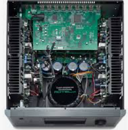

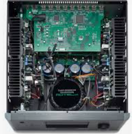

Don't know if Yamaha is Superior, I wouldn't say, better than some but not superior. I'd would love to get my hands on that Rotel AV-R. But at 5600 bucks won't happen for me anyways. I'd say the amp section is Superior :D in that Rotel than anything that Denon, Yamaha or any other AVR on the market right now unless I miss one or two. I mean just look how delicious that thing is!!
