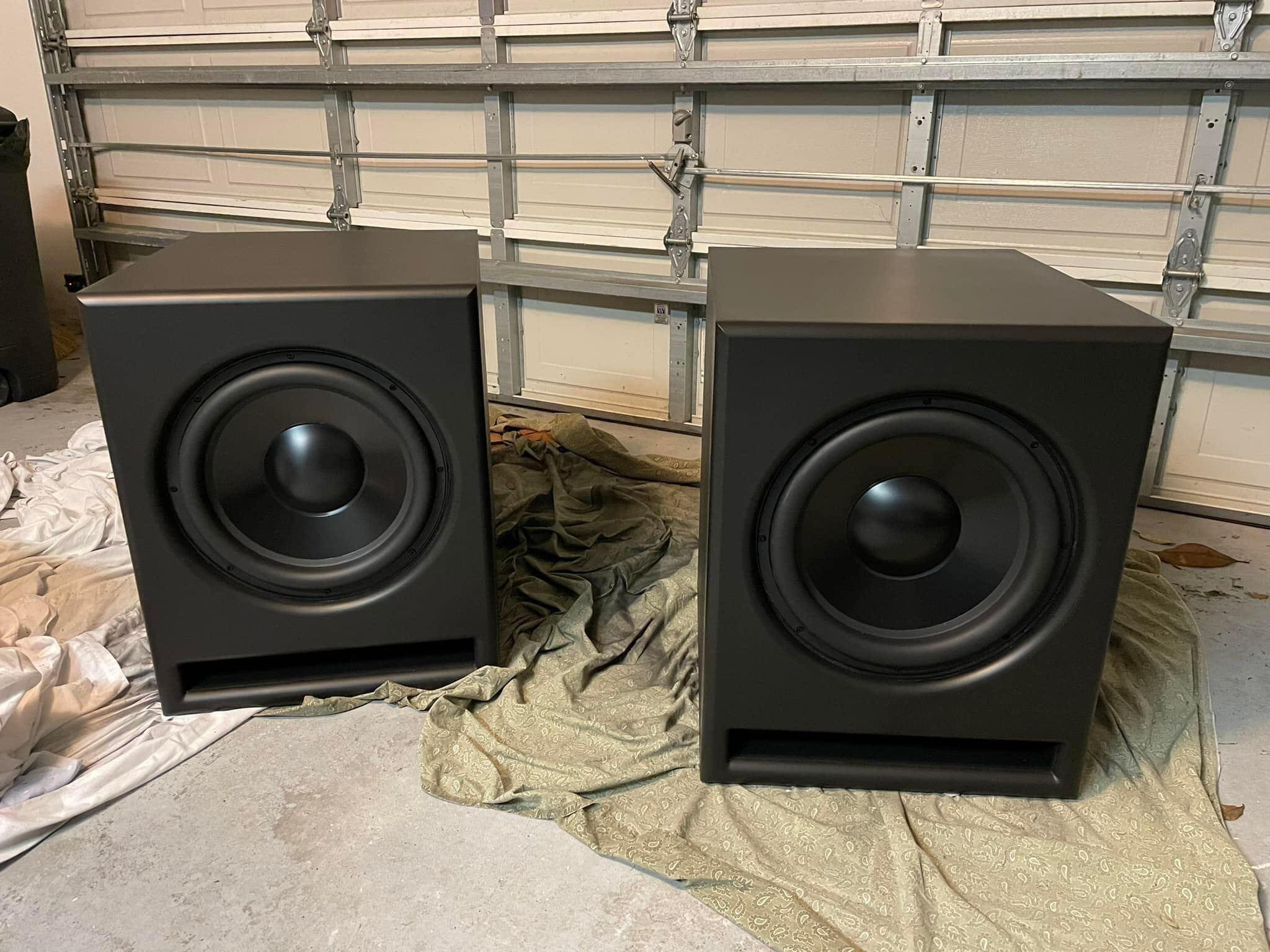

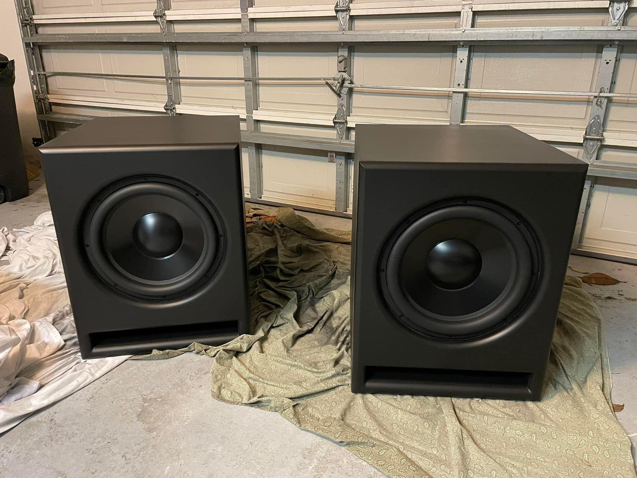

Nailed it..but the 390HO or new 390HE-22

Excellent choice on the PH speakers... A BMR Monitor build is on my very short list (enclosures secured already) but I'd even consider Jim's work over at Salk a value (push come to shove) plus his finish is 2nd to none.
Sounds like youre no stranger to the DIY/AIY community, basic hand tools & some common sense regarding their usage. It would also seem you're no stranger to most platforms/groups & forums so I likely don't need to introduce myself...
If you look at a general 'Subwoofer cone surface area chart' you'll find neat little bits of information about multiple driver comps. Example, (2x) 10" drivers have a combined SA of 157", (2x) 12" drivers combined equal 226" (+-)… With that in mind a single 18" driver is still greater at 255" (single 15" is 176") & from an integration, time alignment, phase & 'insert all the buzzwords' will perform better. But do you have the space for them? Lots of required information missing here pertaining to the room & dimensions!?!?
Let's look at some of 'What you've been looking at' plus a few... Research for the 'Audiophile on a budget' IMO should be limited to Power Sound Audio, HSU, Rythmik, SVS, Monolith & sure RSL otherwise everyone would have JTR, Seaton, DSS & the likes. Some of those represent better values than others.. heck, in some cases you can get two subs for the price of one or more!
Whats your integration plan? What are you using for associated gear... Specifically the Integrated/Processor? Will you be using a MiniDSP or looking to use Speaker level terminals?
"I've always built my own subs but for huge, loud, deep and ferocious home theater bass. Never smaller boxes just for tight, chest thumping music. Plus the cost difference between buying something like a 12" ported box vs making your own has a smaller value proposition so I build big."
Sometimes all it takes to change the above is a change in drivers (& not a wallet crushing one)..
Example... This plot shows a Lavoce 18" pro driver vs the ever popular Dayton UM18-22 & what you're seeing is a healthy jump in the Mid (chest kick) thats desired.. Sure, you lose a little (so little) on the bottom end because you high pass these at 19hz but the gain where you want it for Audio is significant.
I'll pause for some feedback but I think you can do better than dual Monolith 10's.
