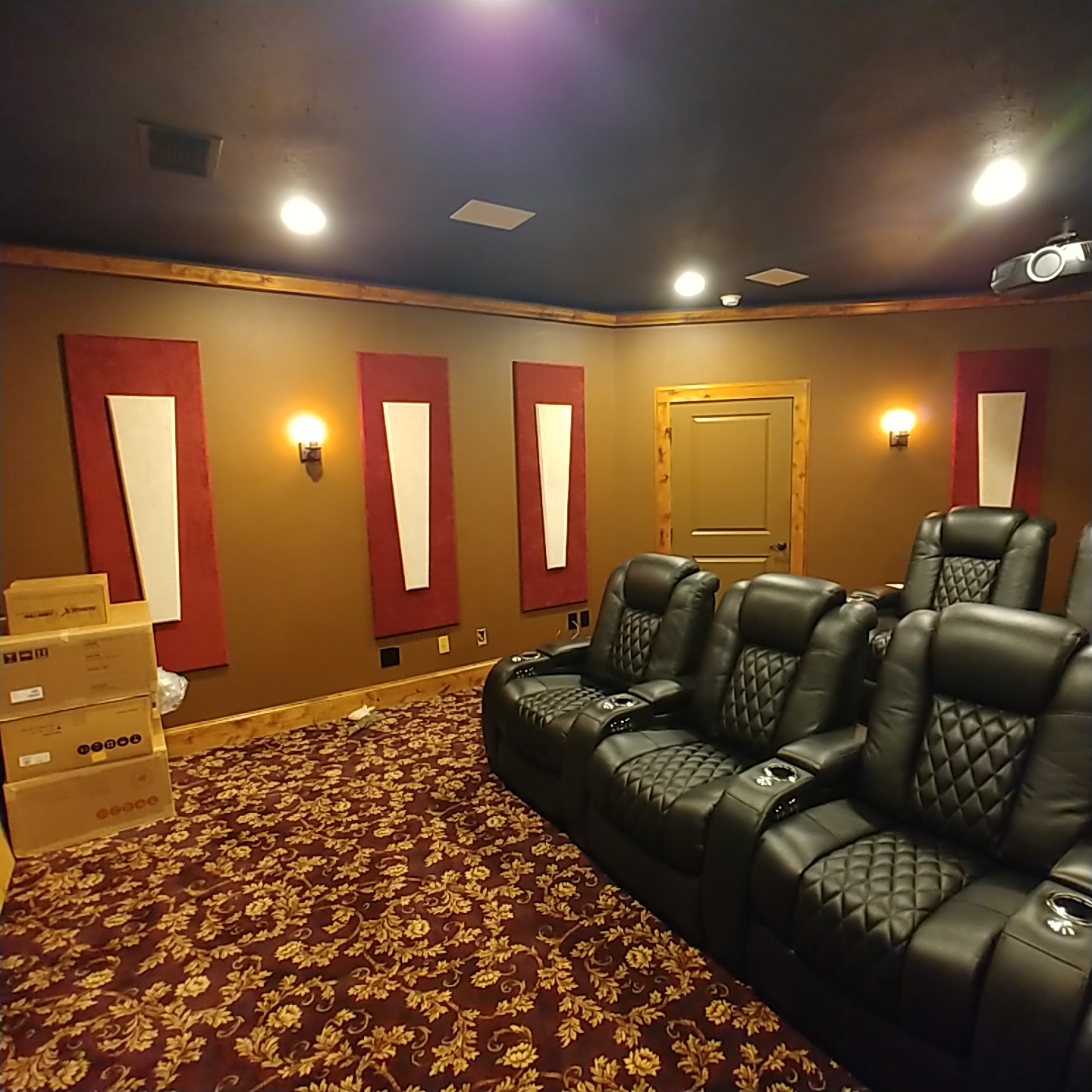

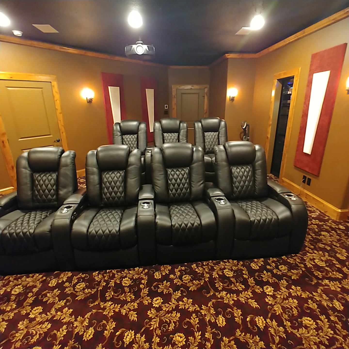

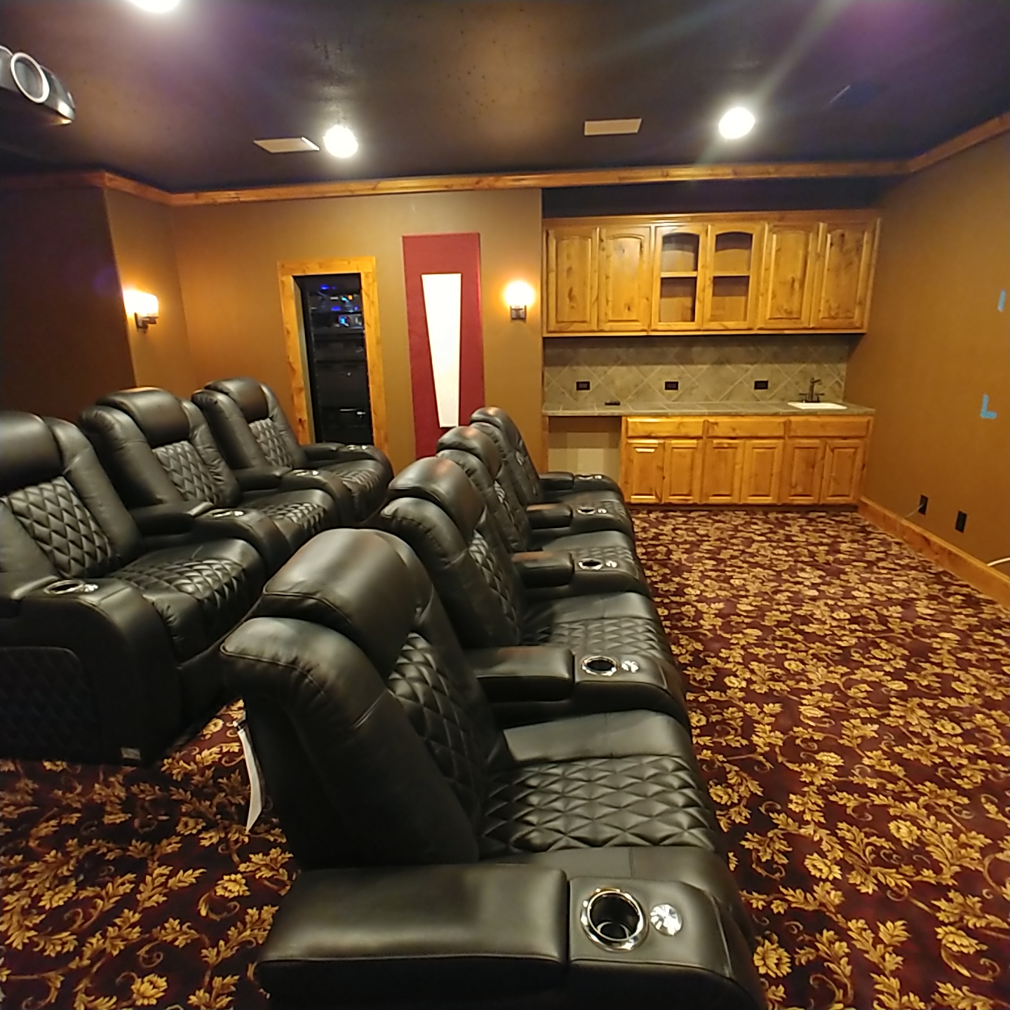

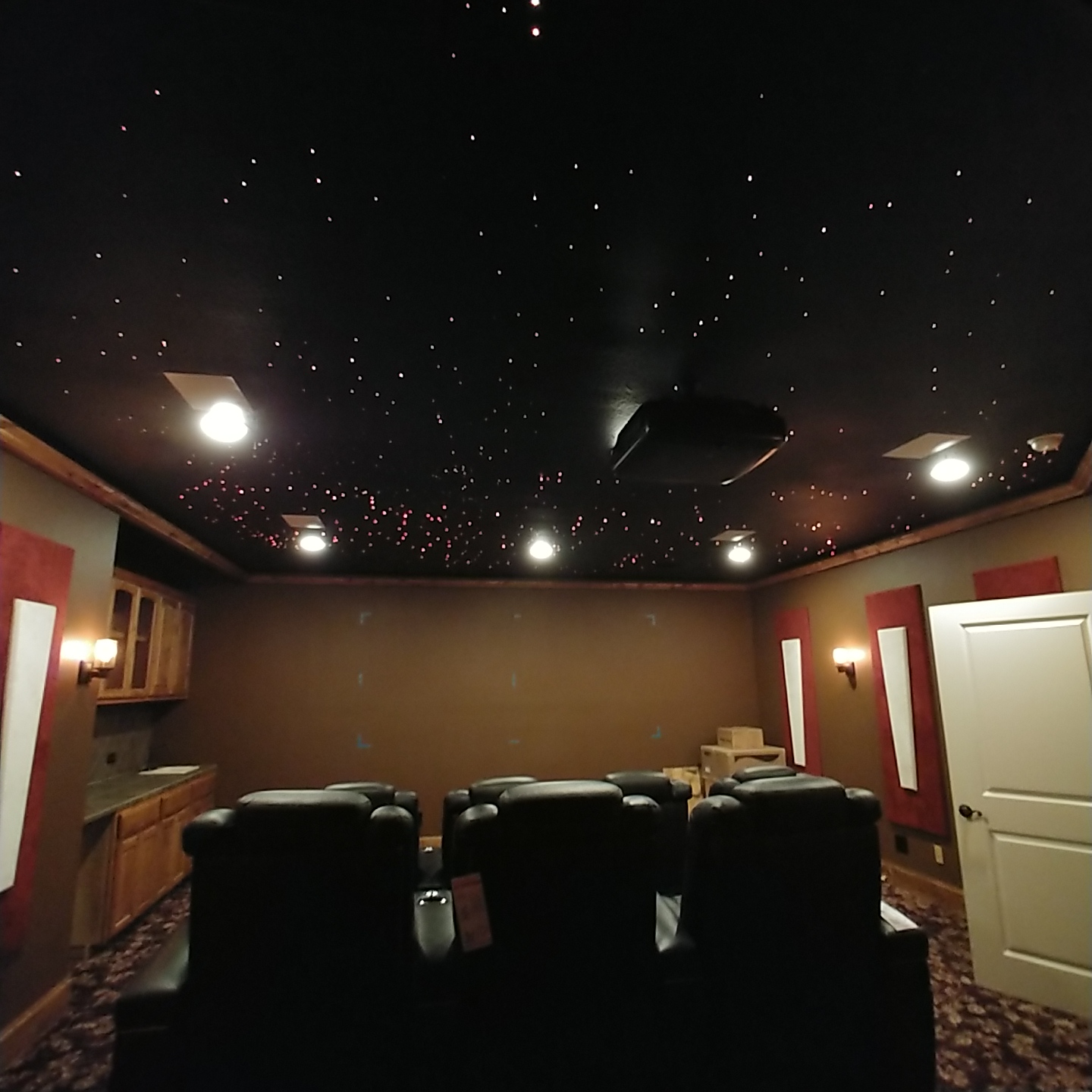

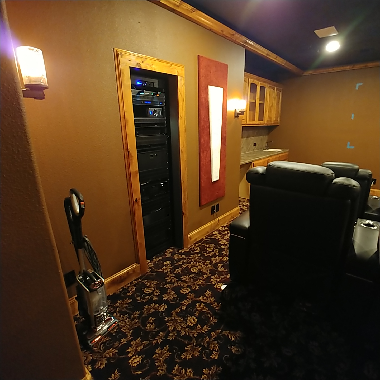

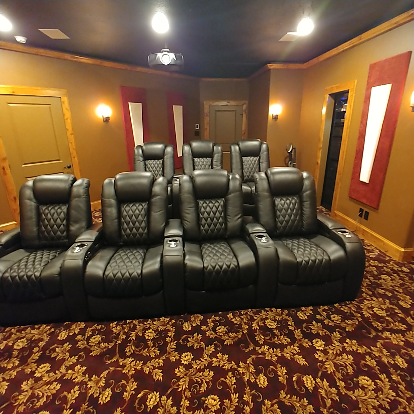

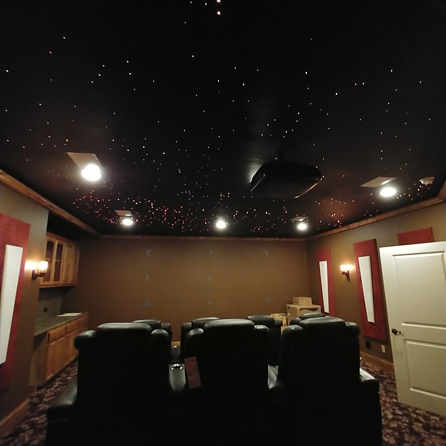

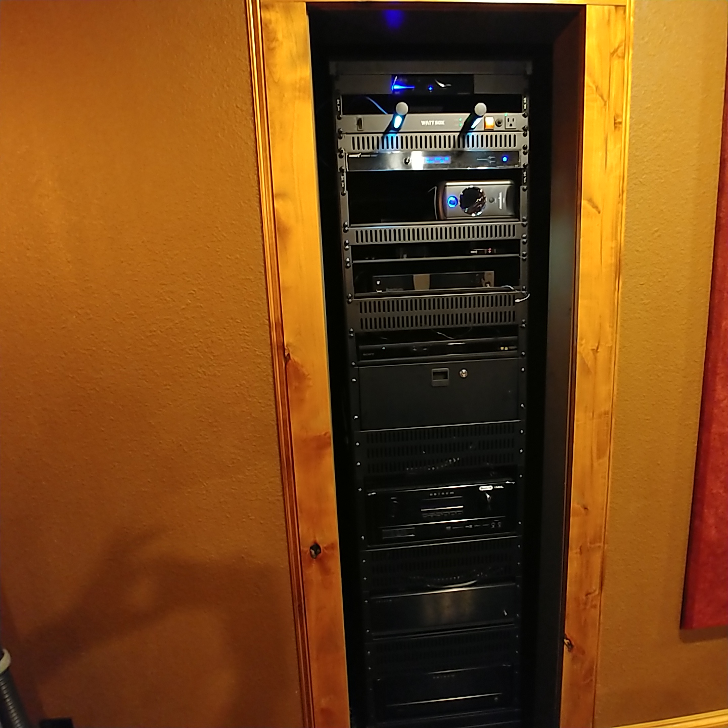

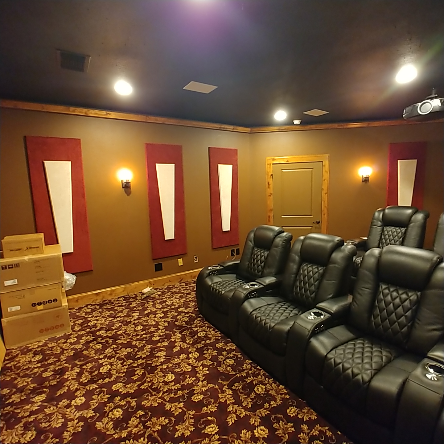

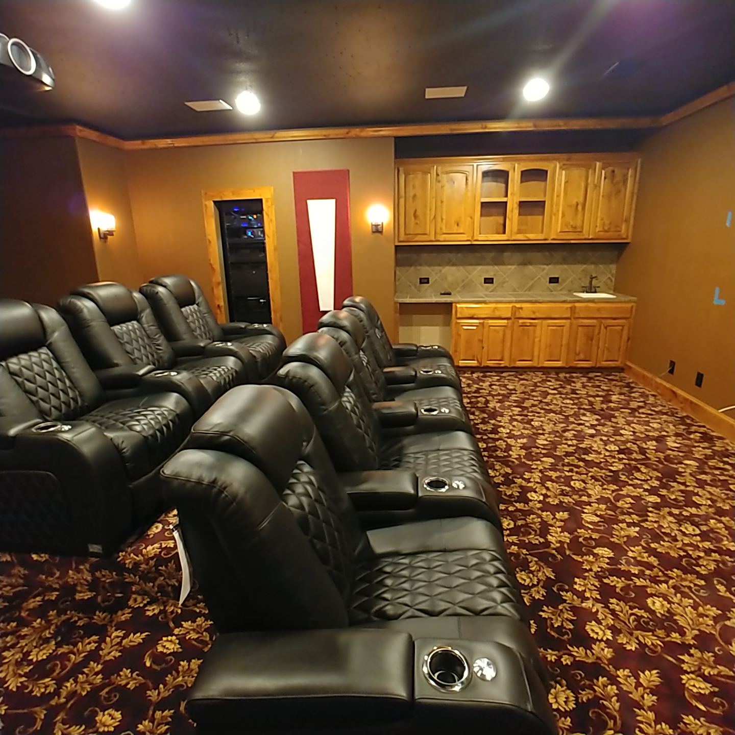

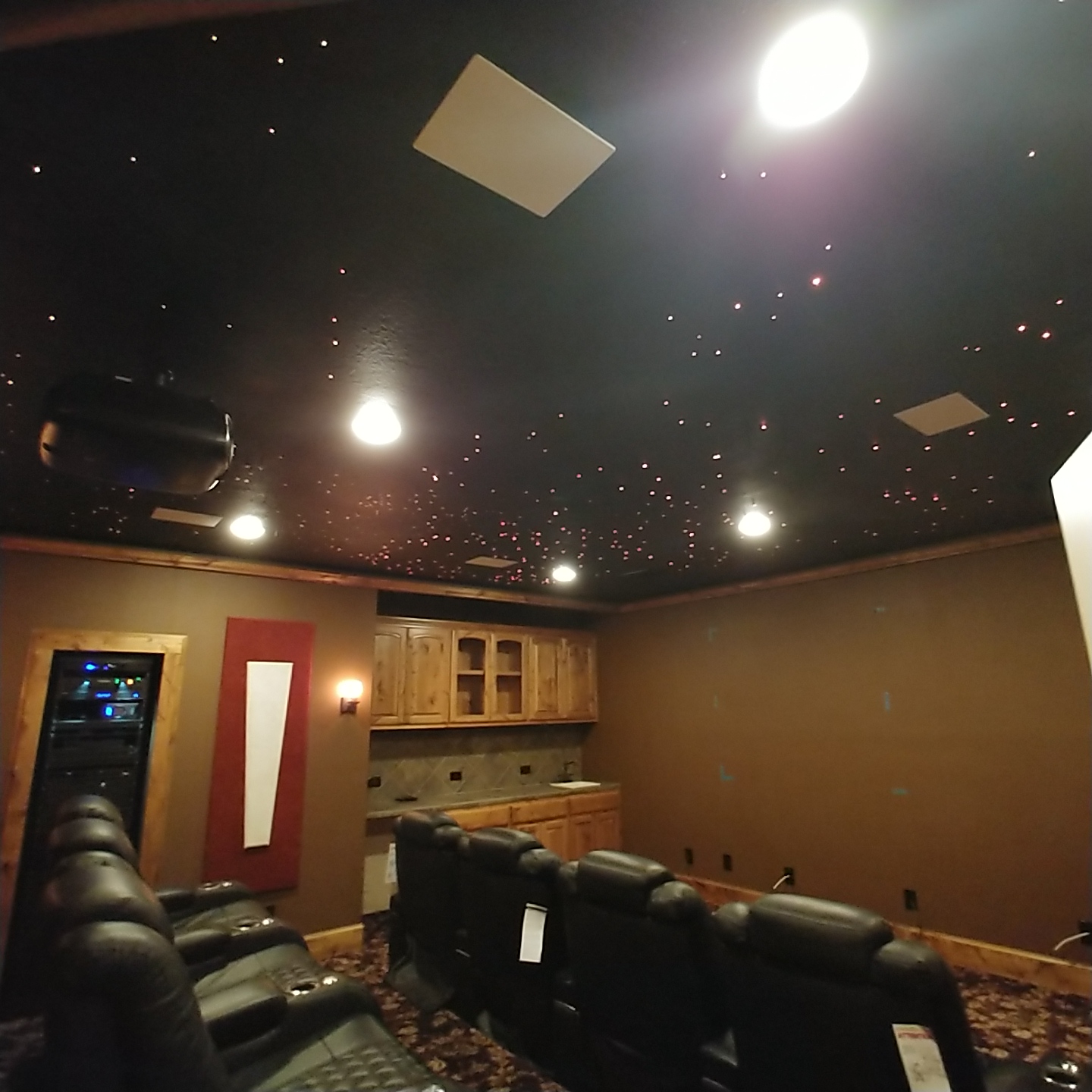

Ok all electrical lighting ceiling and pre wiring is done starting tommorow will begin the actual equipment getting installed
Here's a few pics of the final build next time I post it should be with the theater setup and running
