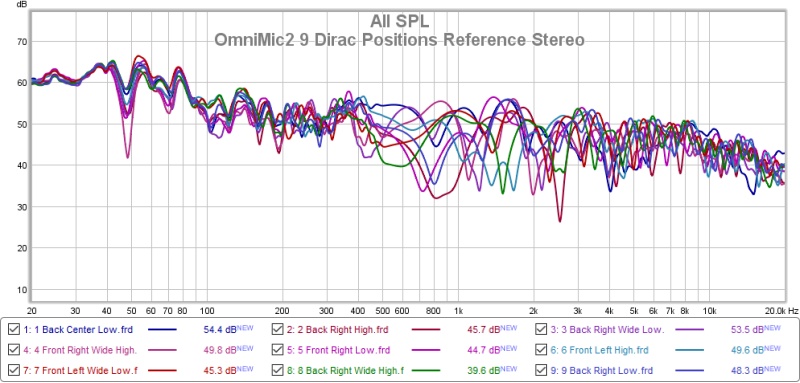

Here are the Salon2 measurements taken without processing on the 9 positions recommended by Dirac:

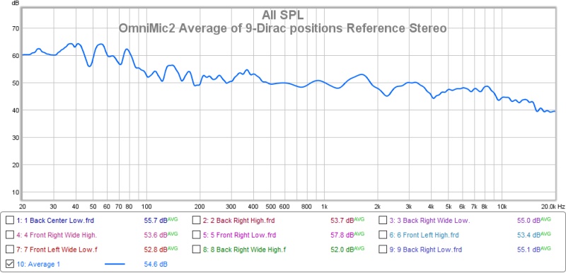

Here are the measurements averaged together:

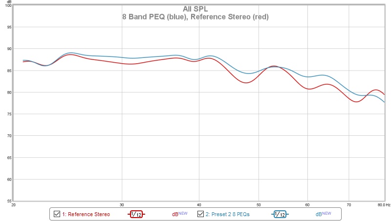

Here is the improvement by manually using PEQ filters and REW measurements for below 80Hz:
The top graph was utterly convincing to me that folly of applying equalization to a well made speaker above Schroeder Frequency. At 400Hz and above the mic positions (all within 3 feet) are all over the place which make sense when you consider that the wave length. If you have ever used a mic, you will soon realize how even with low frequencies, small movements in the position can cause large changes in the measured response.
According to Revel, you REQ/PEQ should be used to address room modes and not to correct above that as it has a negative affect on a well designed speaker.
