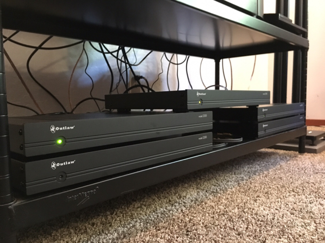

@ryanosaur , how are these working out for you?
I believe you have posted a photo, but I can't remember ... do you have all 5 stacked? Do they stay cool?
I have stacked a pair without any temperature concerns, but I was wondering about 5, if you've tried it!

They are great. Zero complaints to voice. Considering I rarely come close to taxing them (in all likelihood), they do what I want and do it well.
I do not have them stacked 5 high, rather two double stacks for Left and Right side Front and Surround, with the Center Channel Amp straddling the two. They stay much cooler than the AVR does... after some good sessions, they are slightly war, but not alarmingly so... definitely not hot. Additional cooling is not even a thought with them. :)

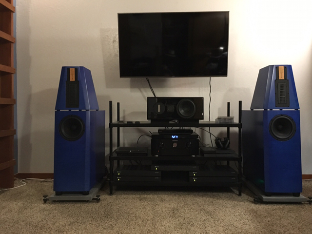

From back in late December:
And when I was first setting up the 3s end of May.
I have 3 stacked....no issues so far.
Sent from a handheld device using a silly little app.
Very nice Ryan! That stack of 5 looks pretty cool. I'll bet those Phils put a smile on your face every day.
You need a bigger screen, that's too much audio and not enough video.
