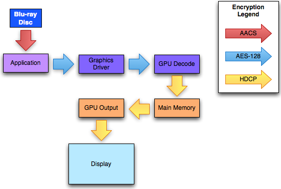

O.k, I will explain it then here as I can't edit it into the guide:
Protected Audio/Video Path
When the Blu Ray or HD-DVD is played, the content is encrypted with AACS so you can't just copy it. When that is decrypted by the software player it is essentially unprotected sitting in the main memory, so it is re-encrypted with AES and decoded by the graphics card so that the HDCP protection can take over.
The problem is that the graphics card can understand the video portion of the AES and decrypt it, but not the audio, so you are stuck with lossy CD quality audio. There are no graphics cards at the moment that can decode it either, so you need the Xonar and do it as I showed above or be stuck with lossy audio.
Hope that clears that point up, thanks for raising it.:)
