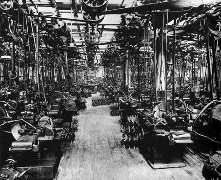

Nice!
I look forward to seeing the mechanism!
The two you showing dropping looked to be in sync, so I like to fancy it might look a little like an old (usually driven by a water wheel) machine shop with a central drive shaft running from front to back :cool:(except you have drums on the shaft and cables instead of belts) with pulleys on either side for the drop-downs! But then, modern electronics probably allow you to use separate drives for each speaker and still keep them all in sync.
How much clearance do you have between the ceiling and the floor above, and why?
Unfortunately standard stick-frame homes only have 6"-8" or so in this space, but I could see sacrificing a tray ceiling to audio.
It would be nice if you could get a beveled self-aligning system so they nest into tighter clearance.
A quick and cheap (but not as effective) approach to reducing the contrast between the black gaps and light colored ceiling would be to install light colored brush seals/sweeps on the ceiling panels to fill the gap. The brush has the flex to accommodate misalignment, but puts some pressure in areas of interference so as to be aid alignment:

I expect the easiest / less costly way to synchronise them would be to use a Line Shaft type configuration. You could use a single motor / clutch system with limit switches on the cables to turn off the motor. I guess it's easier to wait on the explanation than speculate on how Graig did it.

LOL. That picture is awesome and hilarious. It feels like thats the equivalent effort I put in!
Your description of how it works is quite accurate in general. I will ultimately show everything. I will say again that the speaker cable itself was the most complicated part. I considered but did not use a cheap spool with contact system (company: Stage Ninja) and am proud to say that the cable is a single unbroken length from amp output to speaker input. I say cheap because the sliding contact in that sort of thing is a weak link that will eventually wear out.
My system uses 1/16 stainless steel wire cable with 3/32 vinyl coating. The cable runs the length of the joist channel to strategically placed and sized pulleys. The "drive" is at the other end of the channel and does use an "axle" with the cable wound on hubs, though I originally planned to use a worm drive track actuator (Firgelli Automations). But, nobody makes a track actuator that is long enough without getting insanely expensive. So i used...."something else" (wont say yet, but it is quite clever)
