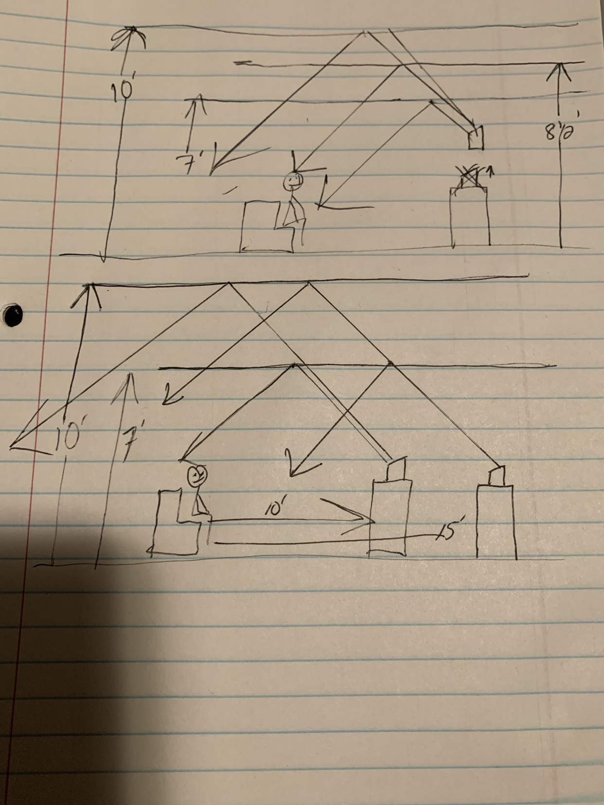

From what I’ve seen, those have to be very careful installed to accurately hit the proper angles to beam to the LP. For example if your ceiling is taller they might have to be a couple feet above the mains rather than on top of them. Or the angle has to be steeper. If the ceiling is too high Think of a bank shot in pool from the speaker to your ears.
If you can forgive(and understand) my cave man drawing, you’ll see how changing the height of the ceiling, or the atmos enabled speakers, or the distance of the mains even can alter where the sound lands.
Disclaimer: all numbers are arbitrary. Lol
Edit:another way to address the angles would be to raise the front or back of the atmos modules rather than raise them up higher altogether. Also, are they toed in towards the LP?
We are all in man caves. :D seems like some us can't afford CAD we have to use the basic primitive concept of drawing the idea which is still the best idea.
