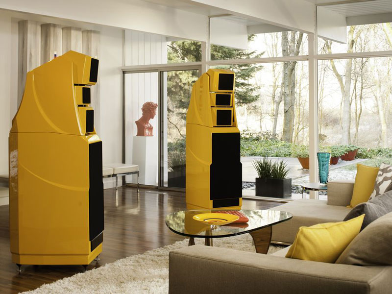

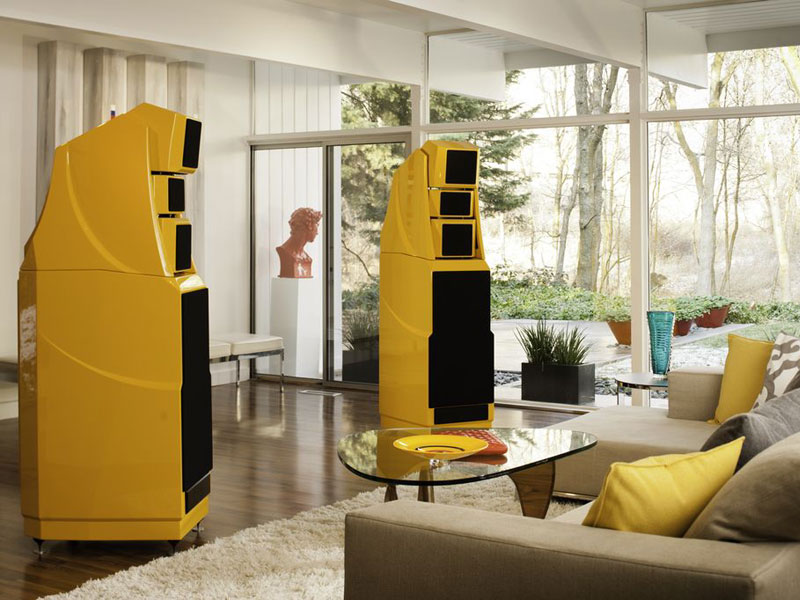

Is that from Battlestar Galactica? :eek:
Hang those babies on the ceiling! :D

Good catch. I didn't even notice the yellow pillows and yellow plate on the table. :D
I think they are quite understate, blending right in. Couple of days you wouldn't even notice them. :rolleyes:
