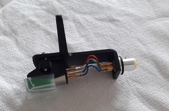

This is your cartridge and headshell? If so, the cartridge needs to be moved back, roughly to the middle of the slots for the screws. Many turntable mats from companies like Sony had a grid molded into the rubber, where it had a thicker long line intersecting with a thicker short line- this was where the stylus tip was to be located when the headshell was suspended over the centerline. If your mat doesn't have this, do you have a manual for the turntable? It has a group of 28 images on page 2- look at #27 for the distance from the shoulder of the headshell to the stylus.

Good eye! You're a winner! When you come to my town the lunch is on me!;);)
Not only that, but it is connected wrong. I was waiting to see will anyone notice.
Yes, it's all according to the manual. 52mm and all.
