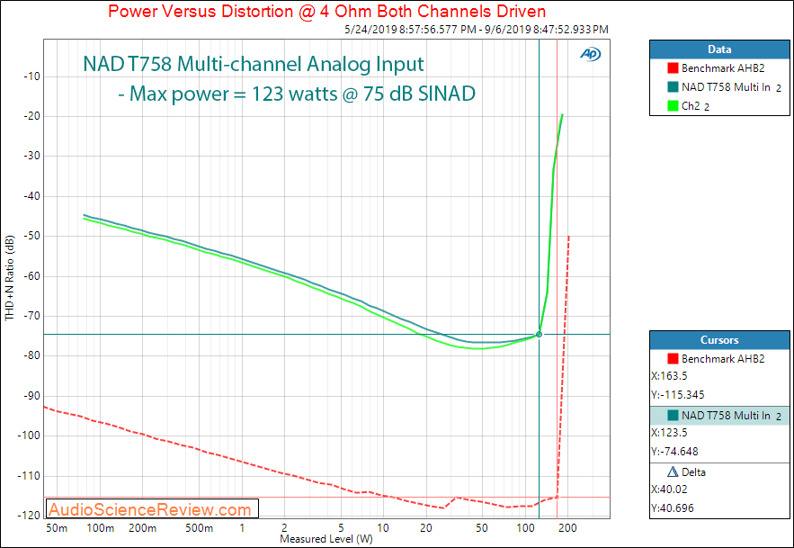

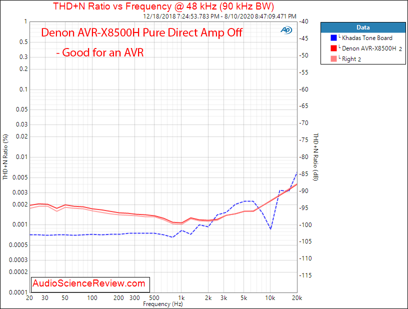

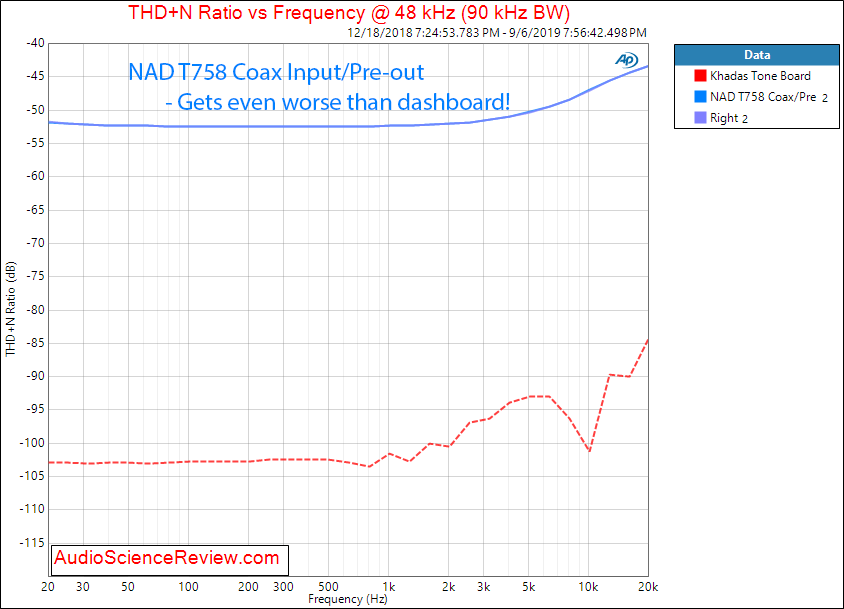

Below are two curves I can quickly pick out for comparison of the pre-out performance. I picked these two because you owned/own both so I can feel safer, though might still be attacked by some NAD AVR fans:D Also, I know neither one was affected by the harmonics and noised in the ultra sonic range.
So one can see that THD+N is not the same from 20 to 20 kHz.
Now look at the similar effects in the THD+N versus output level and you can see that at 123 W output the NAD was actually quite good with almost -75 dB THD, that is 0.0178%, but then at 1 W it already increased to 0.18%, well pass the 0.1% threshold that some experts suggested would be audible. At 0.25 W (my kind of listening level when watching movies at moderately loud level), THD would be at about -50 dB or 0.32%, even ADTG may hear it right? Compared to the Denon, even at the very low level of 0.05 W, THD was still at slightly below 0.03 %. Again, this is at 1 kHz, at 10 kHz you can expect THD to be significantly higher.

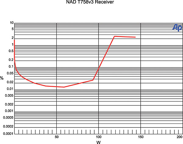

For reference, here's the S&V curve, they didn't always show it but iirc most of the time they did, but I am not sure if most readers would take a careful look at the below 1 W range. Even they did, they would have hard time because of the scale they chose.

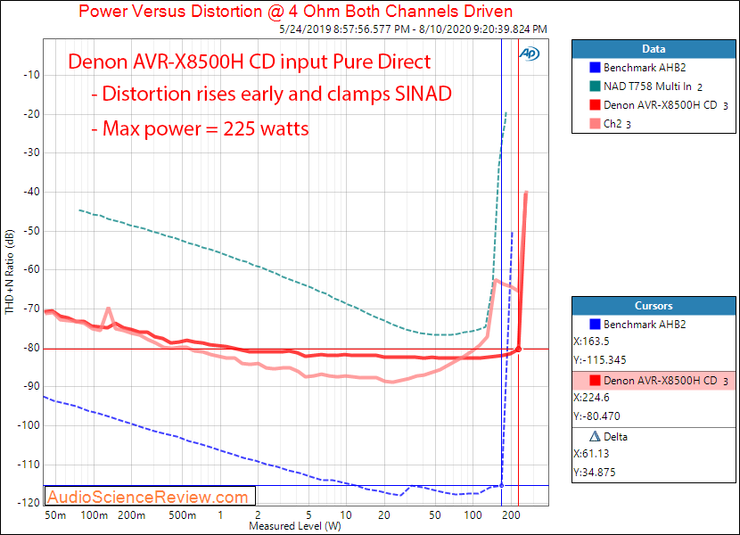

Thanks for your reply. I compared those 2 as well and noticed the vast difference of the 8500 and T758 and think it is a very important difference. Amir often leaves the T758 on many graphs as a reference (in a bad way). I too really get a kick out of subjective reviews as well on a very poor performing piece of hardware that has Dirac. I’m looking forward to the review of the T778 to see if NAD has made some improvements. Thanks again for your post.
