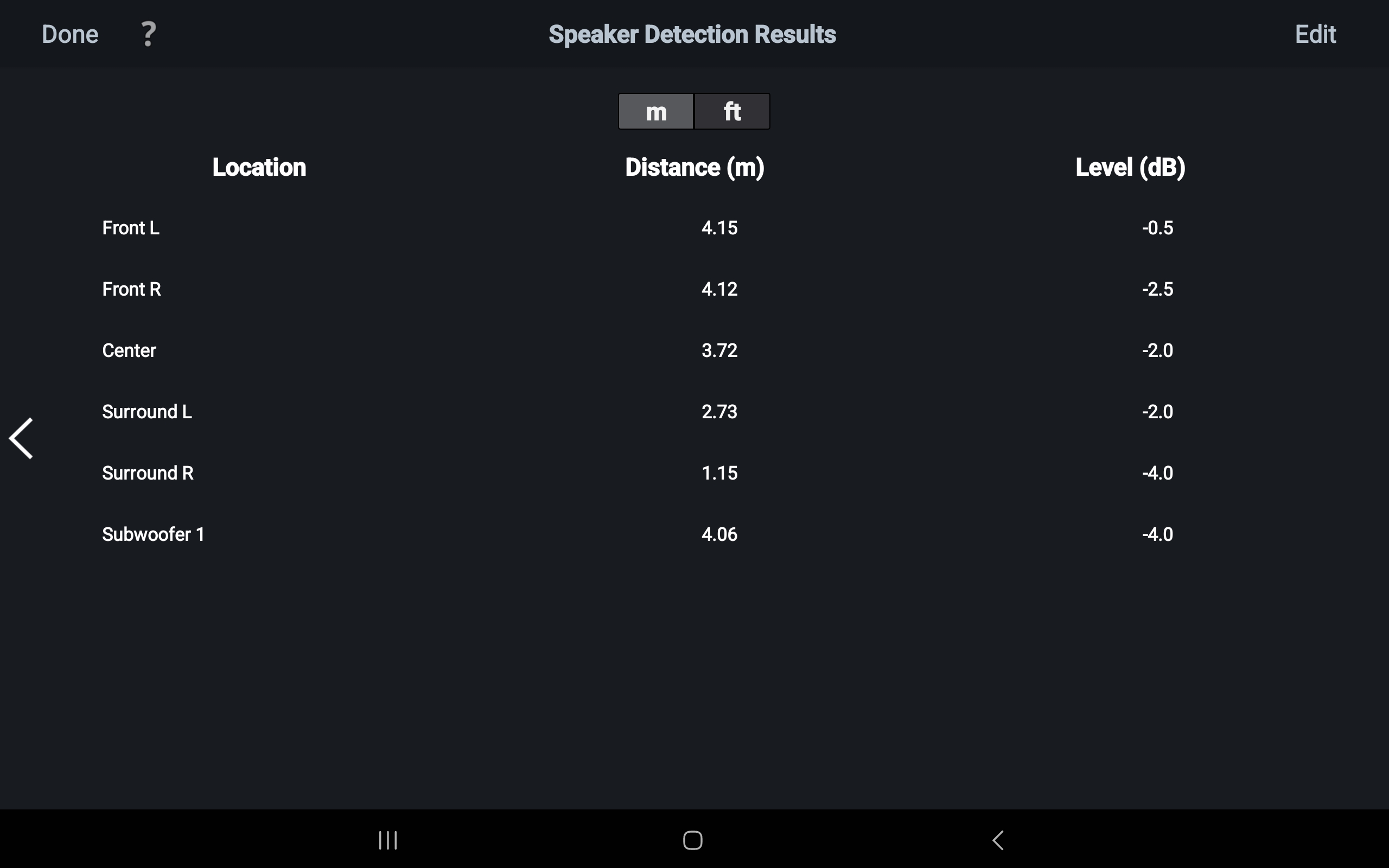

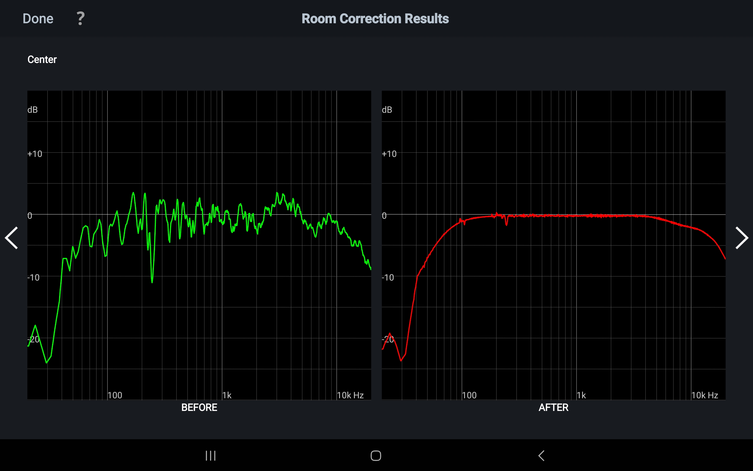

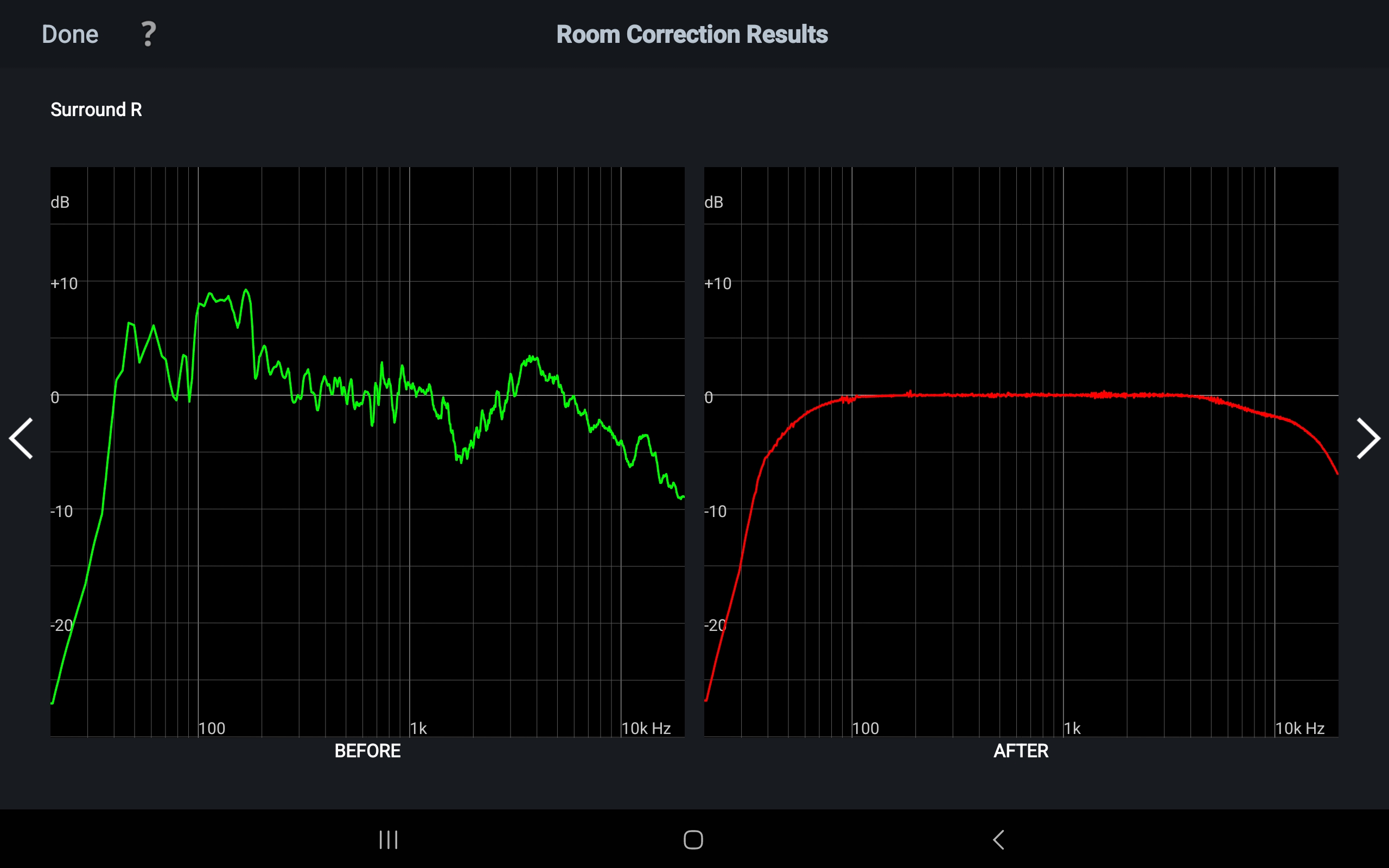

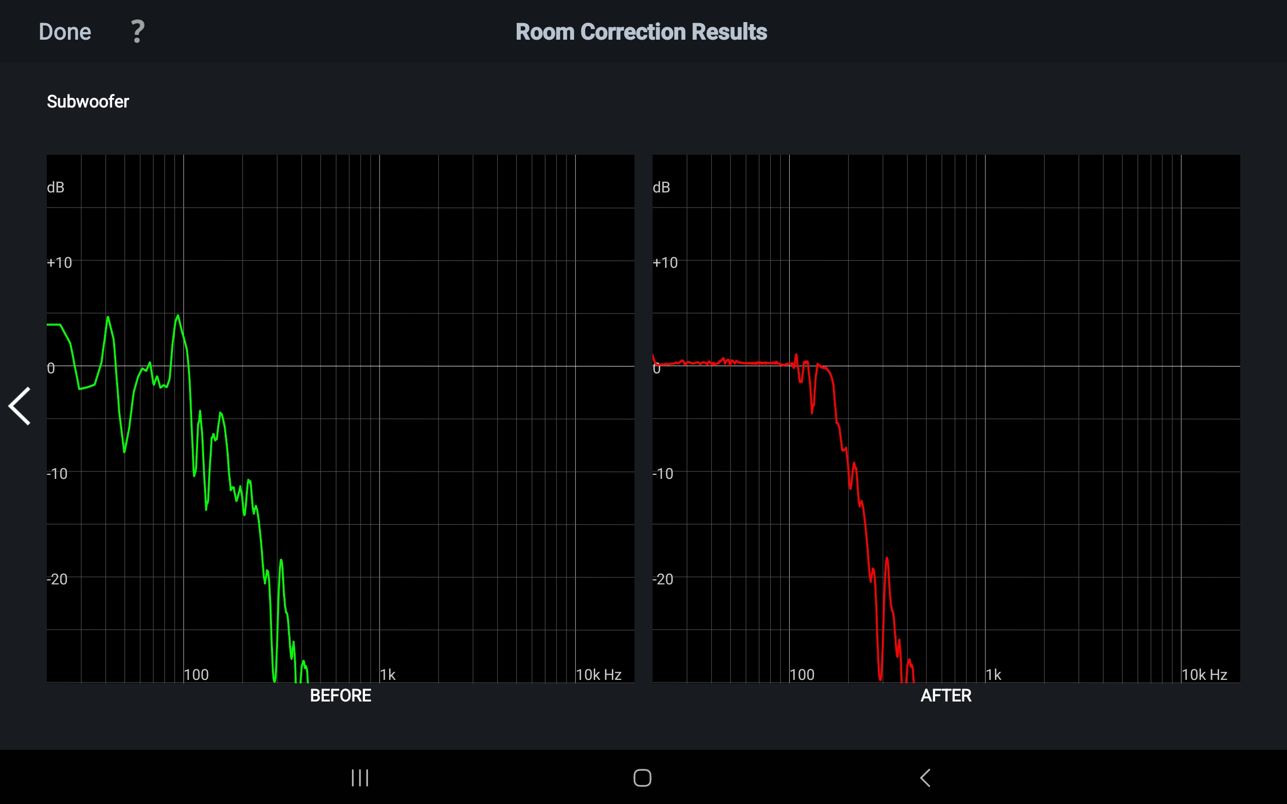

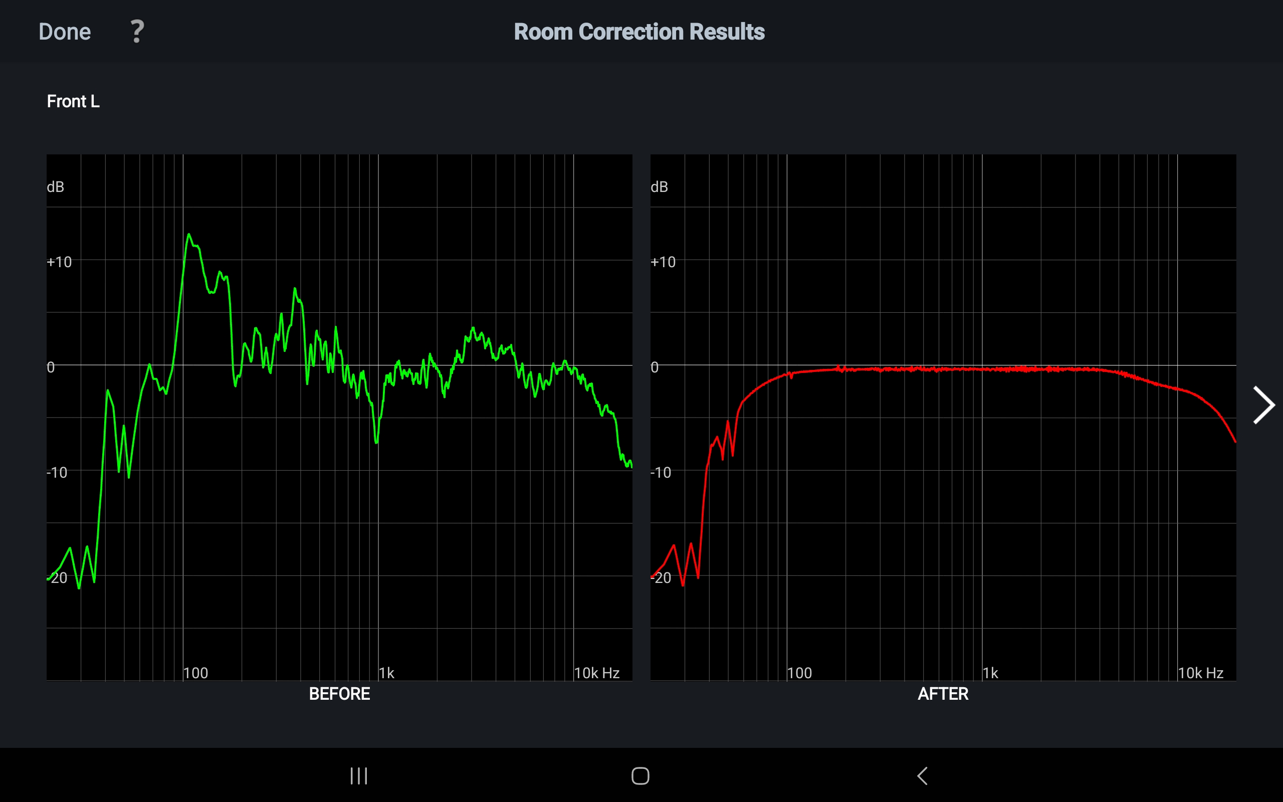

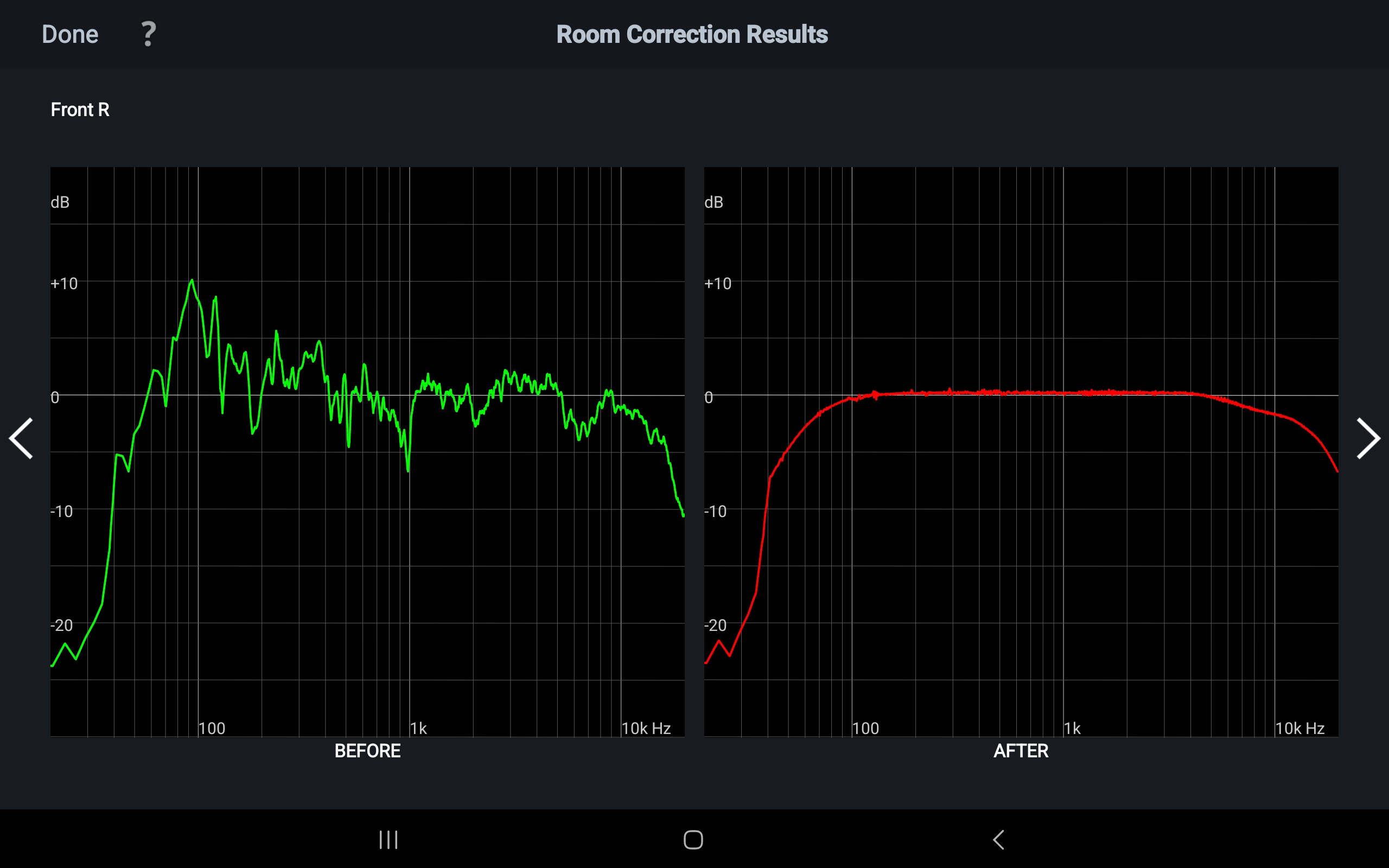

Hello,

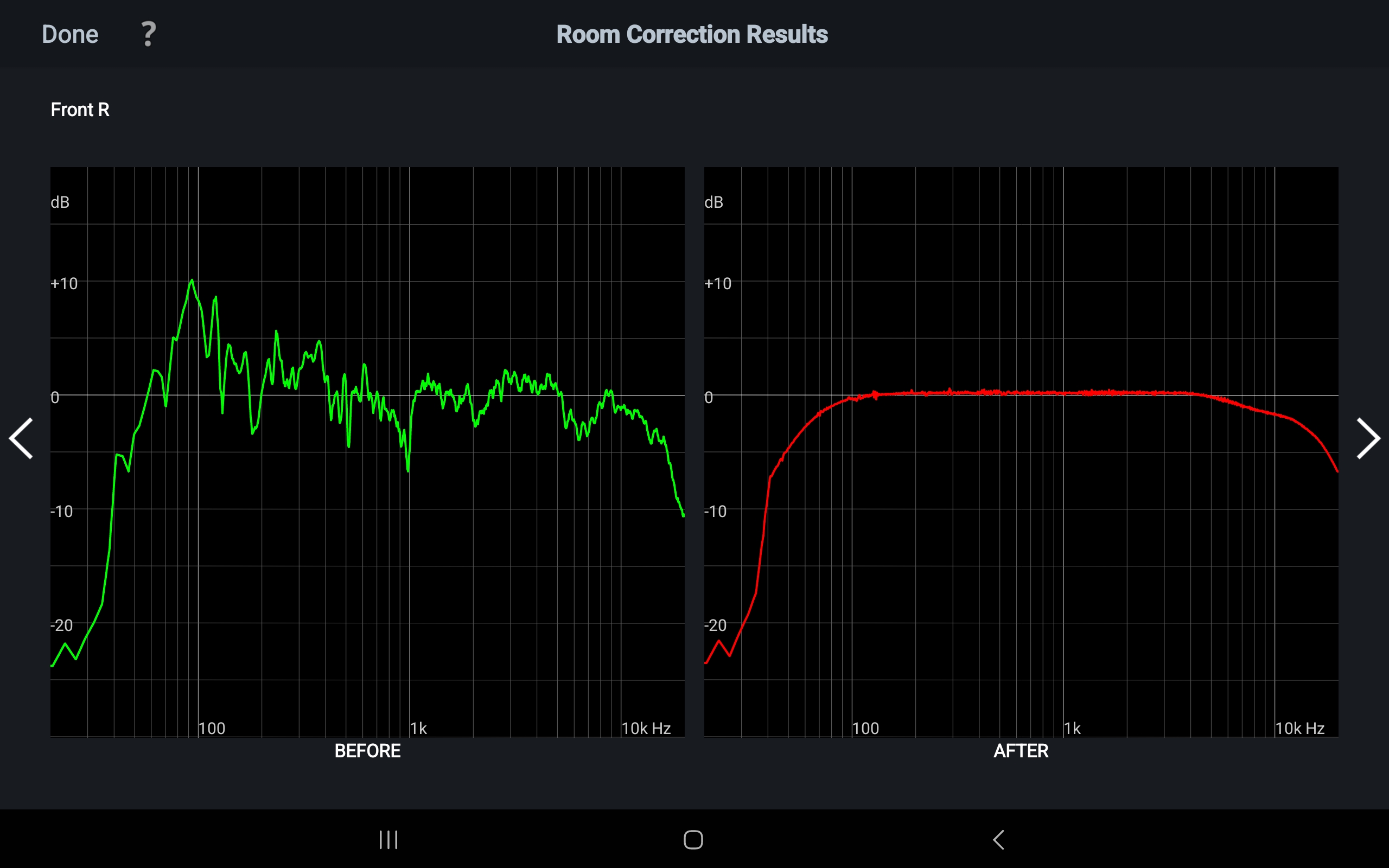

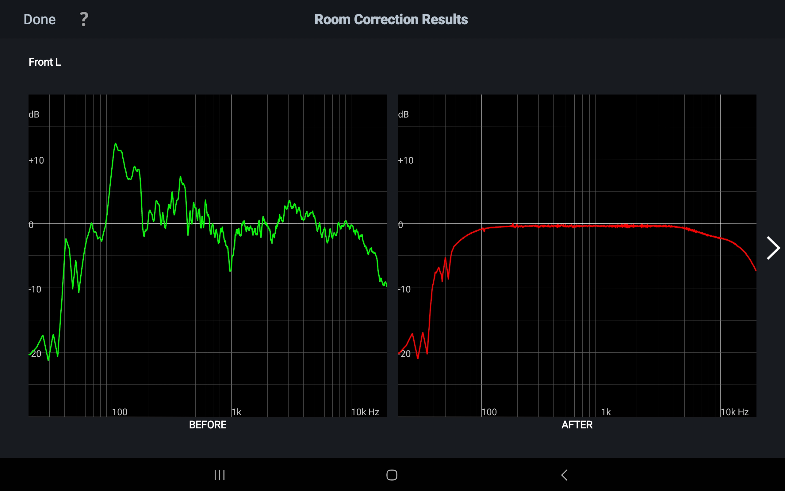

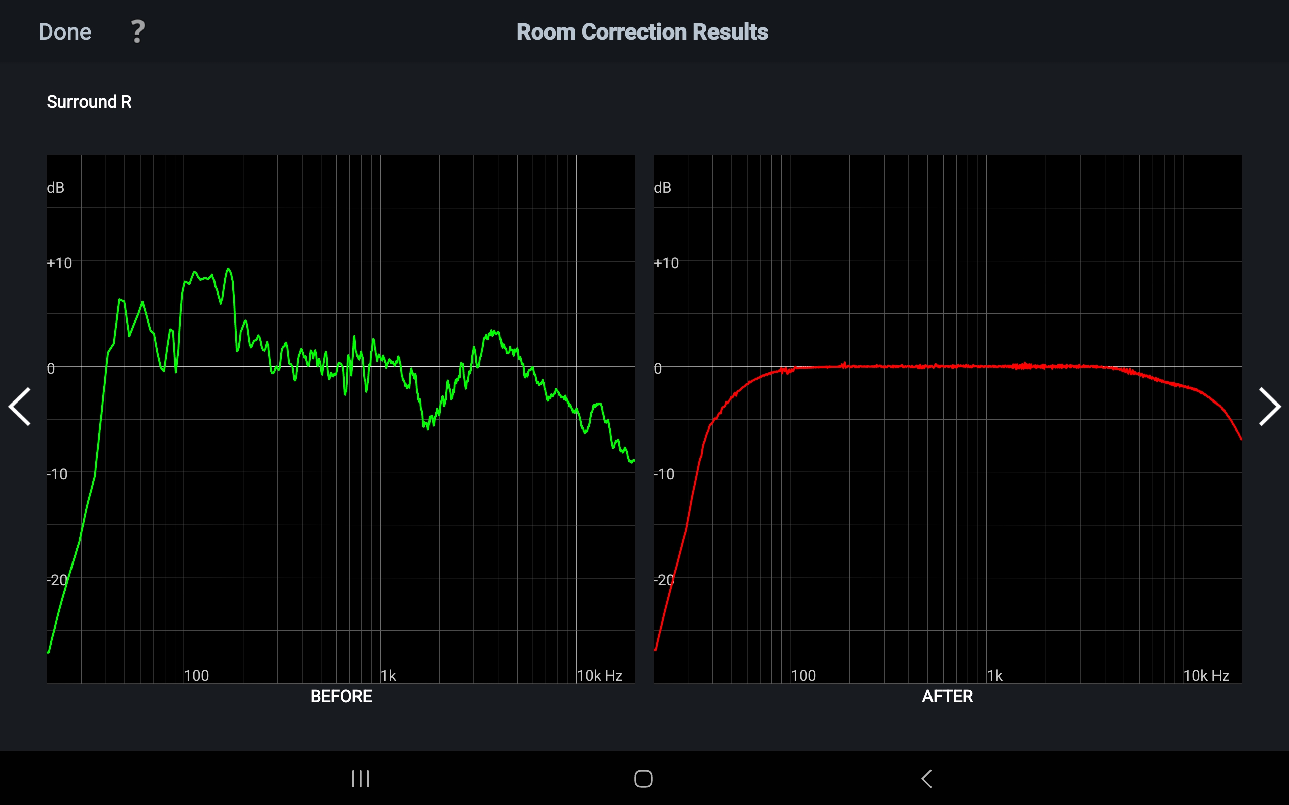

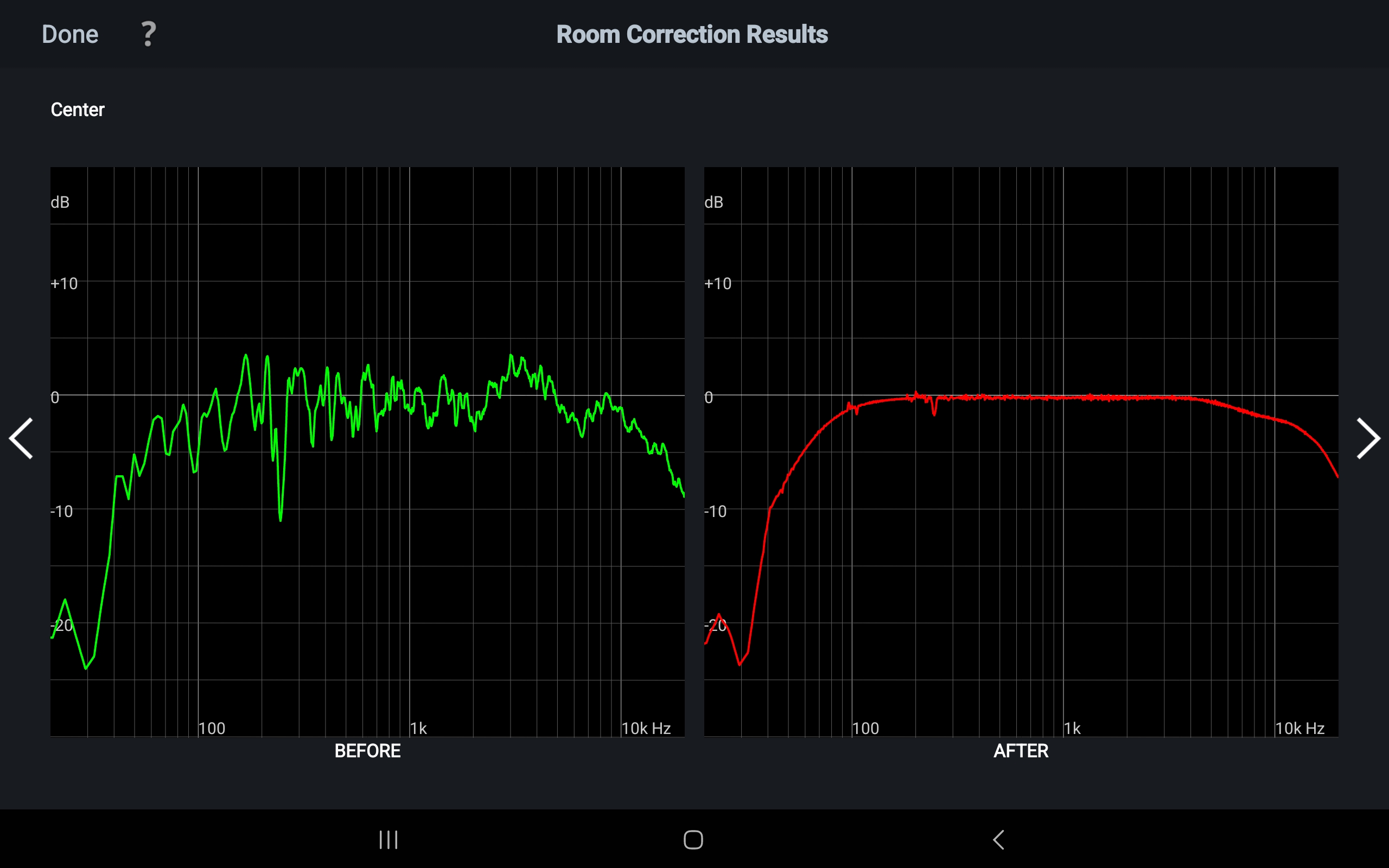

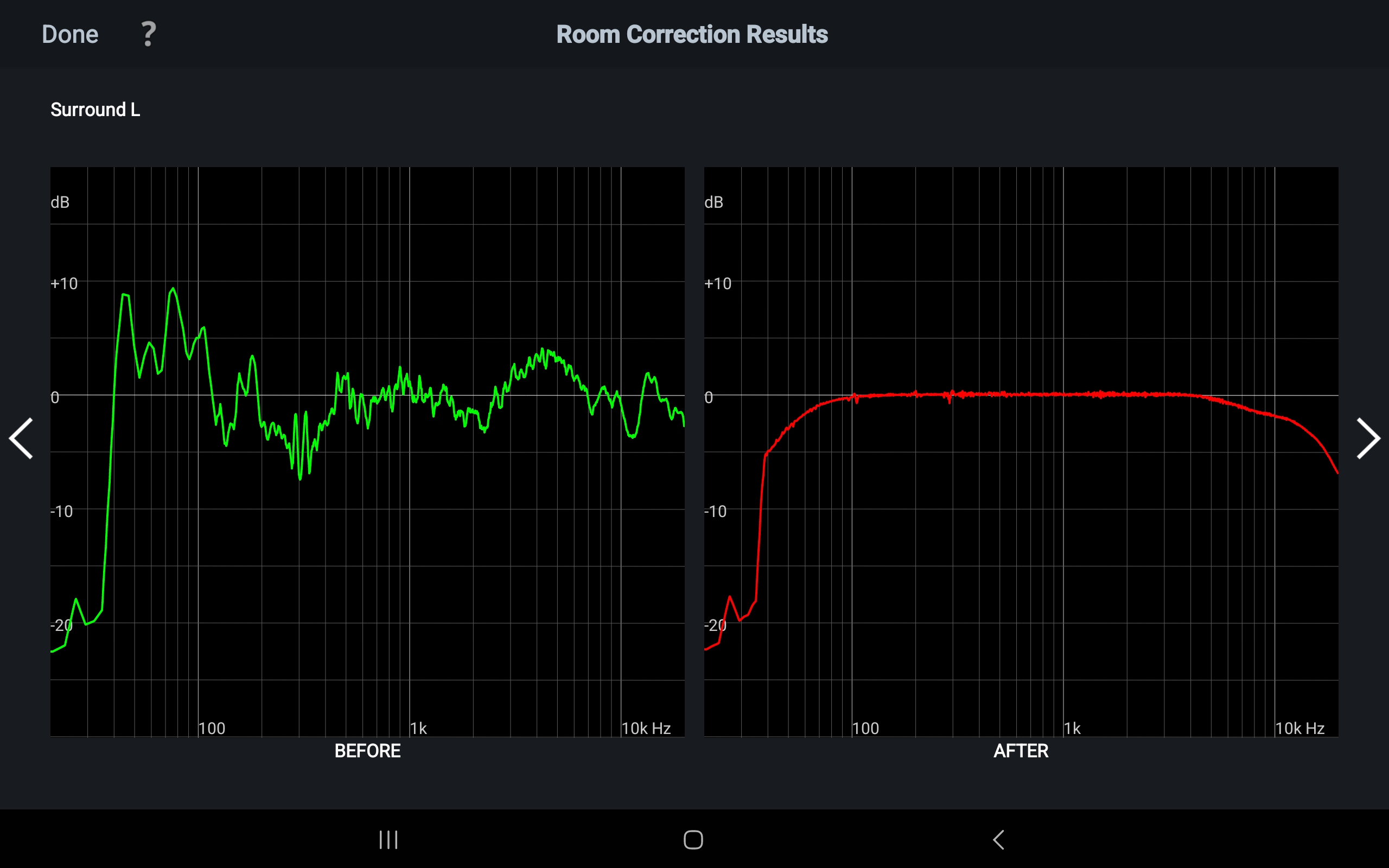

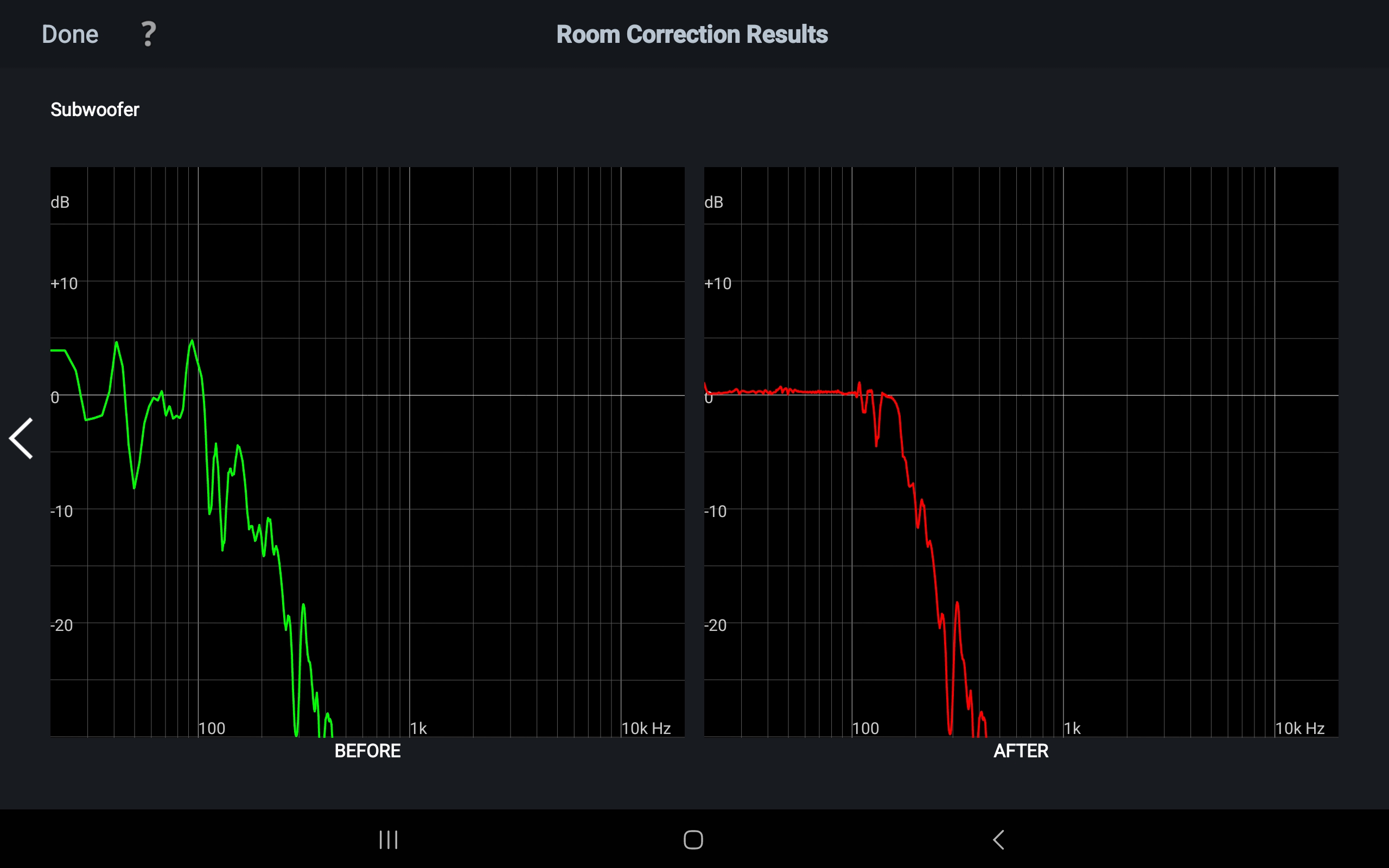

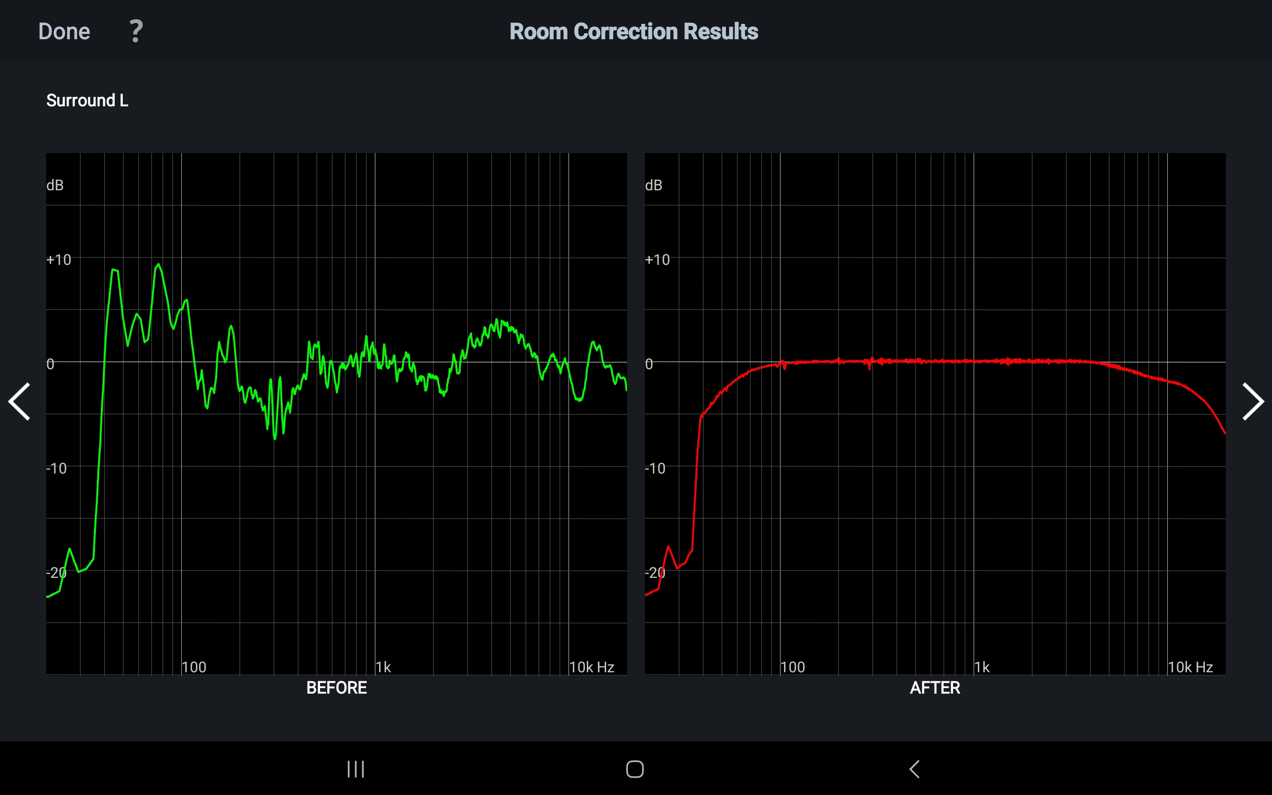

New member and reading about Audessy and room correction, but to be honest i still don, t seem to understand everything. So this is my first post, and hope some of you would take a look at my Multieq app graphs and can tell me if everything look out of the ordinary.
My receiver , Marantz sr7012
Front left center , Arendal 1961 monitors
Surround speakers Eltax monitor 3
Subwoofer, Klipsch SR-115W
The only thing i changed are the crossover settings to 100hz as advised by Arendal sounds
And bumped the subwoofer level to -1db
And disabeled midrange compensation
Everything sounds good to my ears, but maybe someone sees these graphs and see that there needs to improve something.
Thanks.

Graphs look good, though they are not actual results, but predicted ones only.
If they sound good to you now, leave them alone and enjoy your system.
